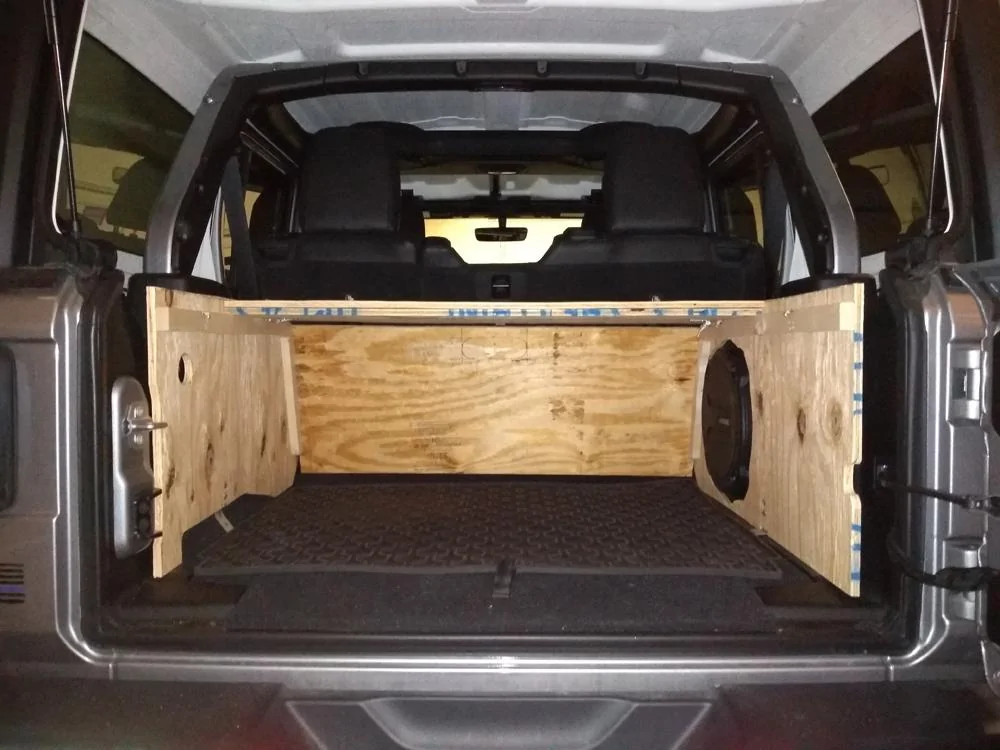

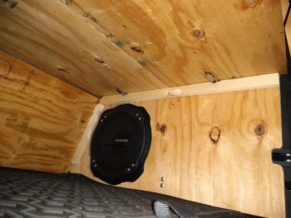

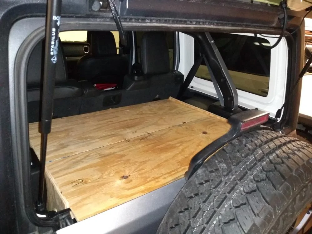

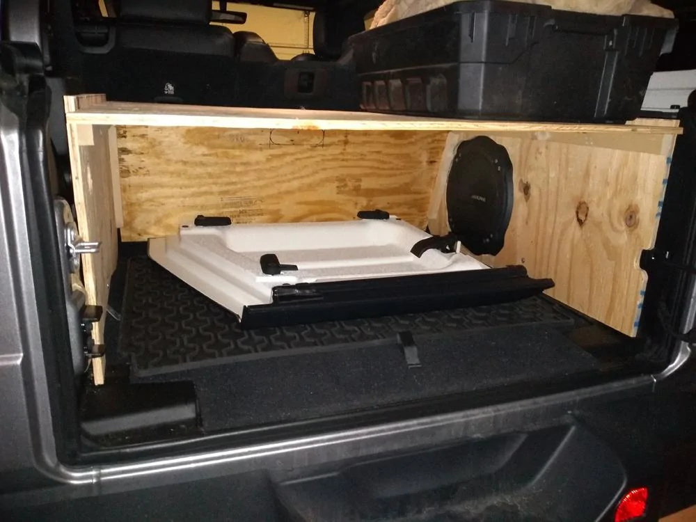

On a related note. I decided to go the custom enclosure route. It's still rough, but I want to make any adjustments before finishing it. To do that, I need to drive around with it a bit to see if there are any changes I want to make. One that I've come up with so far is that I'm changing the front wall so it hinges down rather than sliding out.
Currently I have the front wall in a track. The top panels lock in over it, so it can't be slid out when the top is on. I think I'm going to take the front of the track off, and devise some sort of hinge. that way I can fold it on top of the seats rather than having to take it out. This seems a bit quicker to use than the track (although it is pretty secure that way). Although the track method allows me to remove it and only lower 1 seat at a time instead of having to fold both down. Hmmm, I may have to split it like the seat and do dual hinged front panels.
The top is 2 pieces so I can remove the front or rear half for taller objects. They are latched in place with some nice simple toggle latches. Very quick and easy to lock/unlock the top panels. The rear panel is contoured to follow the curve of the tailgate, fitting into the recess, so no gap at the back. I'll likely add some angle stock to the bottom to add rigidity so I can put more weight on them.
The side panels are held in place by brackets that are similar to how Tuffy did it. I made mine to fit under the bolt so they can be used with the TrailRail or d-rings. Otherwise it's the same idea. I've got the sides set slightly above the top to create a lip around the "shelf" so nothing falls off if I set anything up there. Plus it will give me a good place to attach some D-rings if I decide to add them.
Anyway, I made it so the front panel angles with the seat, rather than dropping straight down like the Tuffy enclosure. This gives me full use of the cargo area, so my panels still fit. Yea!!
Here's a few photos of how it looks so far. I'm either going to upholster it with carpet, marine vinyl, or coat it with bedliner. I haven't decided yet, but I want to test it and make any adjustments first before finishing it. I guess that gives me some time to decide how I want it finished. So far I've got about $40 into it. A far cry from the commercially available enclosures. Depending on how well this works out, I may make a PVC version so I don't have to worry about distortion or water damage. That costs a bit more, so plywood works well for R&D.
