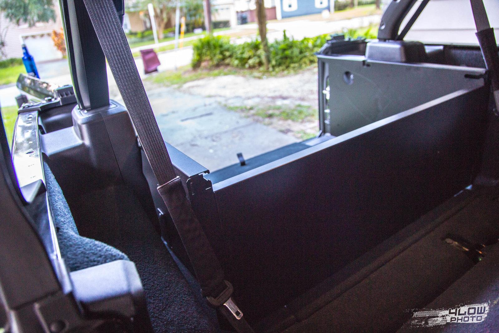

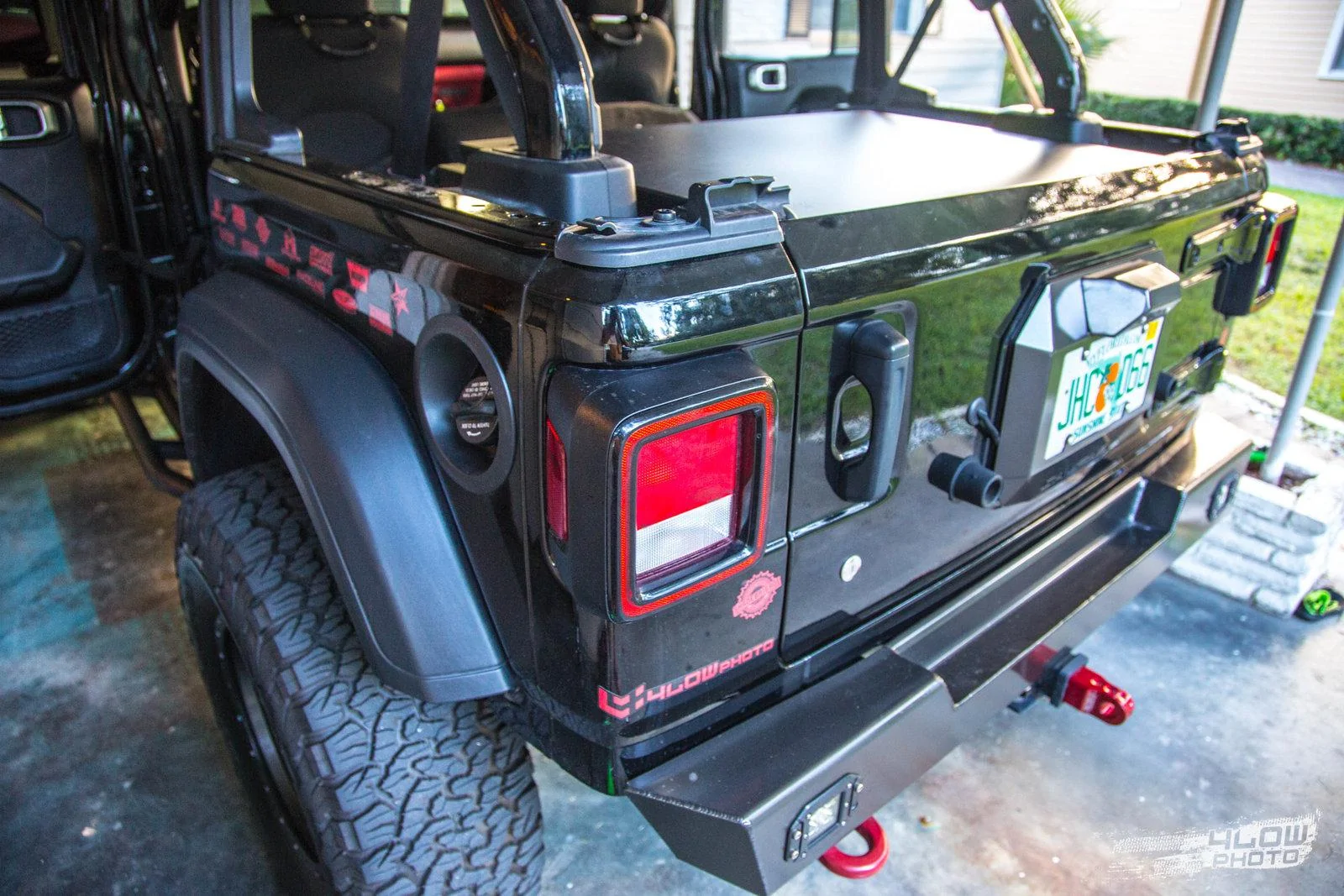

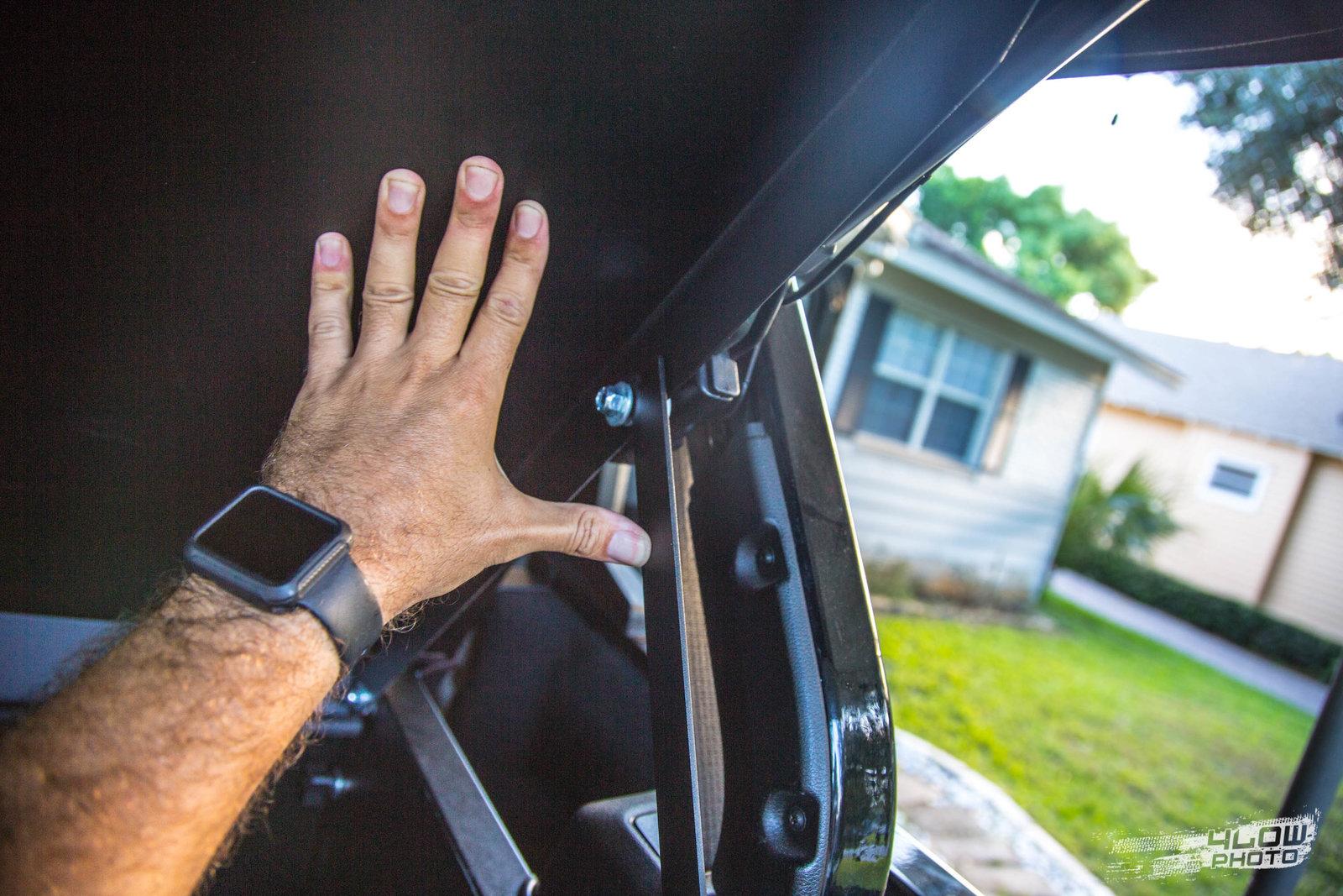

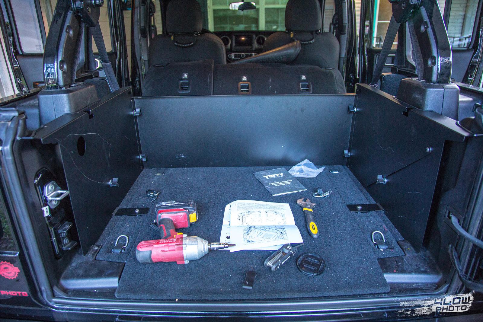

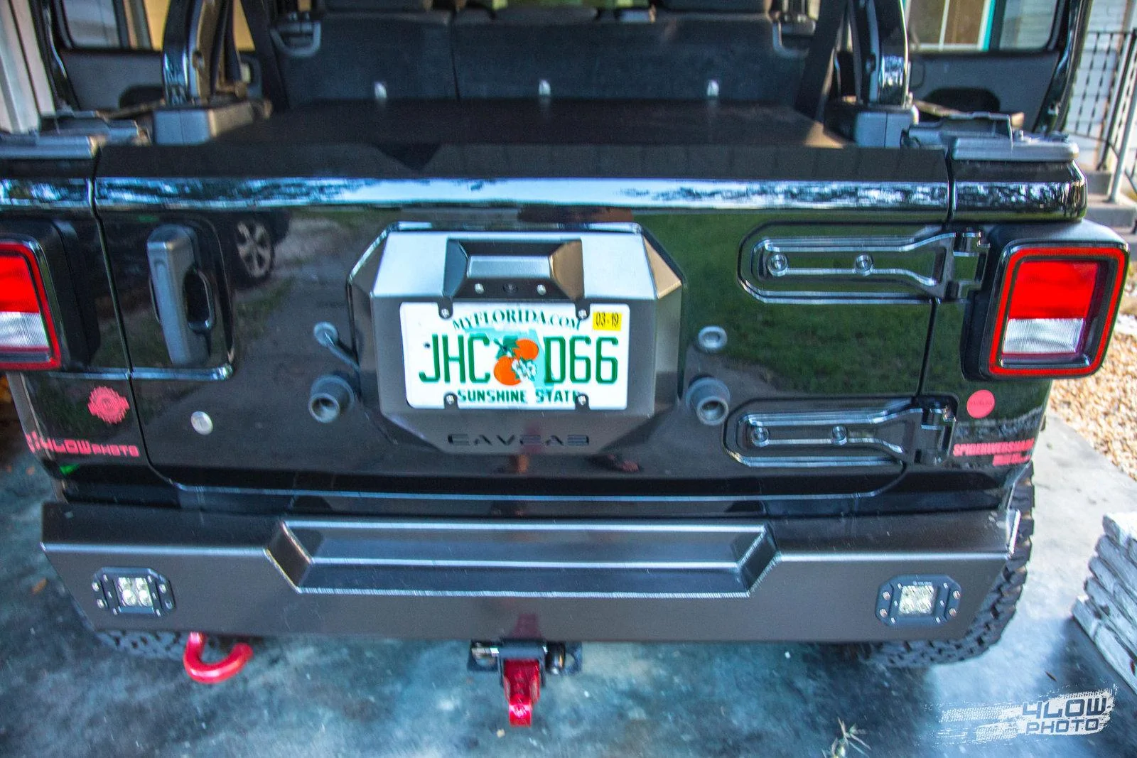

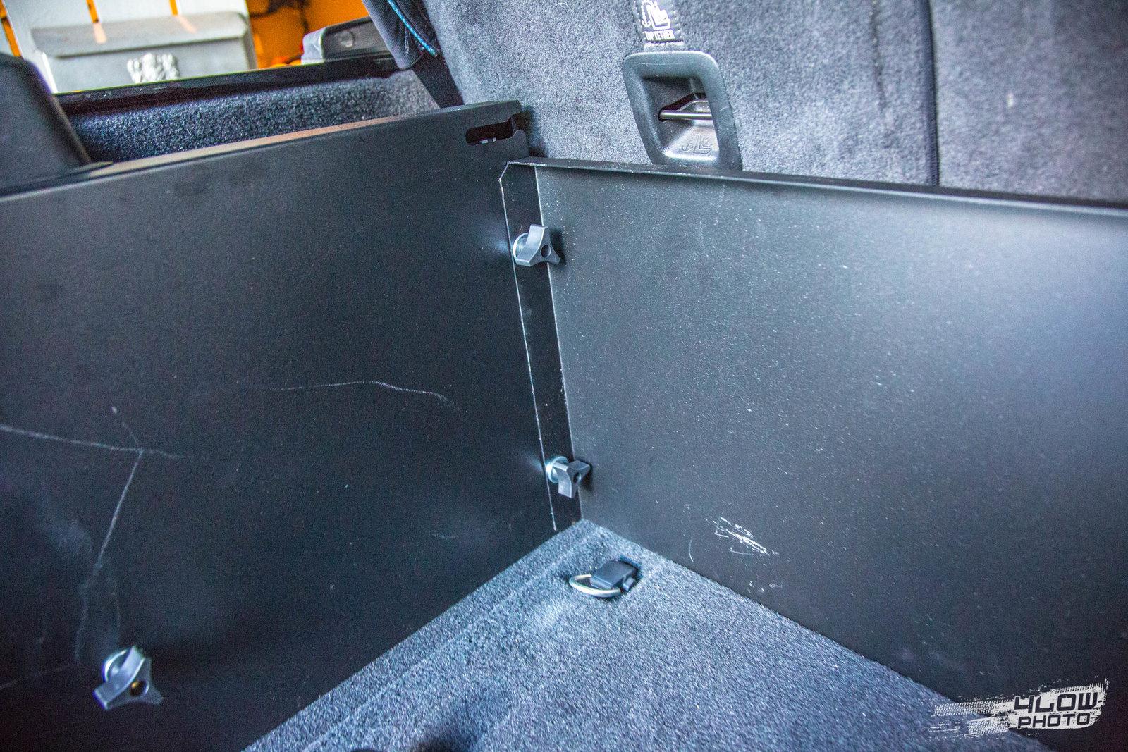

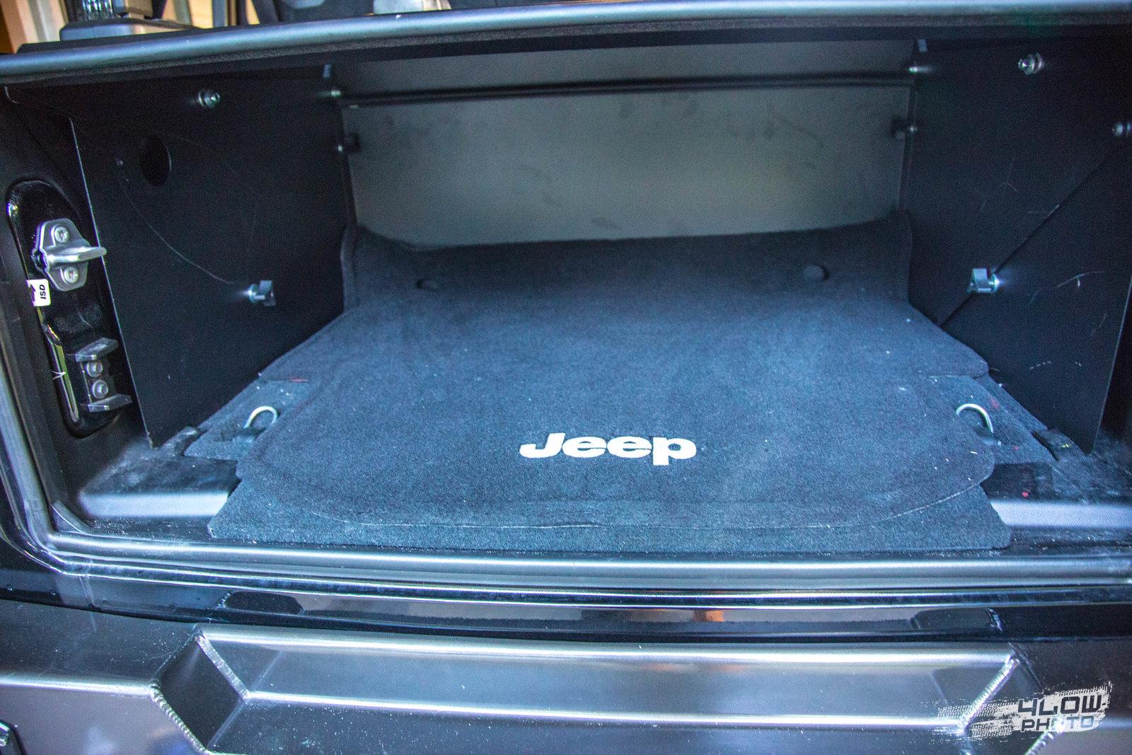

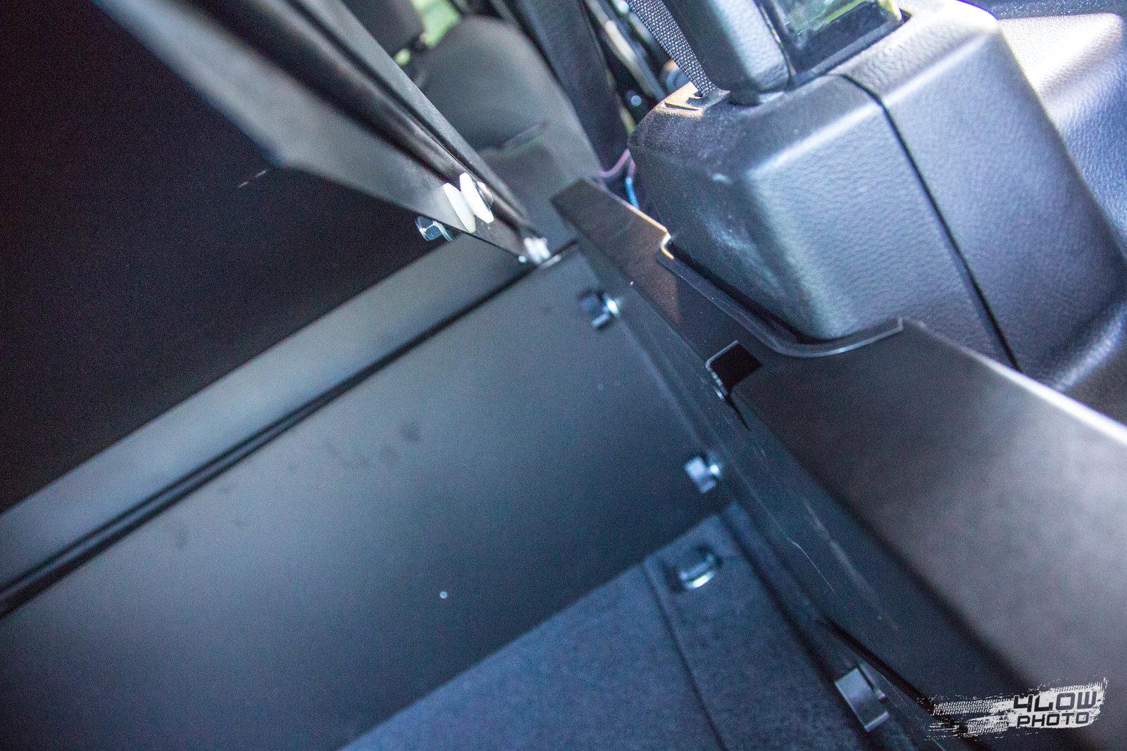

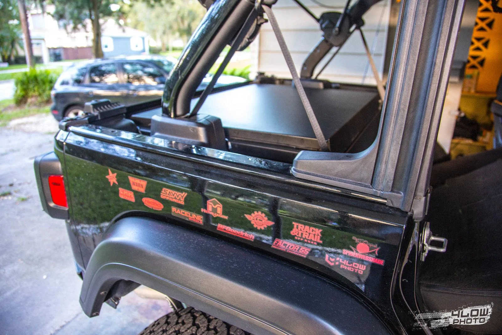

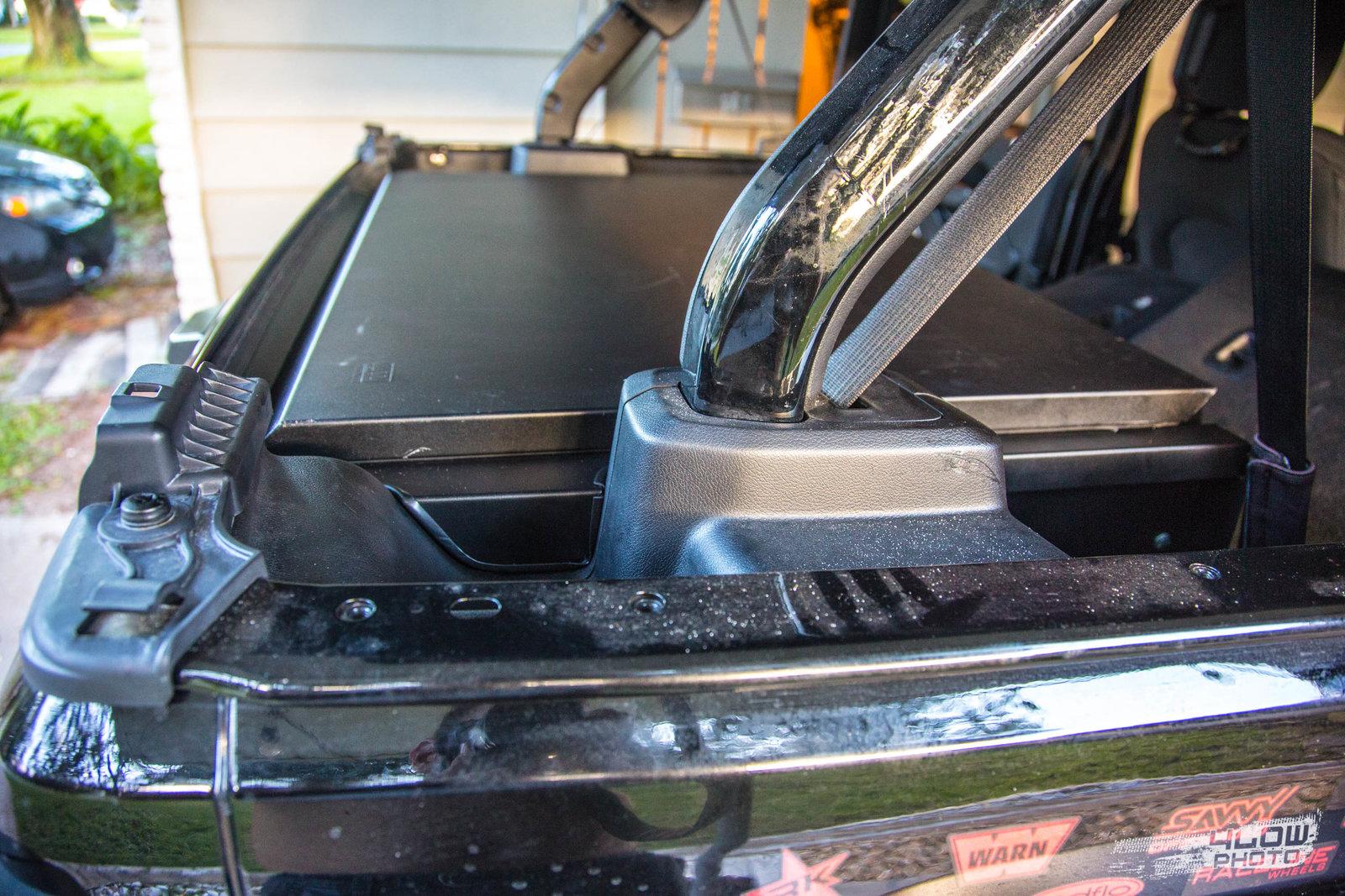

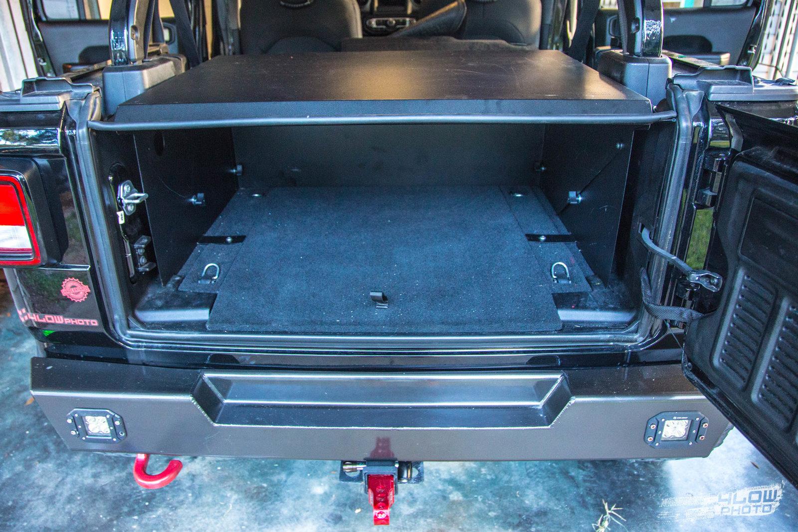

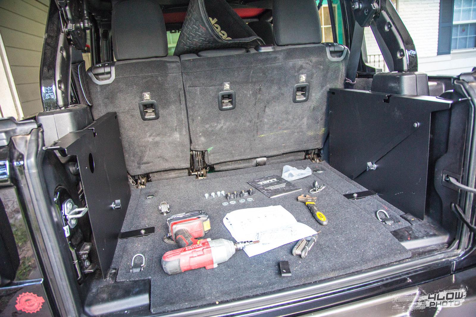

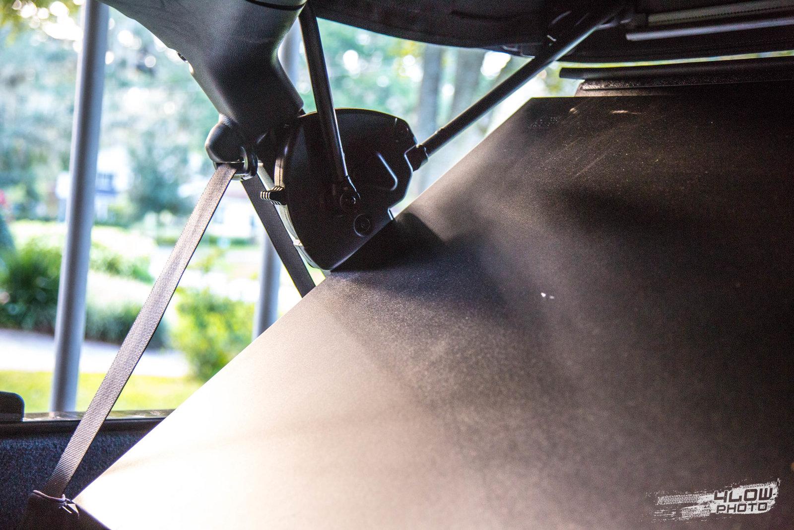

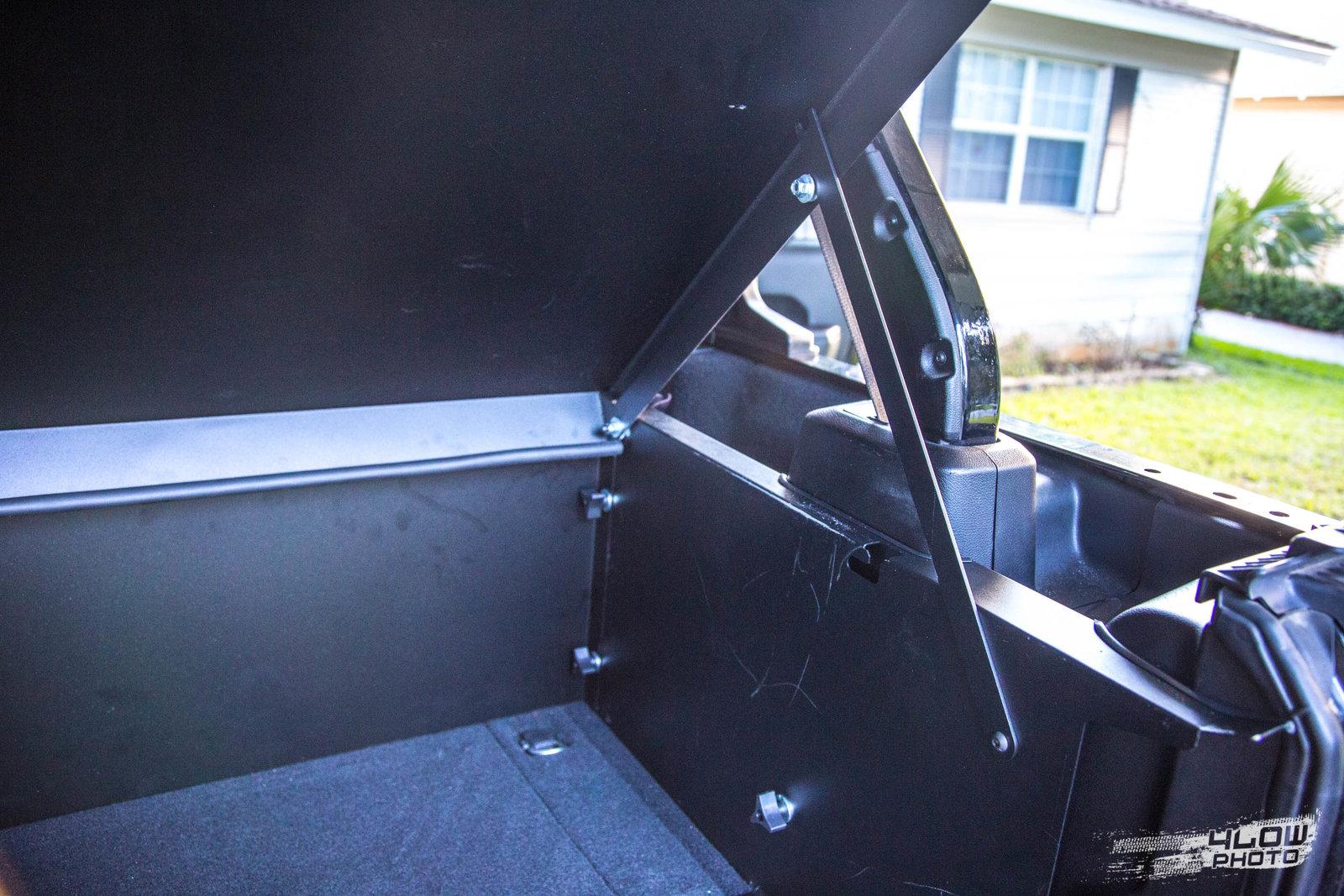

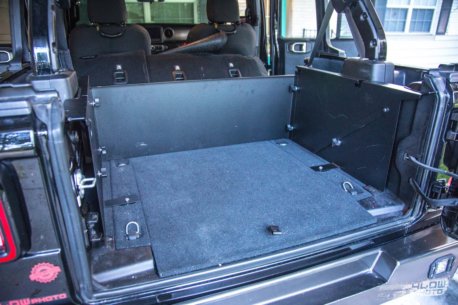

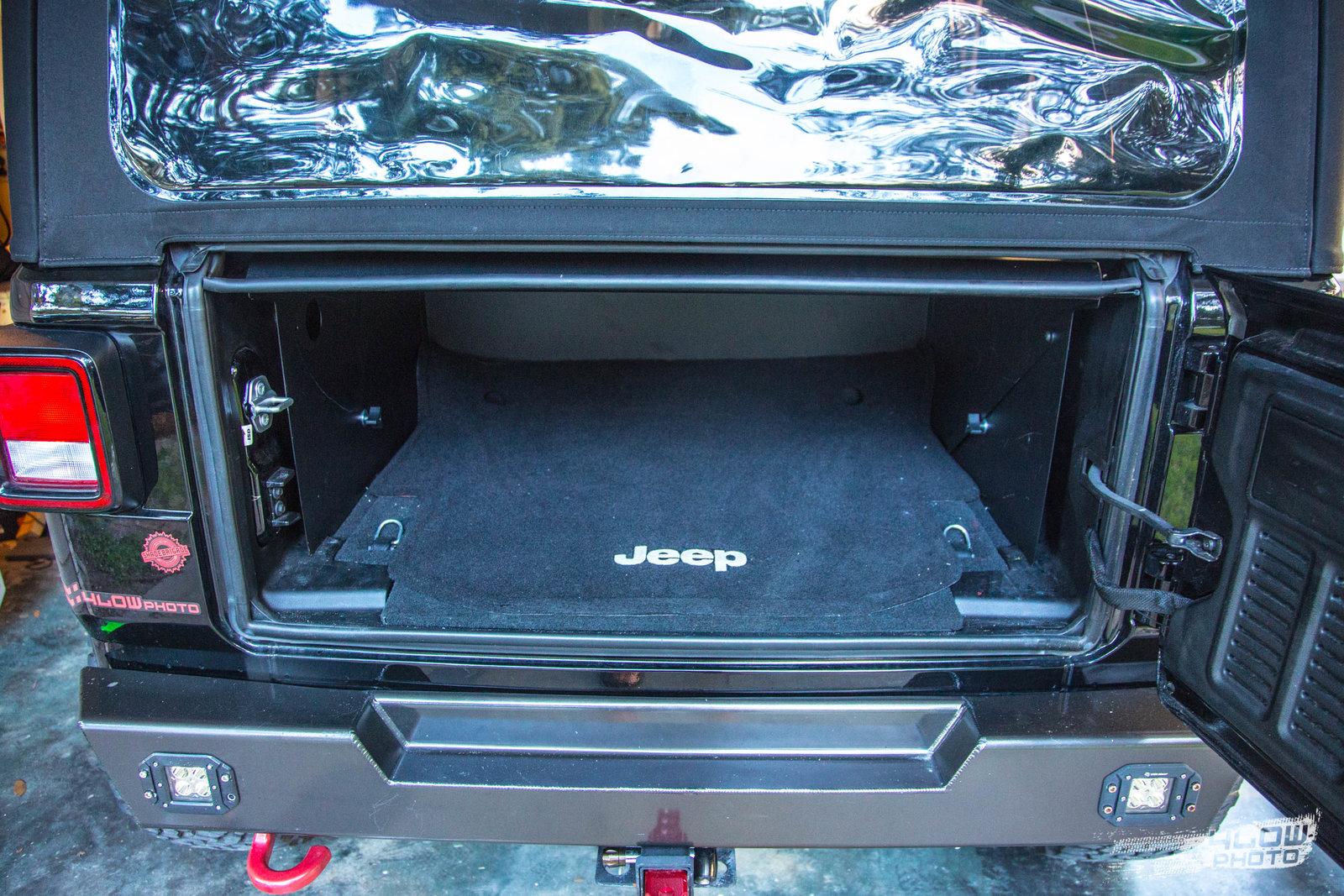

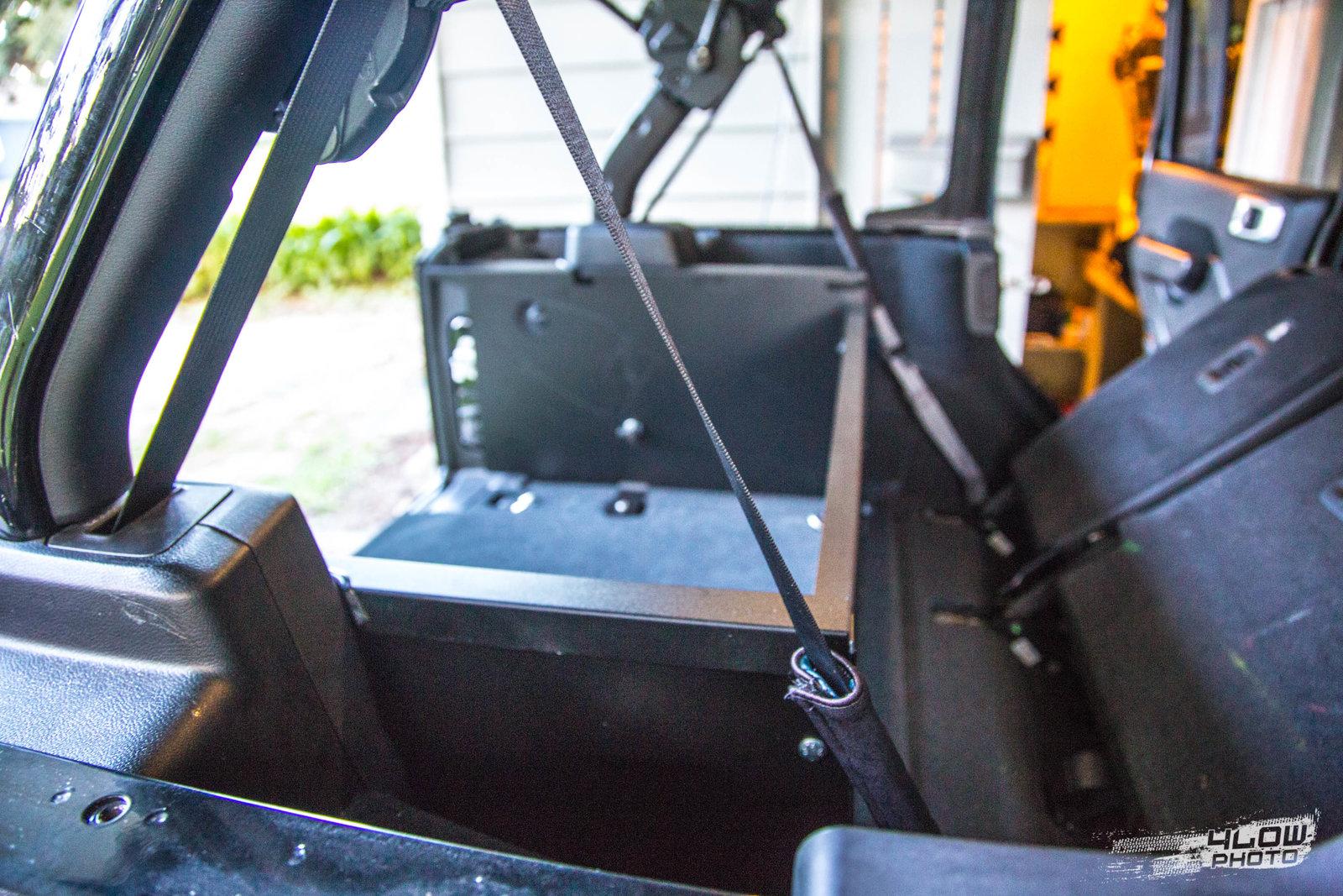

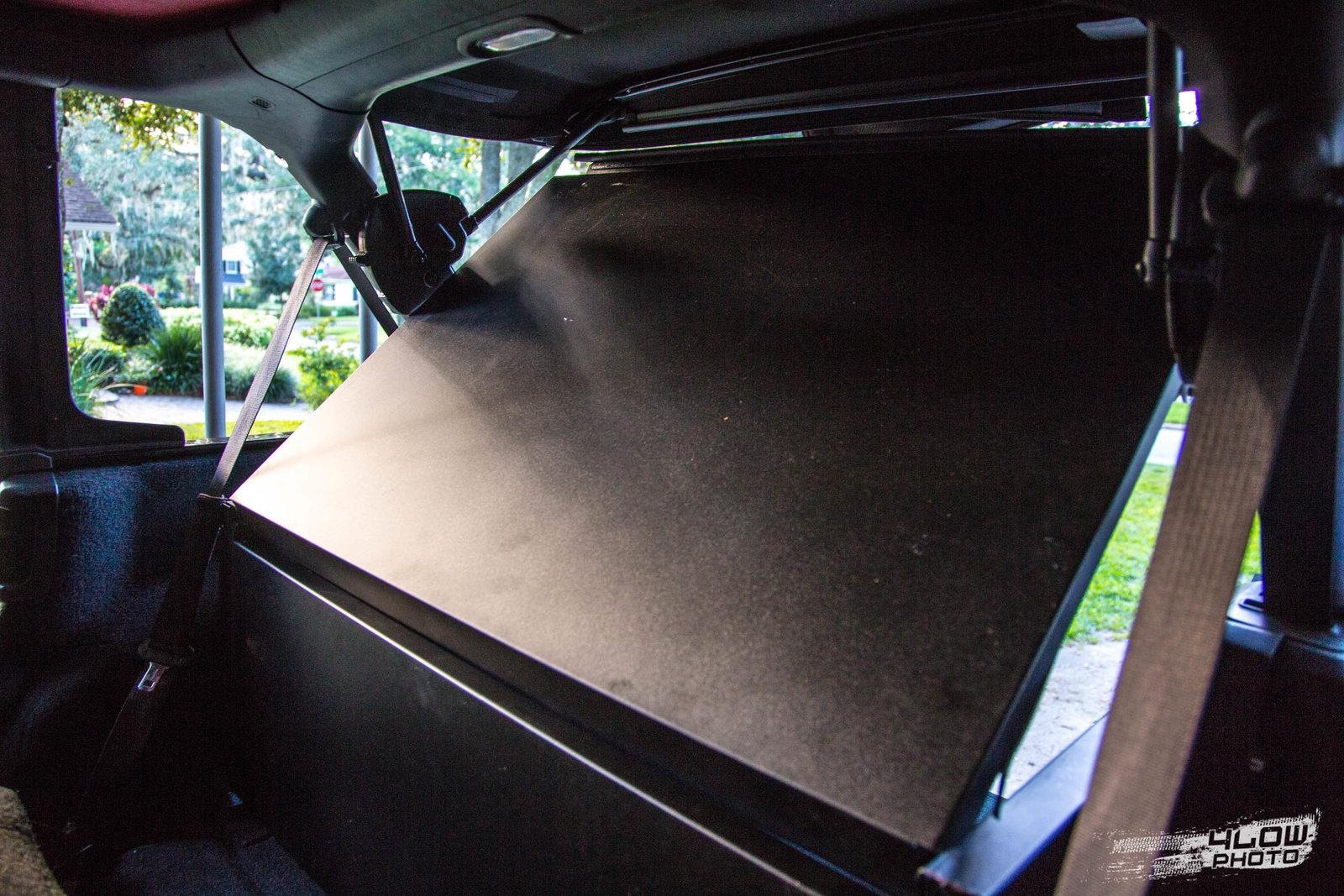

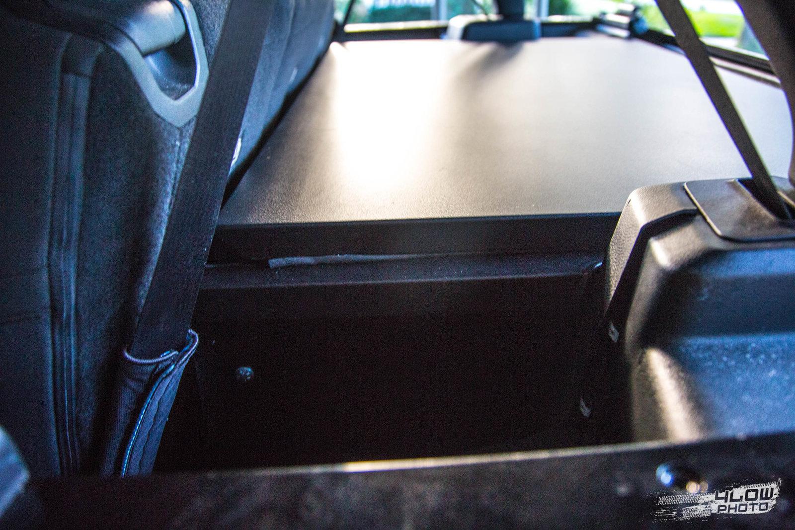

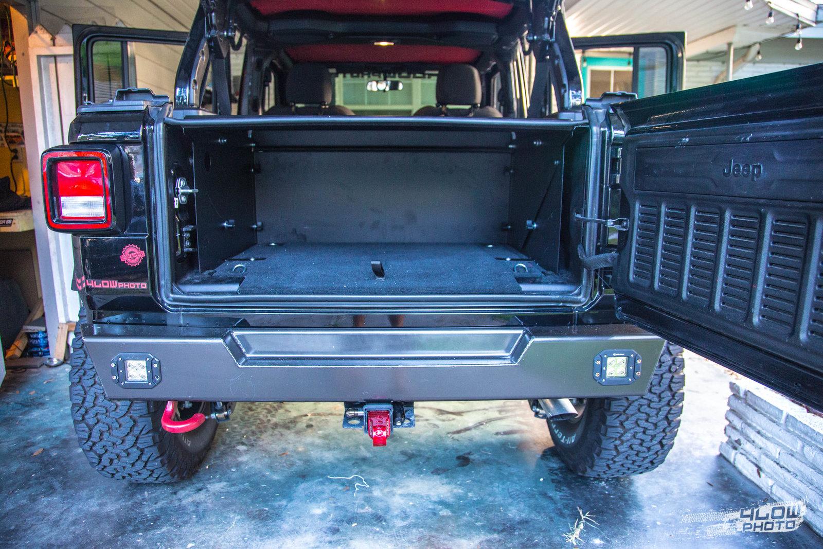

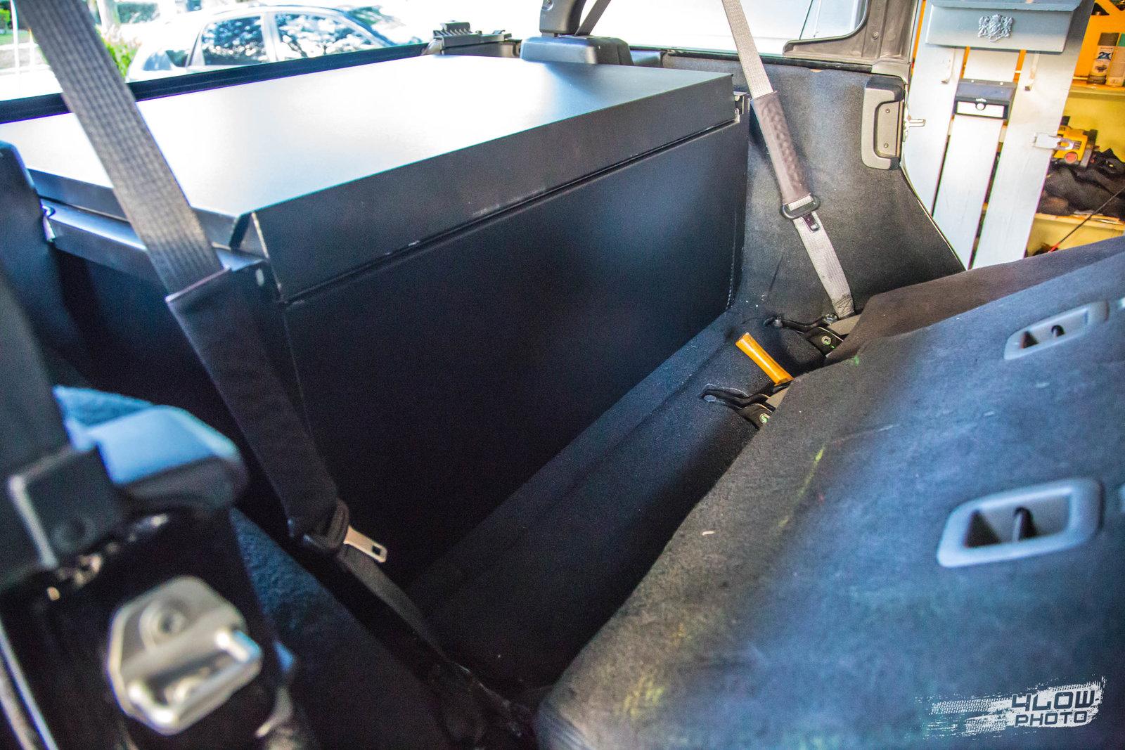

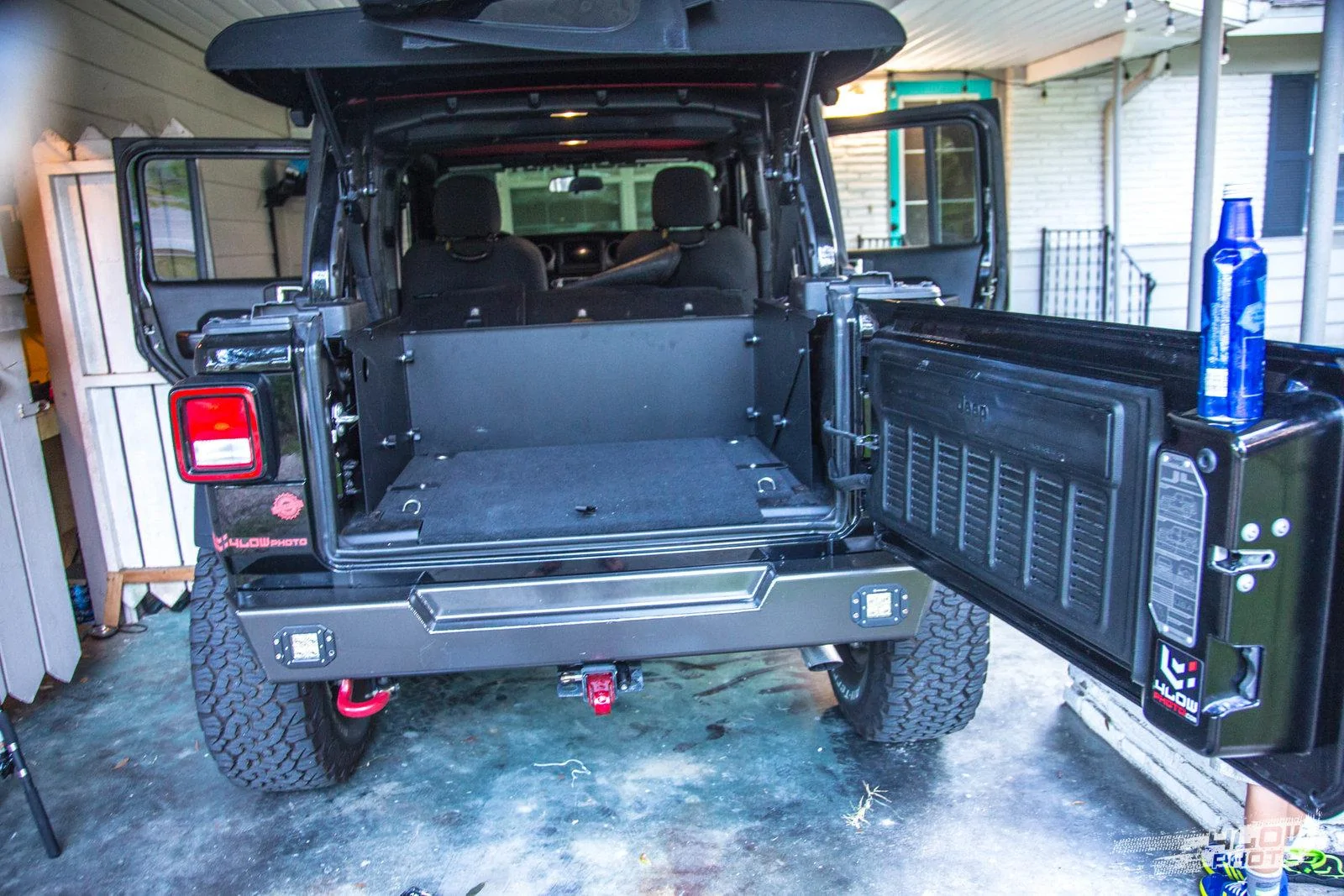

So I got this installed this weekend. Liking it over all for what I need it for. My only concerns are the rattle noise and the powder coat finish, they did reply to me looking into the PC.
powedecoat sucks, but Price wise im happy. could use 2 more brackets IMO to tighten it all up. shift around when opening lid

Thought the same thing! I ordered an extra set of brackets from Tuffy, drilled an extra hole, and bolted to the front tie-down points so there are now 2 brackets each side (four total) - much more secure and tight.
Yes. The top locks when folded back. When I first installed the soft top, it was a bear to unlock the first time, but no problems since. With all of the emergency equipment I carry, just the tailgate box was not an option.
Same here. Had to lean on top of soft top to get it to lock down. Been getting easier each time since.
