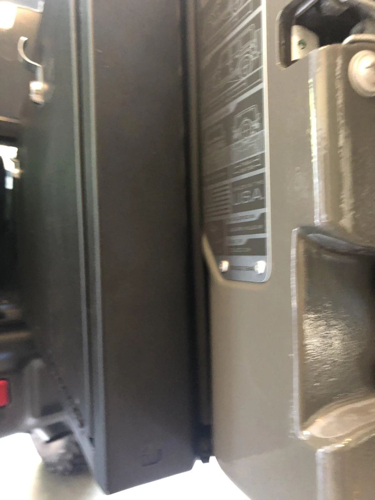

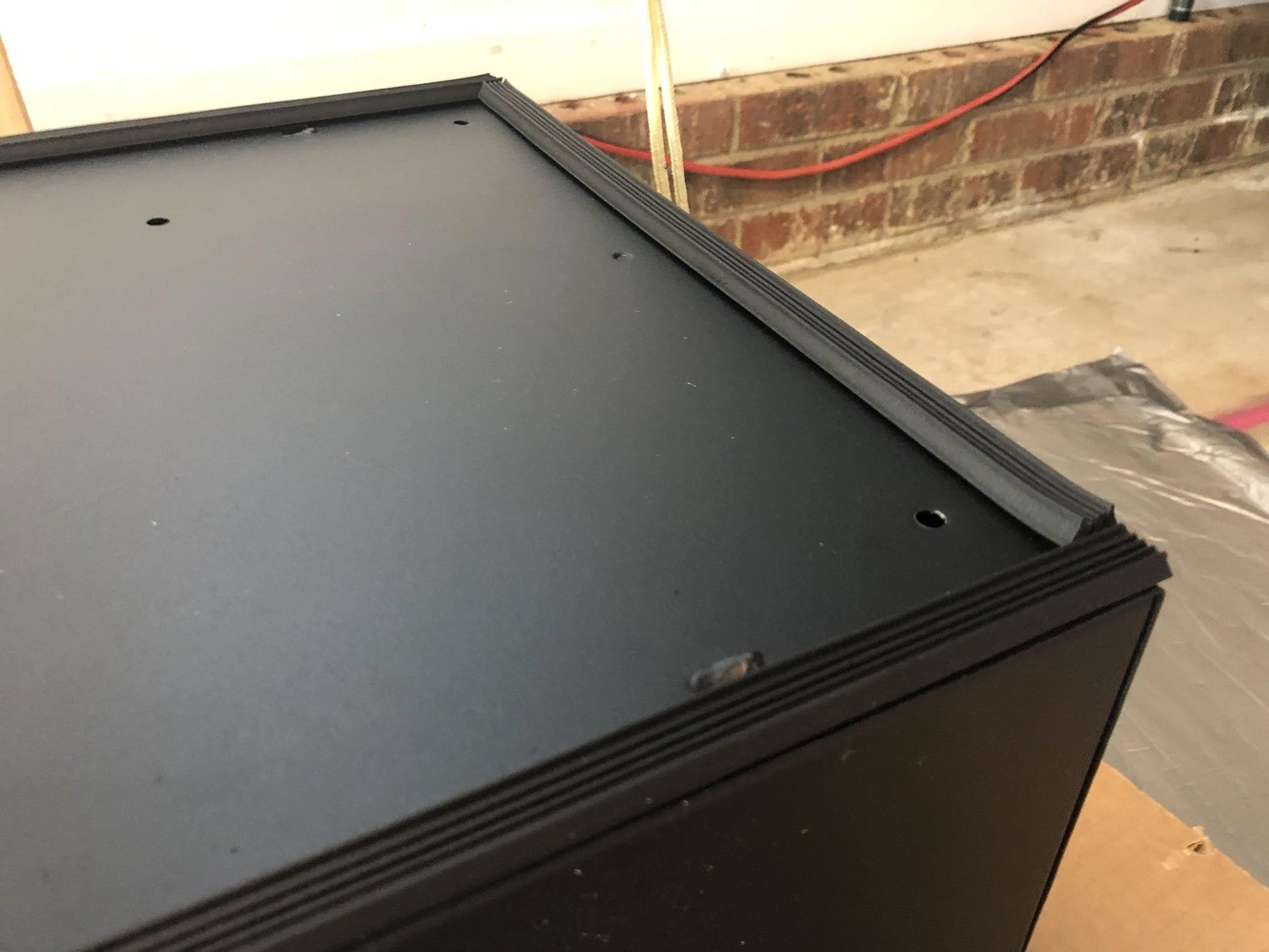

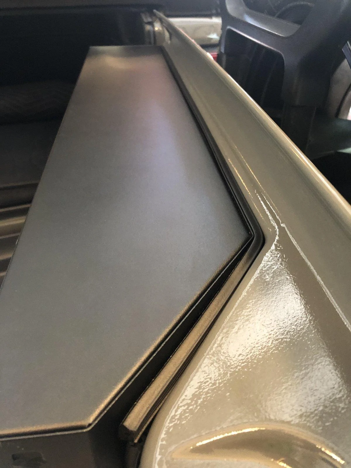

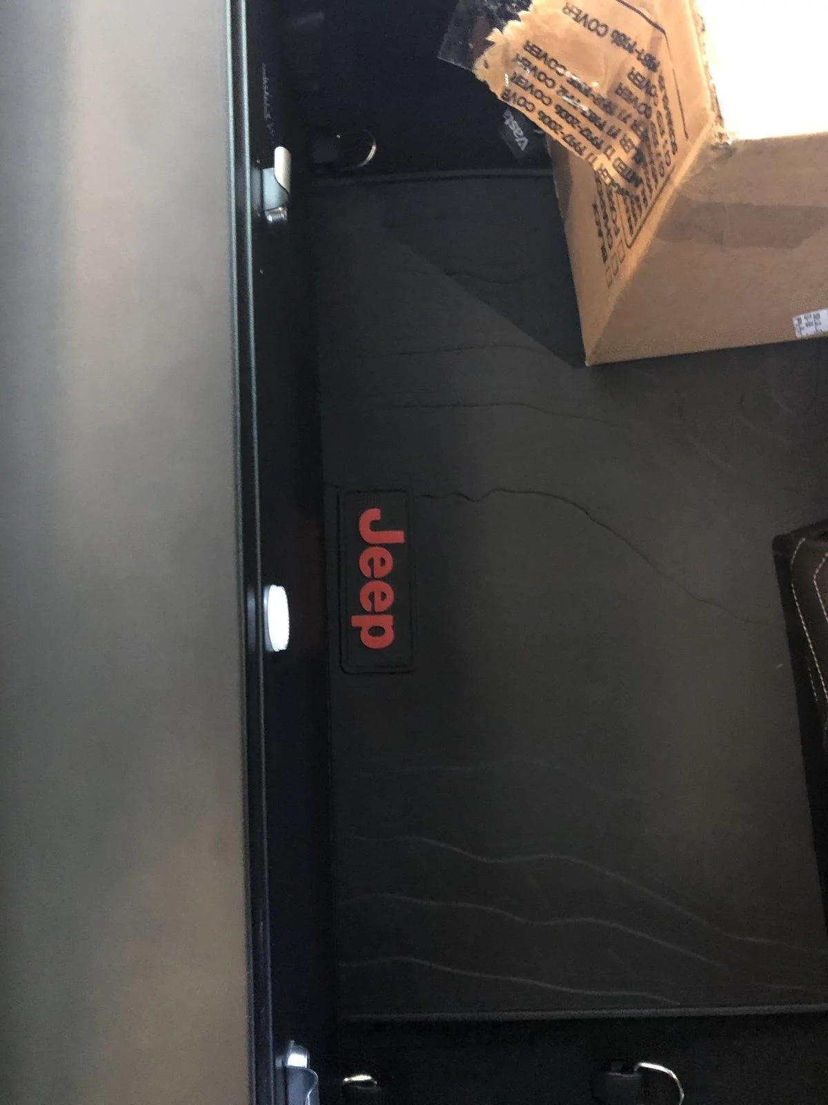

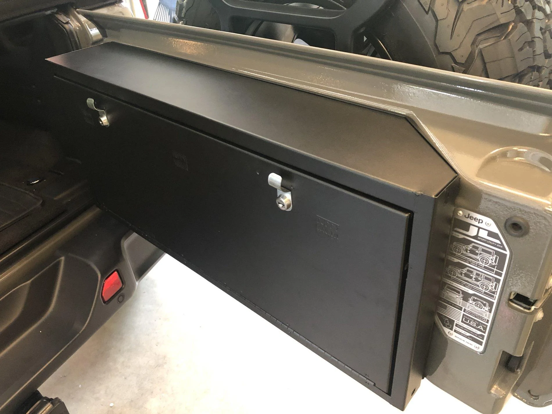

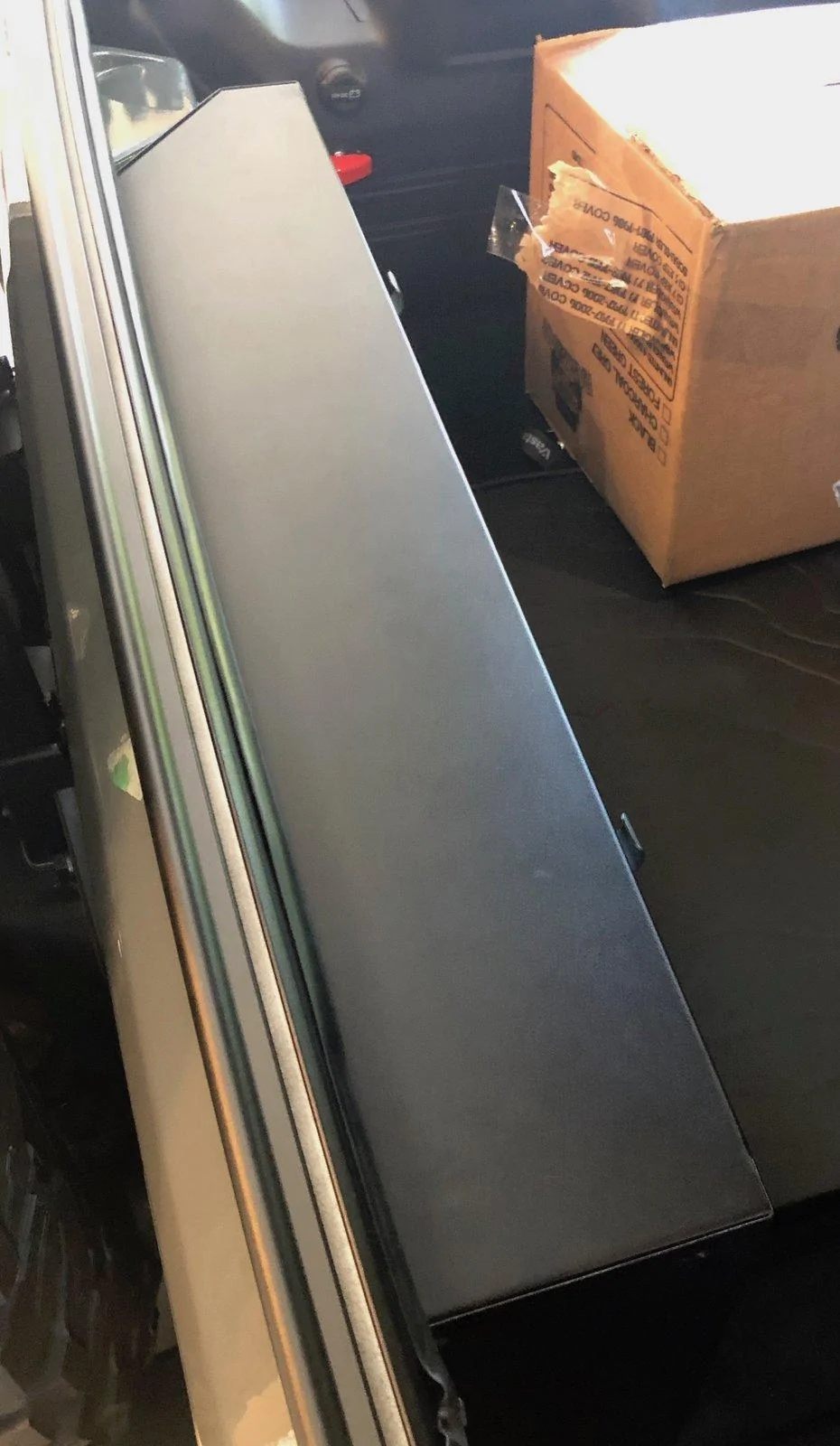

Installed my Tuffy Tailgate lock box today using the same method as @RagTopDeluxe and others with just removing the plastic and not using any spacers. I applied the auto/marine stripping to the various bolt attachments and then did a strip all along the back of the box that would contact the metal. Looks good iMO and feels quite sturdy. I did have the top left bolt which didn't seem to tighten all the way so I added another washer which seemed to work. Haven't driven with it yet but it fit good even with my Jeep cargo mat installed.
Nicely done! You may have inspired me to go back and redo mine!
