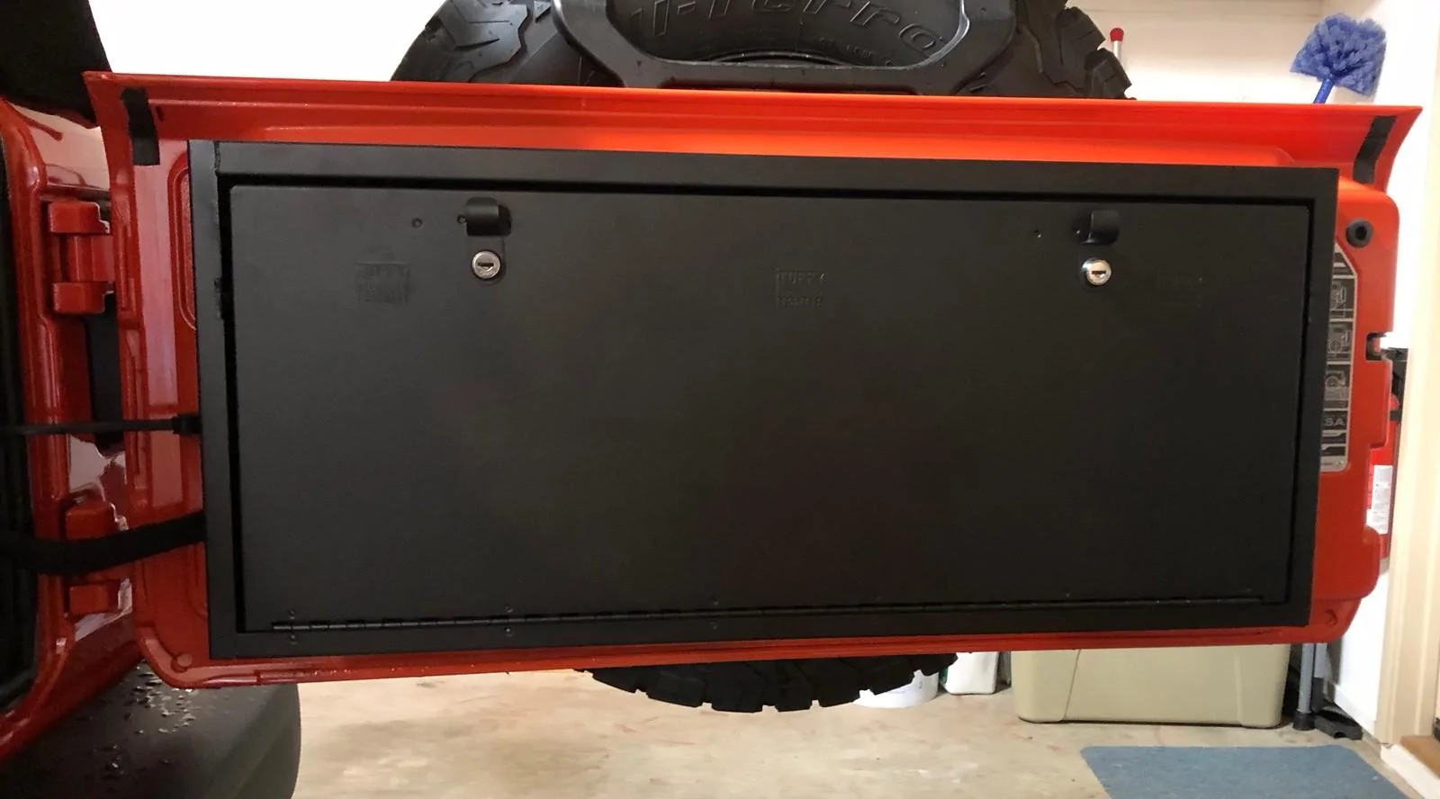

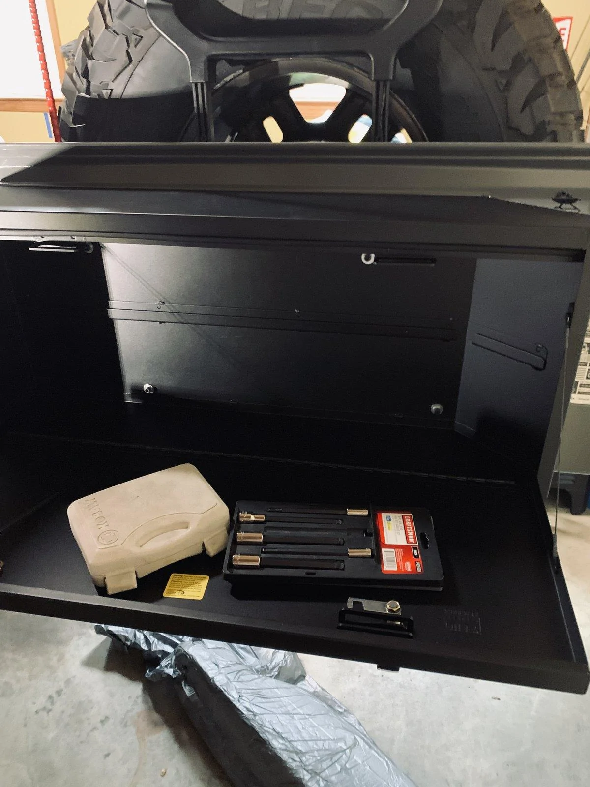

I mounted the box directly to the tailgate without the plastic cover and it fit just fine. I used weatherstripping along the back of it to avoid any squeaking.

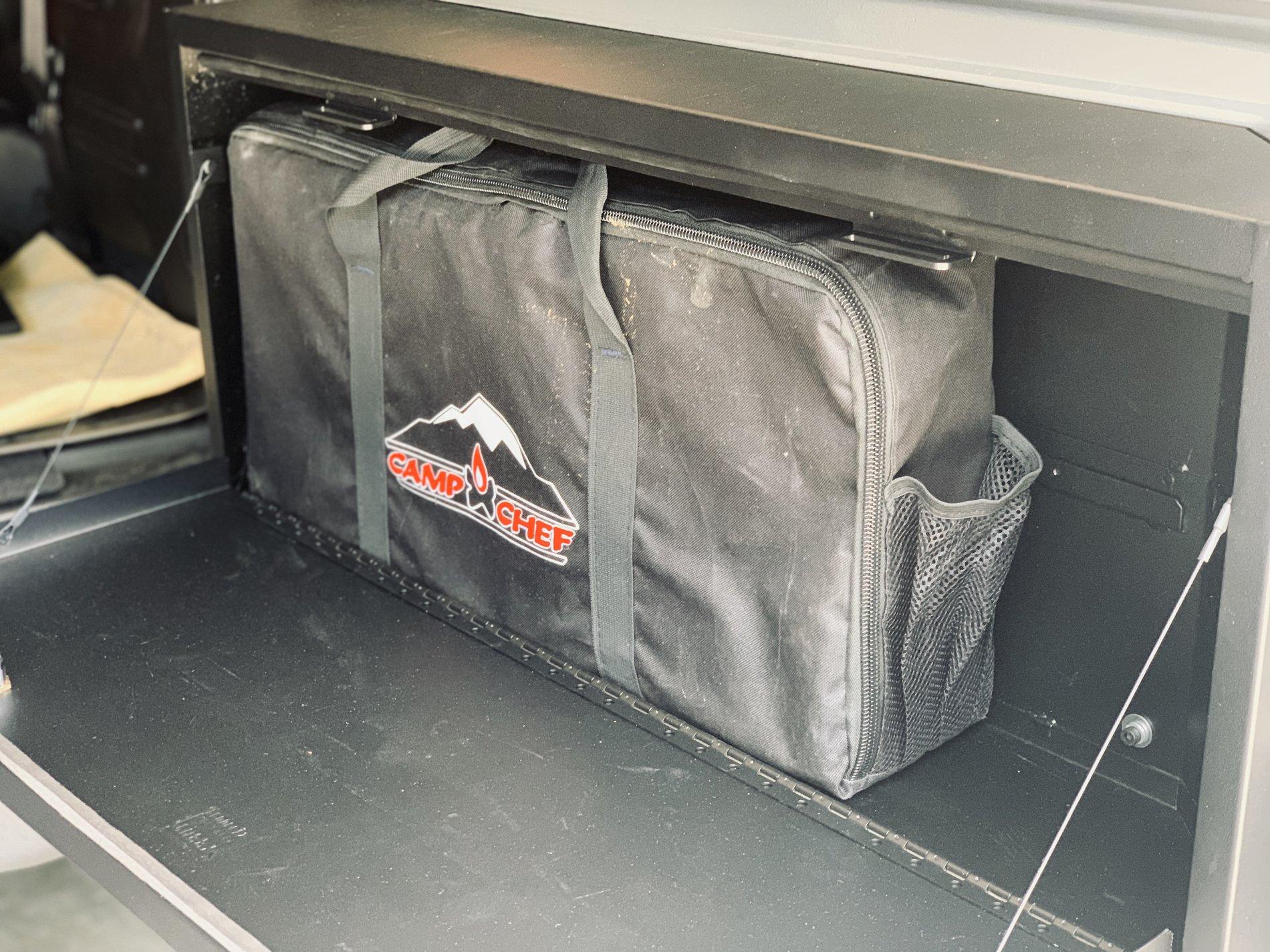

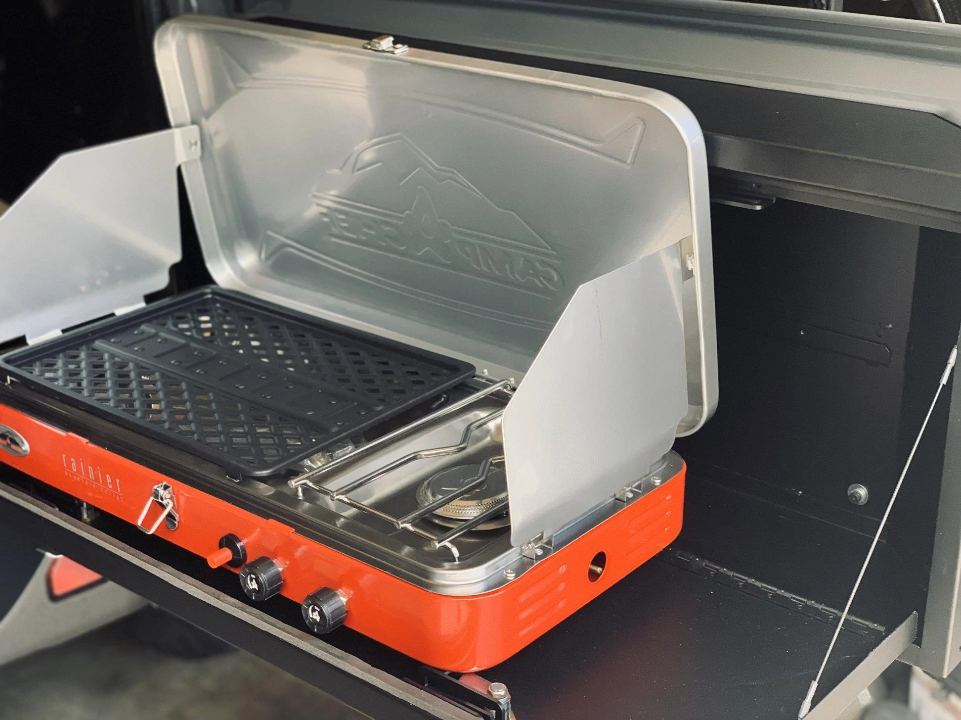

thanks for the tip! just finished mine up installed as you posted, had some 1" bolts and 1/2" spacers for the bottom from other projects. Just to add to the thread, in camp/cook mode :) a Camp Chef Rainier fits nice and tight in there, just leaves enough room for the fuel.

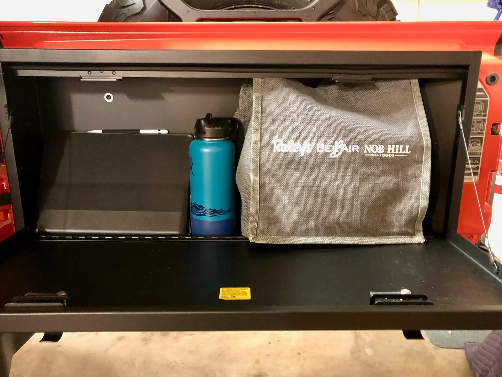

I just put this on this afternoon and it's going to be the perfect size for me—will hold my iPad Pro, hydro flask, lunch bag, and a few other things. This will be soooo helpful when I'm running errands.

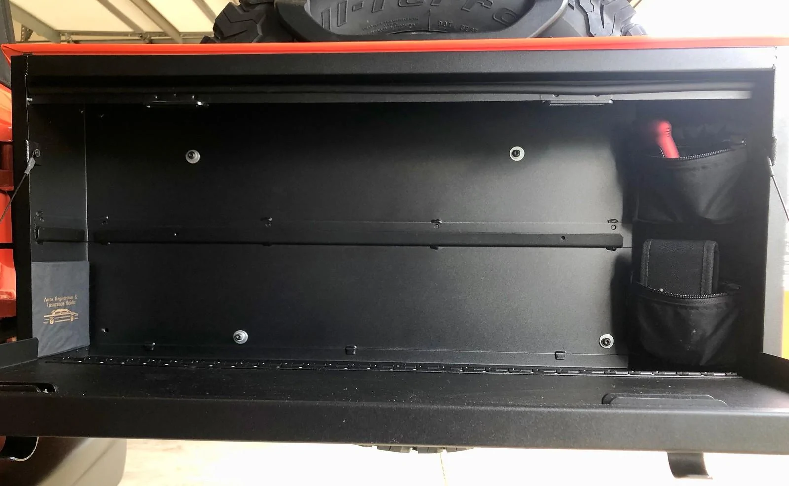

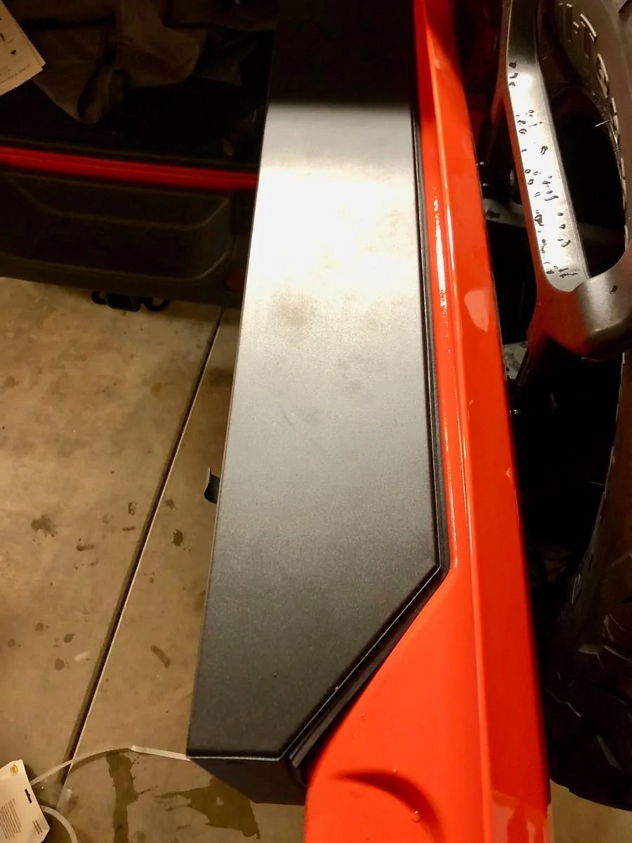

I'm really happy with this box. I installed it directly against the tailgate, putting "md auto & marine rubber weather seal" (got it at Lowe's) around the perimeter of the box and on the mounting points on the tailgate.
I had some molle pouches from my Miata and used velcro tape to attach them to the inside of the box. I have put my tire pressure monitor, lug lock and Jeep tools in those. I also used velcro to attach my registration/insurance holder to the box. I have always kept that in the trunks of my convertibles, so this is as good. I don't want anything important in one of the locking consoles in the Jeep because I'd rather leave them unlocked.
Some photos:
