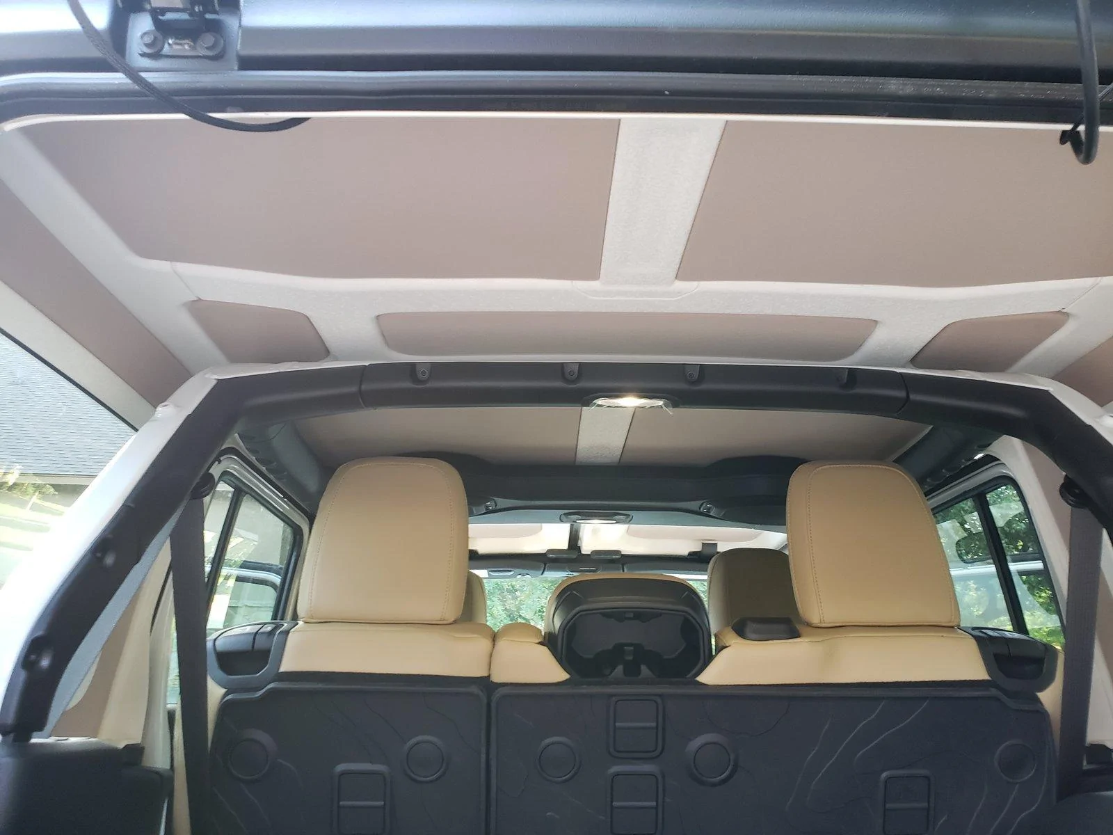

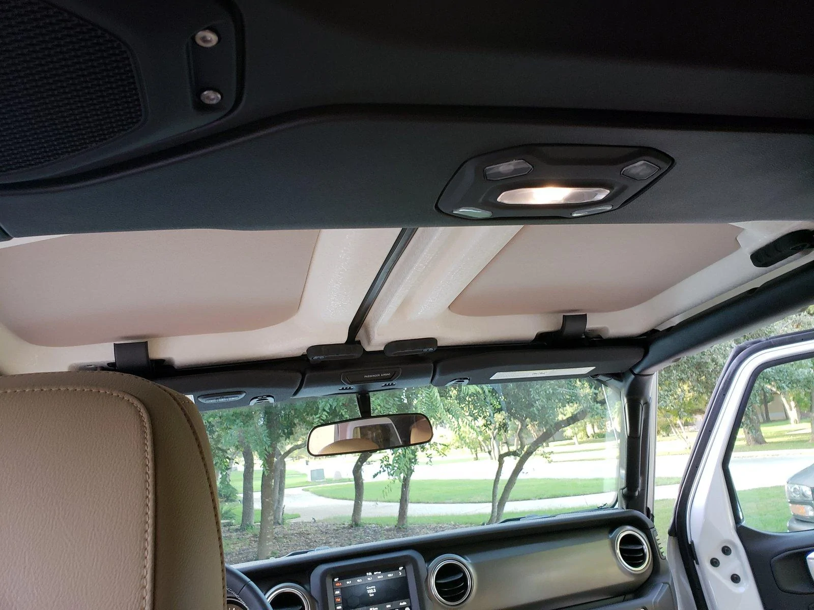

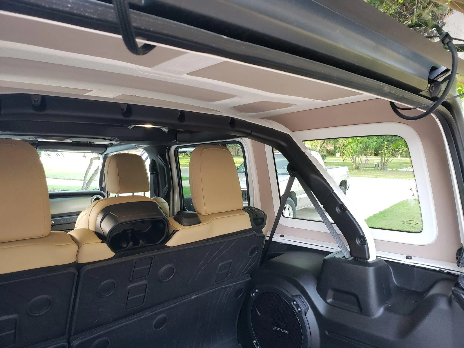

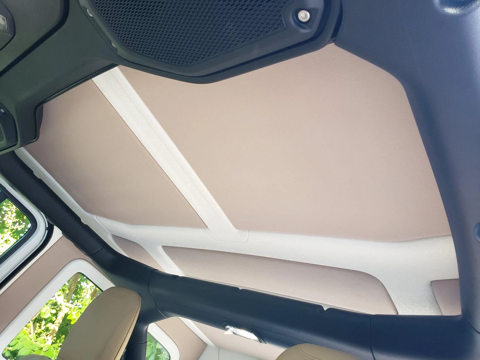

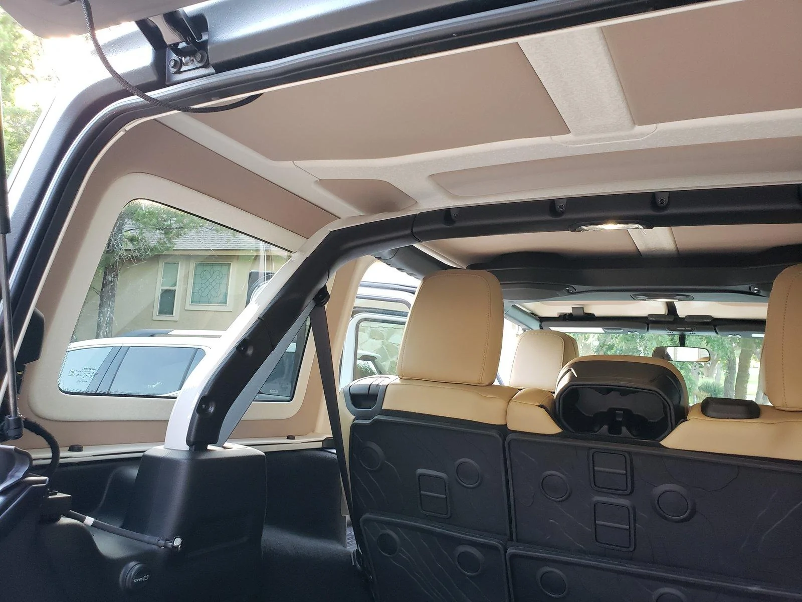

Lets keep it simple they lower the inside temperature very well and they help the Alpine stereo system sound much better.
It would be nice to know how the R-values of the panels for it compared to the base hard top and the factory panel liners.
But, we're talking about basically a black box with glass panels on it. We're not going to get miracles here. :(

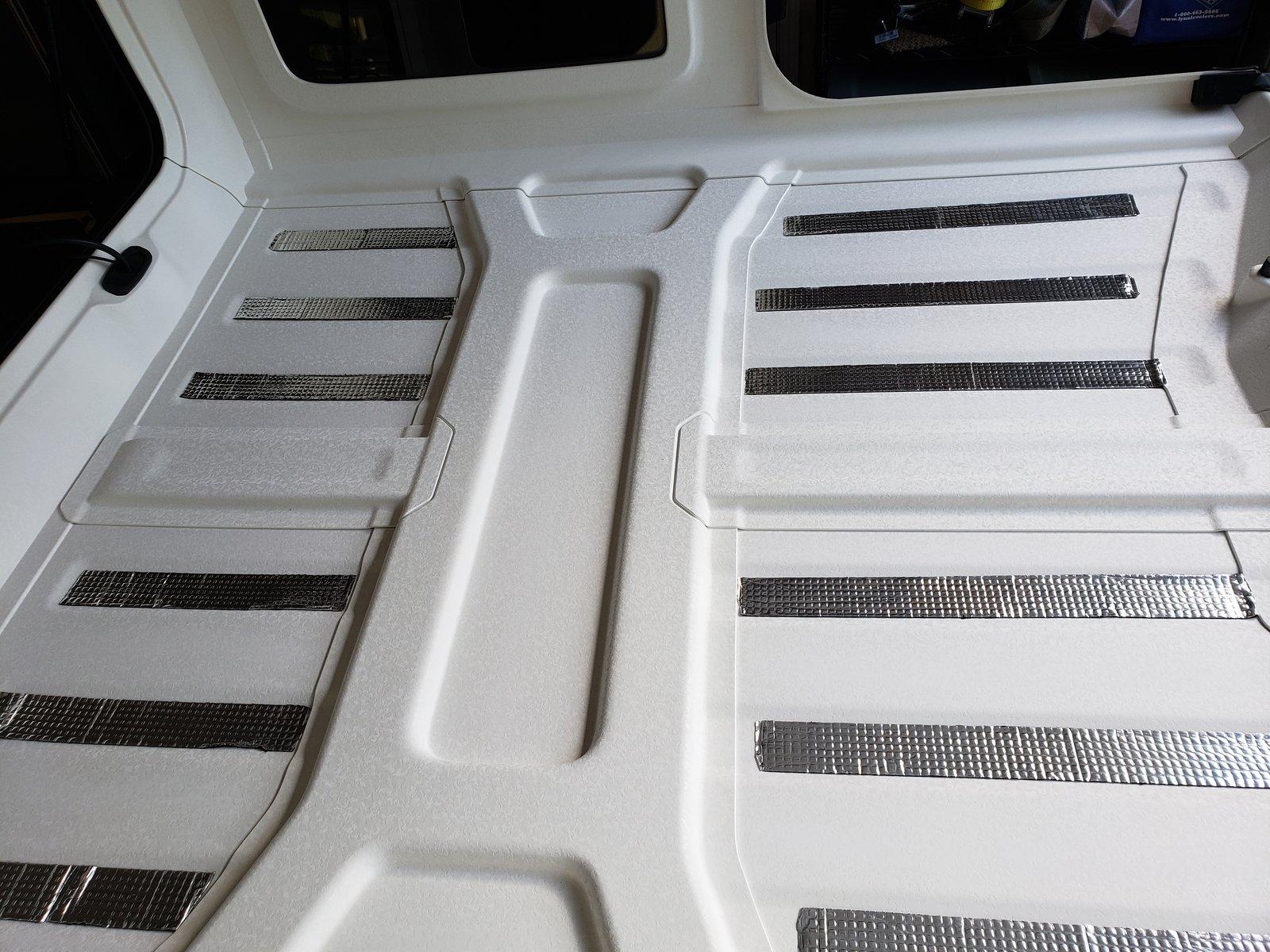

The Hothead Headliners use 3M tape. You have to gently sand down the exposed roof surface and then wipe down with acetone. I guess you could apply HH to the OEM headliners...but it would be complicated. Is the OEM headliner hook/loop material (that is...will a Velcro strip stick to the OEM material?) You would have to apply industrial strength self-adhesive Velcro strips to the HH panels, and then 3) Stick the HH panels to the OEM panels.
A couple of problems come to mind...the doubled layers would give a 'stacked' appearance to the headliners and I don't think that the OEM panels are designed to carry the additional weight of the much thicker Hothead Headliners. So in conclusion...I don't think so...but you could try it.
Update: After a month...the HHs on the roof are staying put nicely. However, the side window Headliners are not holding as well. The instructions state that you don't have to sand down the sides, just wipe with acetone. The Velcro did not adhere very well...so I pulled the side pieces off carefully. I then sanded the areas and re-wiped down with acetone. then I used new Industrial strength, self-adhesive Velcro.
Daytime temps have been in the mid-90s. The JL hardtop is already well insulated...I couldn't feel any significant warming
on the ribs between the headliners. The headliners do insulate more for sound than heat...it appears.
