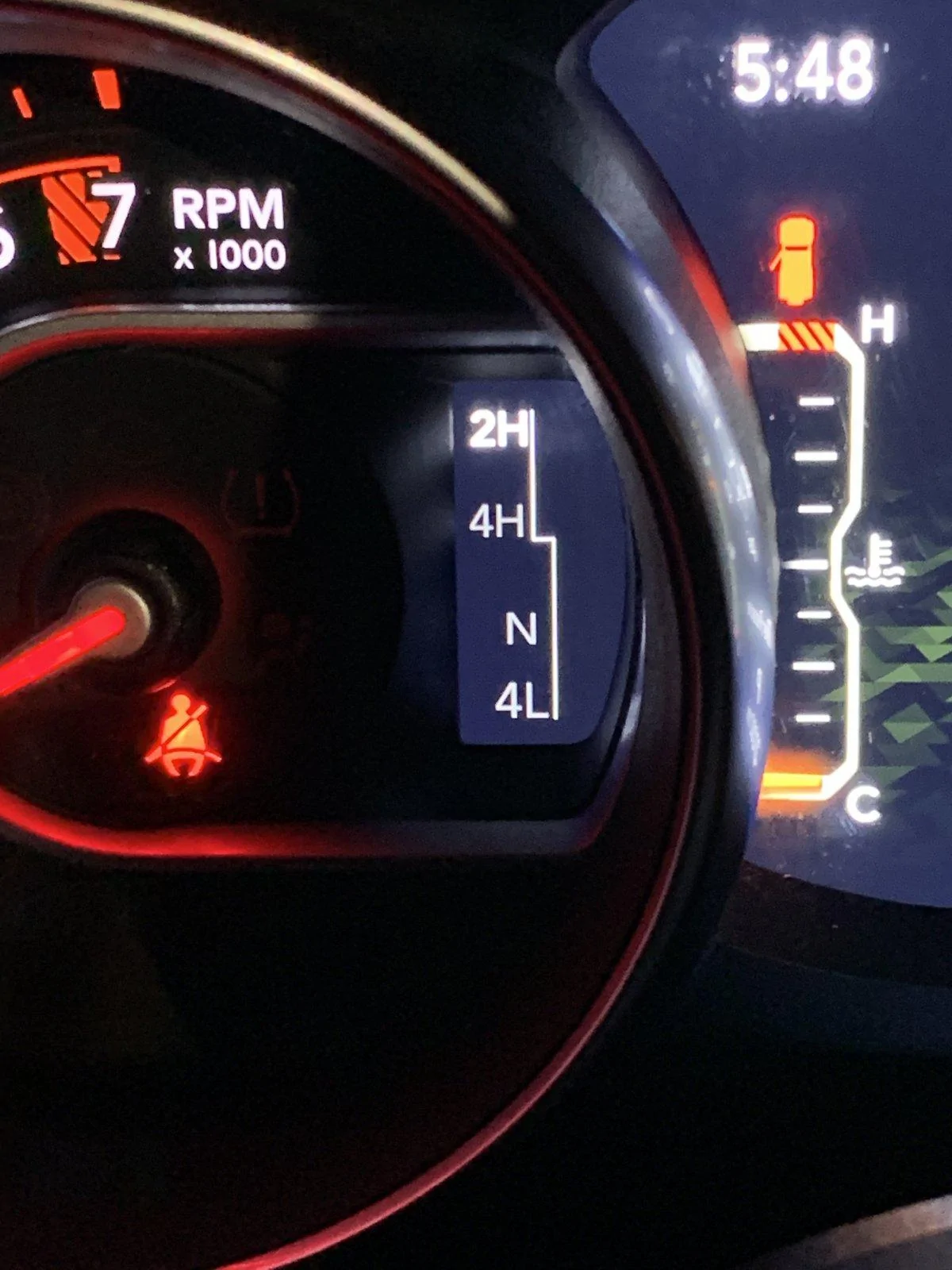

As mentioned, it’s tough to get it into - and out of - 4HI for a while. The more you do it the easier it will be to engage. Shifting into 4LO is even worse.
Here’s where the shift indicator is.
Agree! It takes a couple of times for it to be easier with 4H but 4L is even worse. Mine's on it's 2nd winter and doesn't go into 4L as much as it should. Sometimes I can shift it in but can't get it back out even in neutral.
