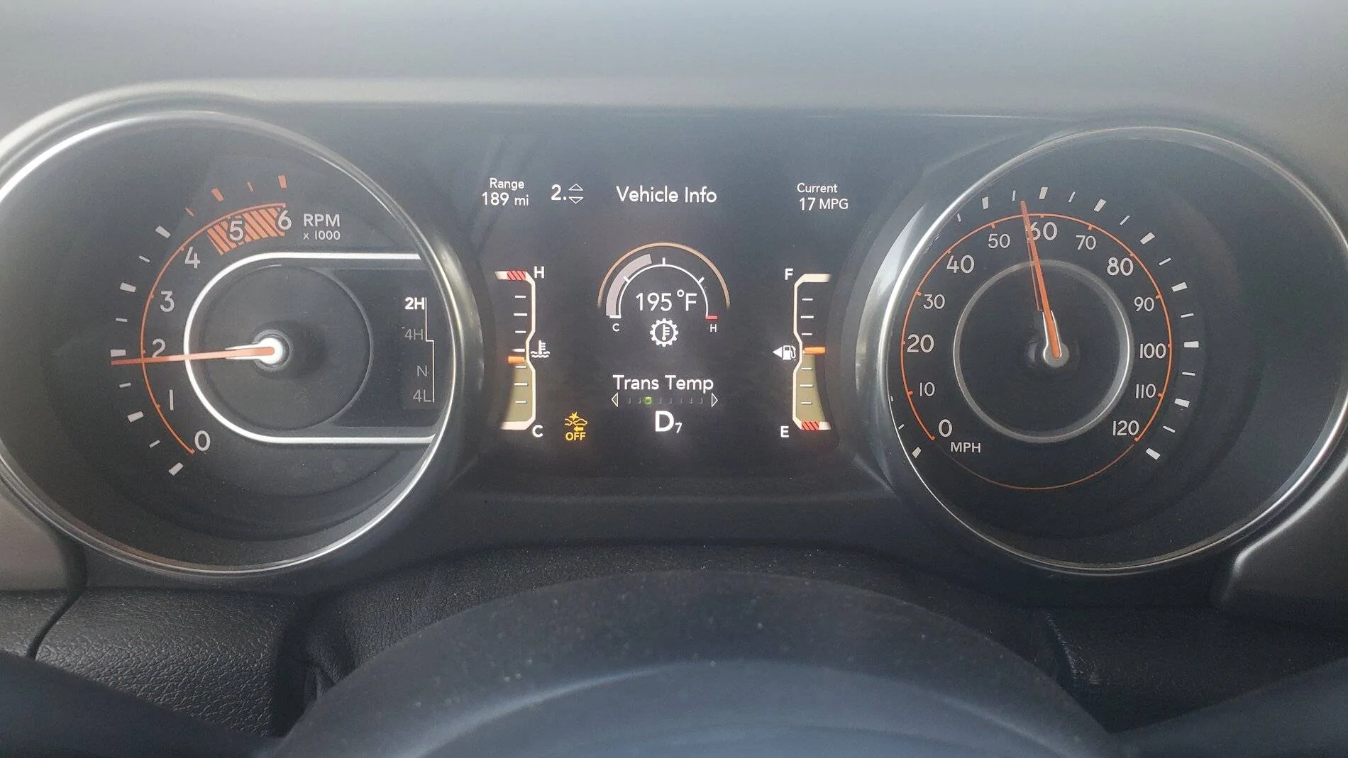

I was driving from Phoenix to San Diego the other day and pushing the jeep pretty hard 90 mph+ a lot in 105 to 107 degree weather and I noticed that my trans temps were around 210 degrees. Going through the mountains before San Diego I had it floored a lot seeing how it would take the inclines and at one point the trans temp got up to 222 before I backed off it to let it cool down. It seemed too hot to me. What kind of trans temps are other people seeing?

Went wheeling yesterday in a heavily corroded forest road for about 3 hours and my trans temp was steady at 199f. Coolant temp varied between about 185f and about 225f and the cooling fan was on about 70% of the time at varying speeds, but rarely at full blast. Outdoor ambient temperature started at around 45f and went up to about 60f.
