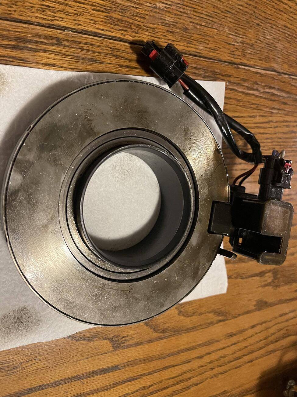

I agree, the Dana 44 holds about 1 1/2 quarts of fluid and in my opinion if you are using it in extreme conditions. The Dana 44 will not hold up. In the course of towing campers over 50,000 miles with my JL, I cooked the electronincs many times. To the point that they blister from the heat and failed. The locker itself was fine, the electronics and wiring not so fine.
The problem is well you can not buy the electronics for the locker. It is just recently that you can now buy the locker positioning sensor. You still can not to my knowledge buy the magnetic ring yet. In the pic you can see fluid that is baked on to the ring.
Jeep Wrangler JL Rear axle temps 1730462372827-h3
This is what the electronics look like baked by the hot diff fluid. You can see the heat blisters on the plastic. The Dana 44 does not fair well if it worked.
