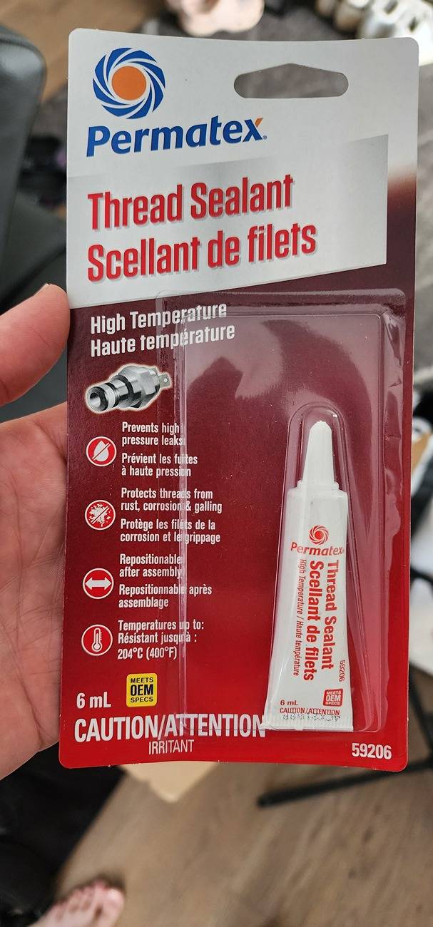

For sealing up the drain/fill plugs would this work? (Will be doing the diffs and transfer case)
Or is teflon tape a better option....is so, which one?

Bump for some input/guidance, would ve greatly appreciated.
I use that on plugs if they don't already have sealant on them.
Don't use much. Just enough to coat a couple threads. It gets squished into a really small space.
Teflon tape works but can have bits break off and get into the oil, which isn't ideal.

Is there a reason you need sealant? I've never used sealant on drain or fill plugs for diffs, and they never leak (even torquing to recommended spec, which isn't much!)
More of a CYA... don't want any drips, nor having it leak after it's filled, then only way to seal it again is to dump the fluid and seal/start over. Just a "cheap"/proper way to make sure all is good.
I've had diffs leak, especially with aftermarket covers. It doesn't hurt.

Edit: Disregard what I wrote below. Whats shown in your image is PTFE. Apologies for the overzealous response. That stuff is perfect.
Don't use this. You'll have a hell of a time getting them back off. Use some PTFE paste imo.
You don't need much.
