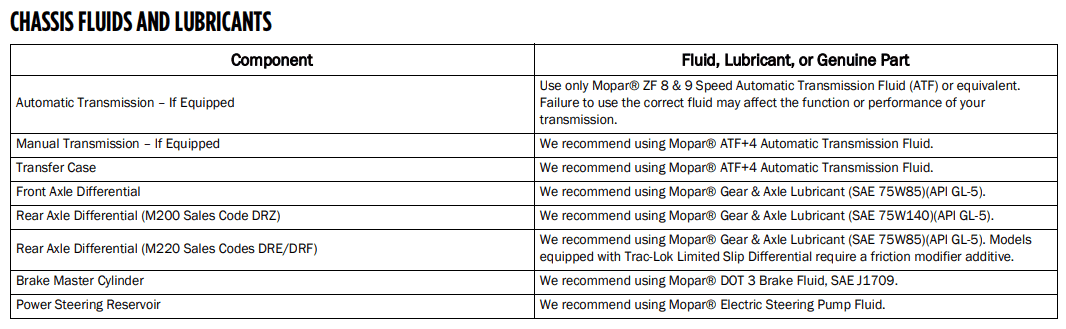

75W-140 or 75W-90 is fine. Some will say 75W-140 at the rear if you are towing or doing heavy off-road activity. Even if you went 75W-140 across the board for extra peace of mind works. What you will find is folks saying this or that.
Amsoil is just as good as any other top brands out there. Everyone has their preference.
From the Jeep owner's manual if interested:

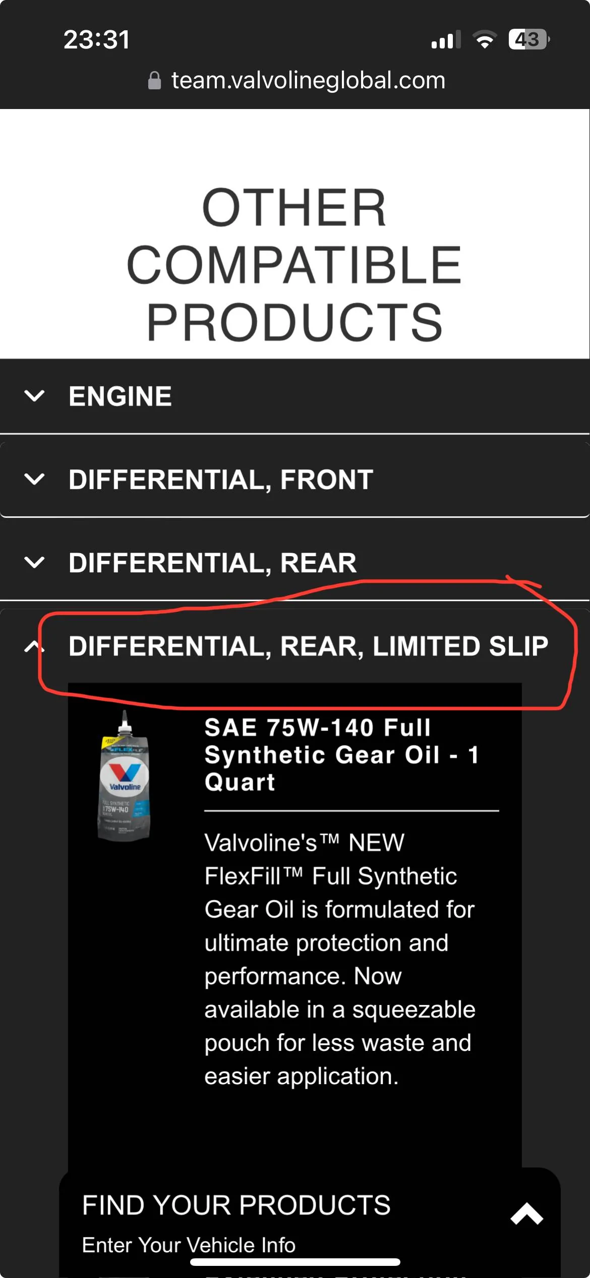

Is the rubicon with limited slip or without?

Rubicon has electronic locking differentials, not LSD. That picture with the Valvoline would be fine for your needs.

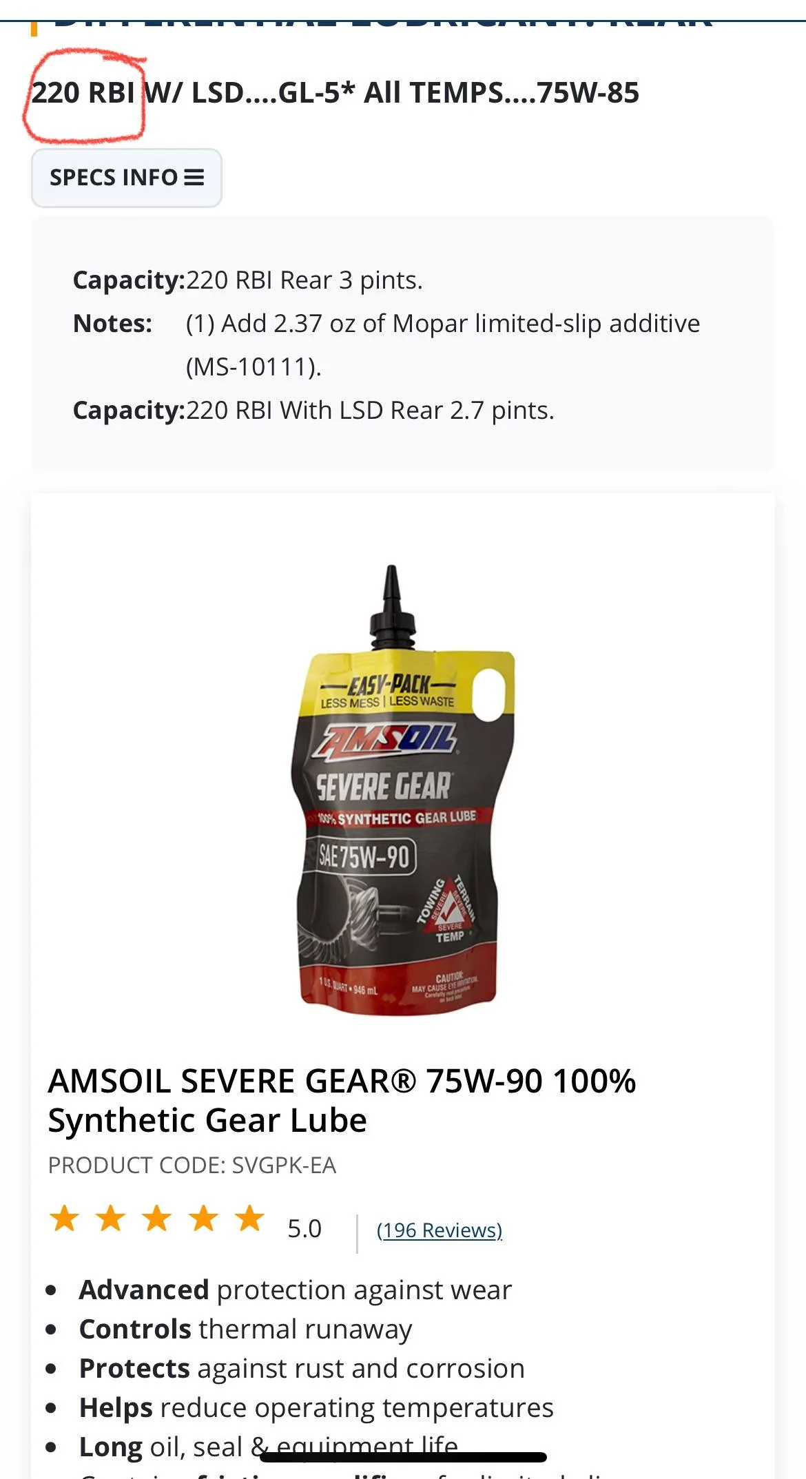

Jeep Wrangler JL Rubicon differentials oil IMG_3965
What is rbi mean for?
azwjowner
Oct 8, 2020
2,325
4,083
Phoenix
That is Dana’s lingo for the m220 axle. Don’t overthink gear oil. You can use 75w90, or for extra protection at the expense of approximately 0.5% fuel economy, 75w140. Amsoil severe gear is excellent, but really anything will work well.
