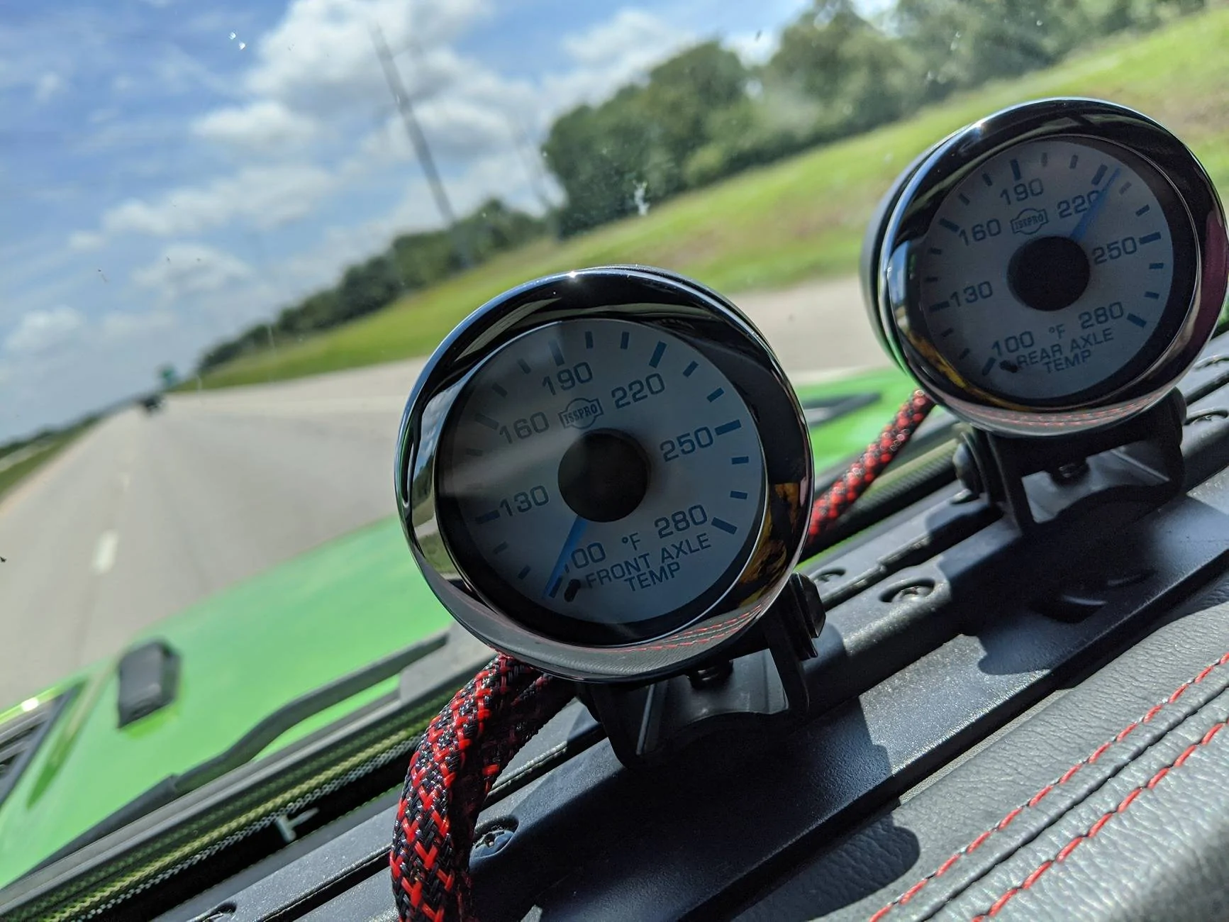

I use Valvoline 75w140 full synthetic in rear differential. This is on a 2021 wrangler unlimited rubicon with stock 33"tires. I checked rear differential temperature with a infrared thermometer at rear cover after a 20 minute trip on freeway in 98 degree weather and the hottest spot was 141 * at the upper portion of the diff. cover. Makes me wonder how hot they get on longer trips or with heavier 35, 37, 38 tires..
141°F is not hot at all since most axles run in the 180°F range. To answer your question of how hot they can get, here is my 2019 with 4.10 gearing and 33" tires running unloaded at 75MPH in 95°F weather:
good lord! 225* unloaded? Guess it's time I check mine.. Hope the 37's and 5.13s don't run that hot.
They do...an infrared reading is not as accurate as an immersed sensor (that I had on my Rubicon).
