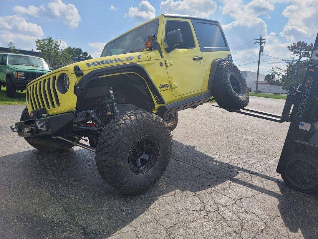

So working on the build up of my two door and we seem to have an issue with the front track bar rubbing the diff at times. We thought the Yukon cover was too big so went to the Motobilt option but after a wheeling trip same thing though less so.
Yeti XD Pro Track Bar
RPM Steering Components
Synergy 2” Springs
Stock Control Arms
We are getting a ton of flex but this is last real hurdle. Will let the shop play with it next week but any suggestions??

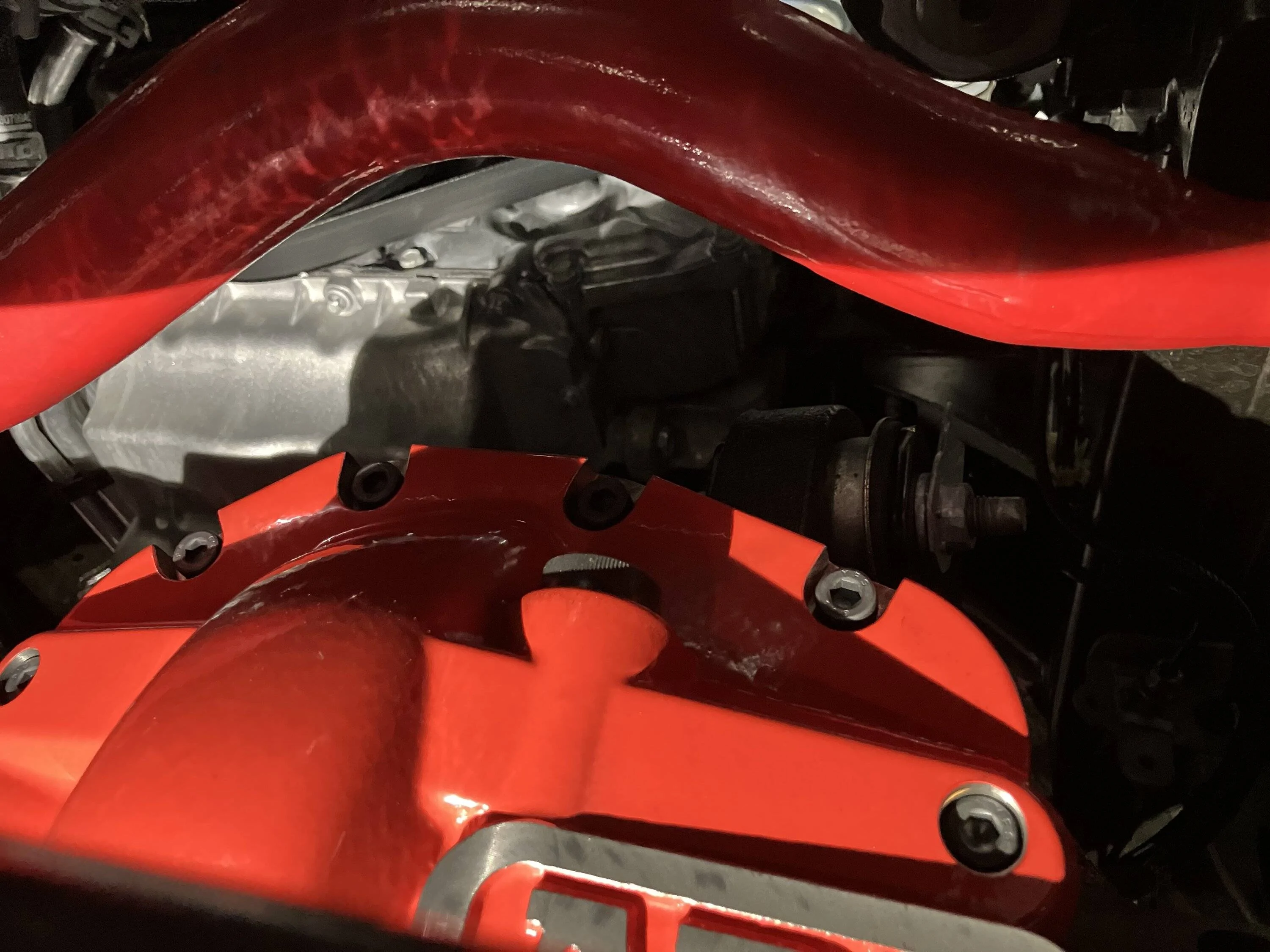

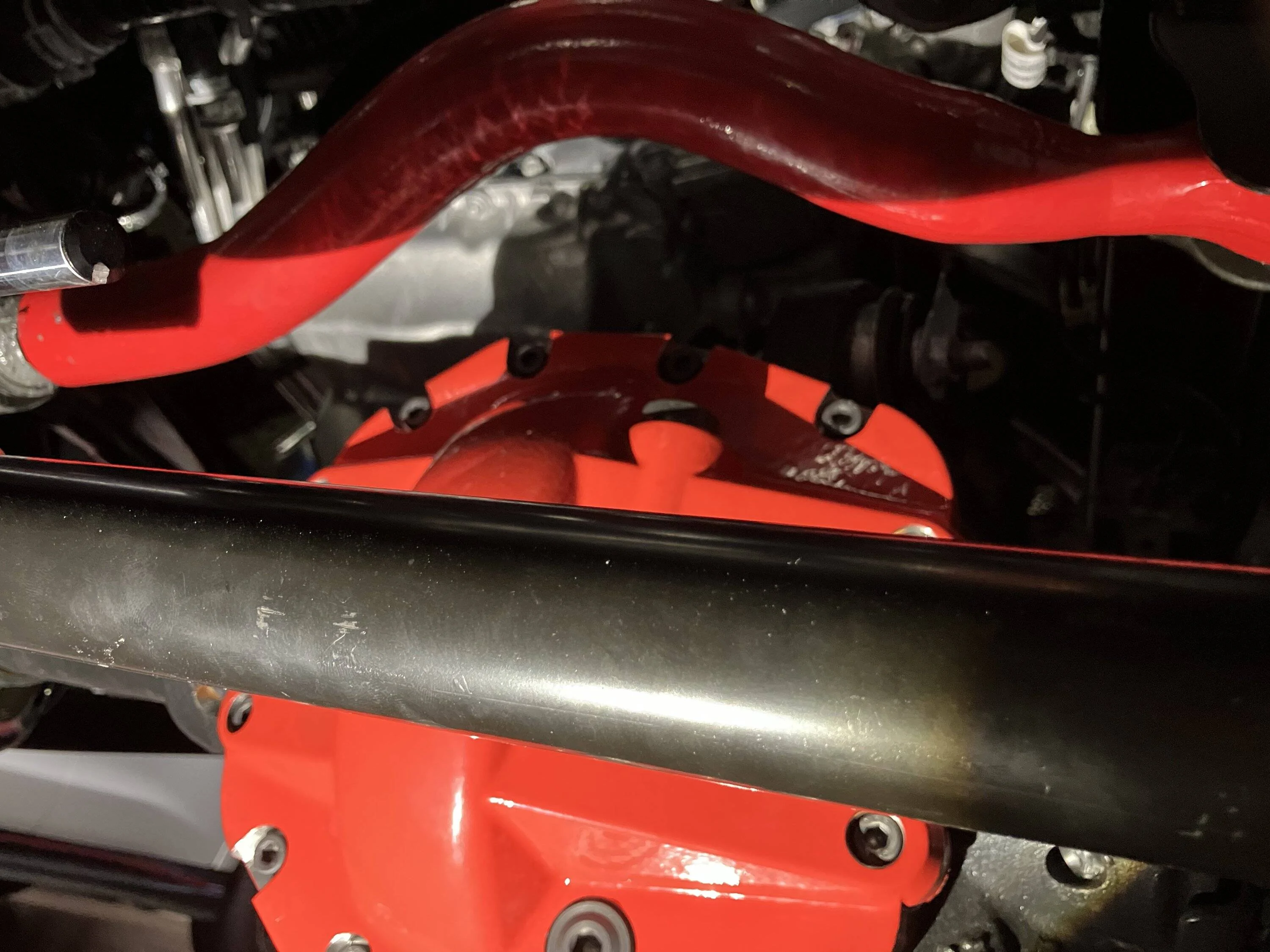

So after crawling under it and checking it out it is mostly the rub on the top left weld that seems to be the thing and is in the curve of the track bar it seems.
Will see if they have another option for track bar or anything else to try.

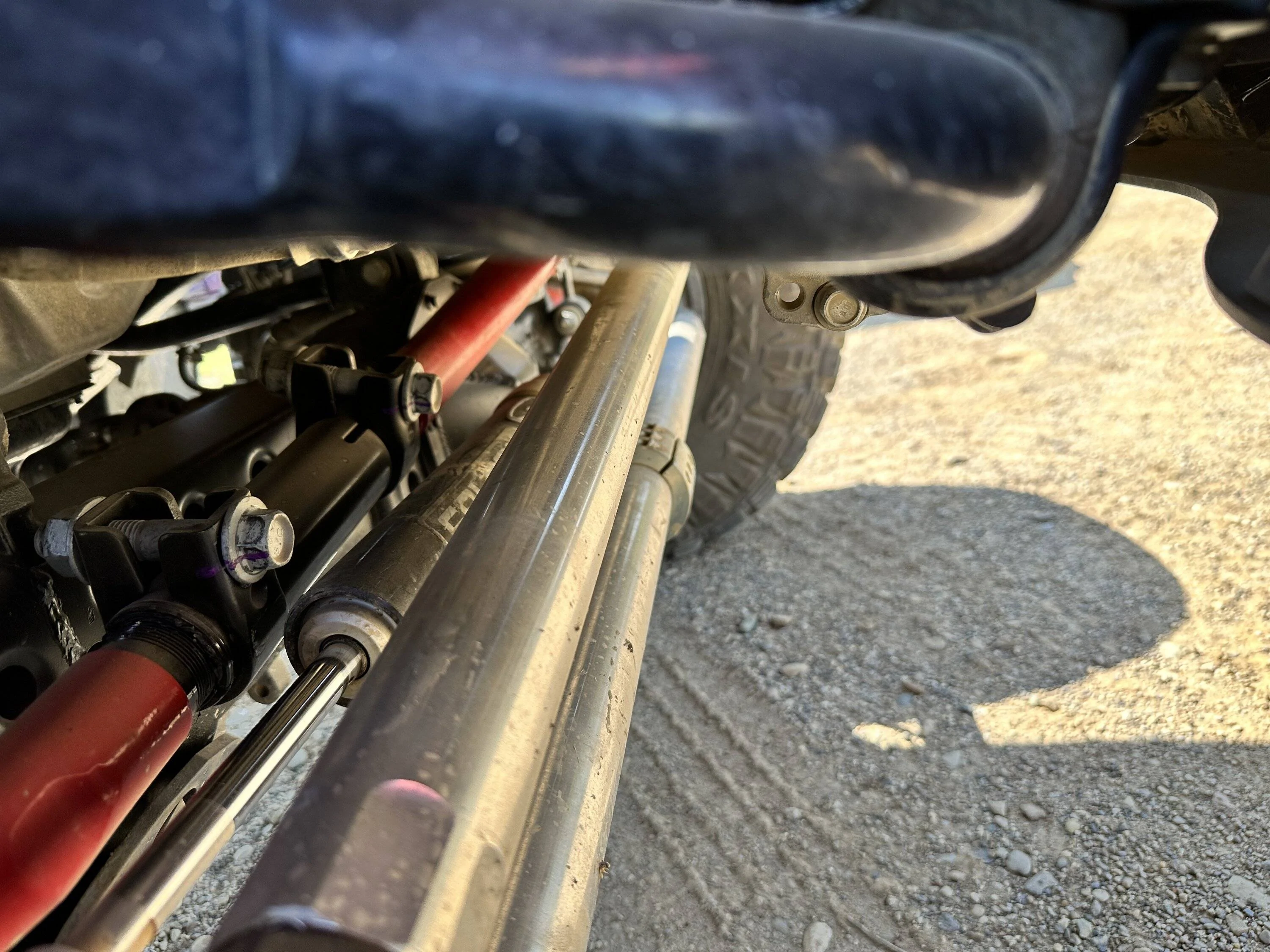

Are you sure the adjuster knob on your stabilizer isn't what's contacting the cover?? I had the same problem with my teraflex adj stabilizer and arb diff cover.
