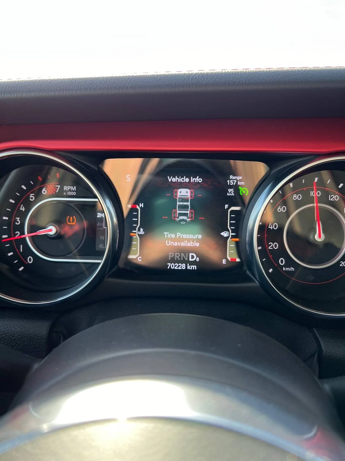

This happened on my drive
Jeep Wrangler JL TPMS not working IMG_0480

Still haven’t woken up! Currently at the stage of having filled them up to 38~psi and driving it around

So, here i am a couple days later and still no luck with this. Any more suggestions? Can the dealer fix this or are they just going to tell me that i need new sensors?(which i probably do lol).

I never did get a full wake up of my sensors. At one point last week I was getting a reading on one tire only, but now they’re all gone again and it says tire pressure unavailable.
