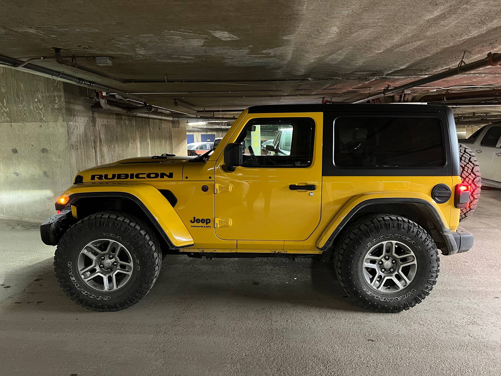

Hey guys,
So today I swapped over my wheels from my previous wrangler(2021 Willys), to my new wrangler(2021 Rubicon). Since then, my TPMS sensors are not working anymore. Am I supposed to reset these or calibrate them?
Build dates:
Willys, October 20th
Rubicon, September 21st
Note: I did not dismount tires, just a direct swap from Jeep to Jeep.
Jeep Wrangler JL TPMS not working IMG_0474
