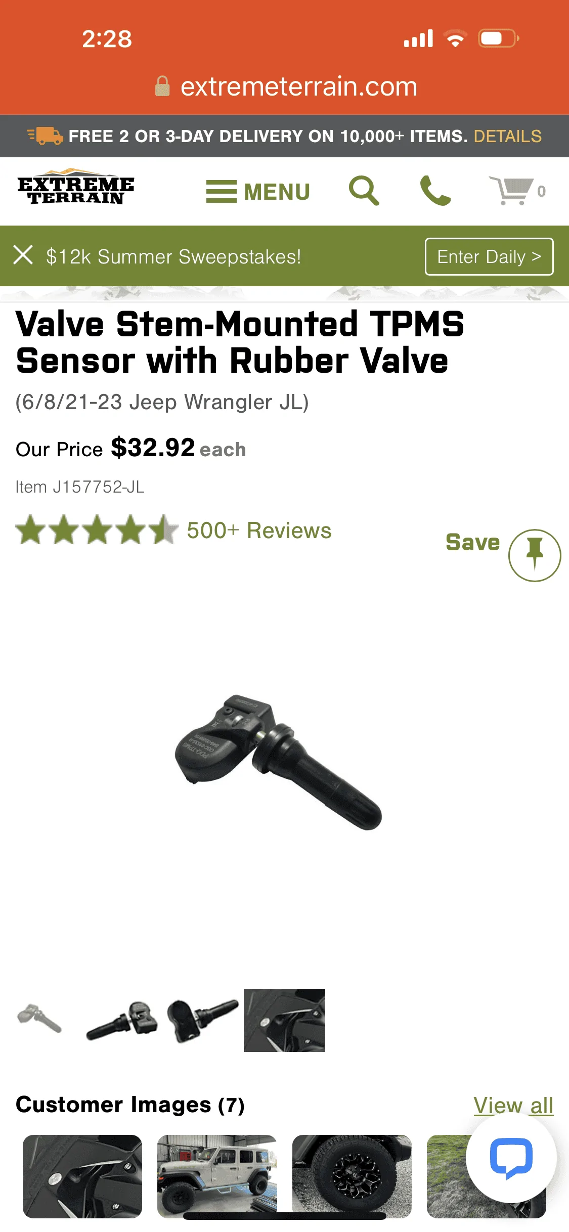

Thanks
Jeep Wrangler JL 2024 TPMS not working IMG_5039

I am having the exact same issues. I have new tires and wheels purchased from Custom Offsets. They connected right up to my 2021 Rubicon in May when I installed them. In August I pulled them off, traded the 21 for a 24 Rubicon and now they will not connect. I've reached out to Custom Offsets and they told me they are automatically going to reprogram. Set the correct pressure and drive for 30 minutes over 15MPH and I should be good. Unfortunately I've tried twice and they still won't connect. I really don't want to spend the money to replace them but not sure what else to try at this point.

The TPMS sensors that you said "connected right up to my 2021 Rubicon in May" will not work on your 2024. Whomever at Custom Offsets you communicated with is full of chitt..... you have the wrong TPMS's for your 2024!
For your 2024, you need ....your choice Continental TPMS's or the new Schrader 33500 TPMS's. Just be cautious where you buy from. Sure you may save a few $ but end up with old or counterfeit TPMS's.
I myself only buy from tpmsbargains.com.
Suggest you buy the Schrader 33500 TPMS's from www.tpmsbargains.com @Goin2drt
https://www.tpmsbargains.com/Jeep-Wrangler-TPMS-Sensor-p/tpms-1051-43-335-0910-wra.htm
The Schrader 33500 TPMS's you buy from them will be fresh, non-counterfeit and YES, programed
and with these correct for your JL TPMS's, you install them and your JL will play with them with no action by you.
