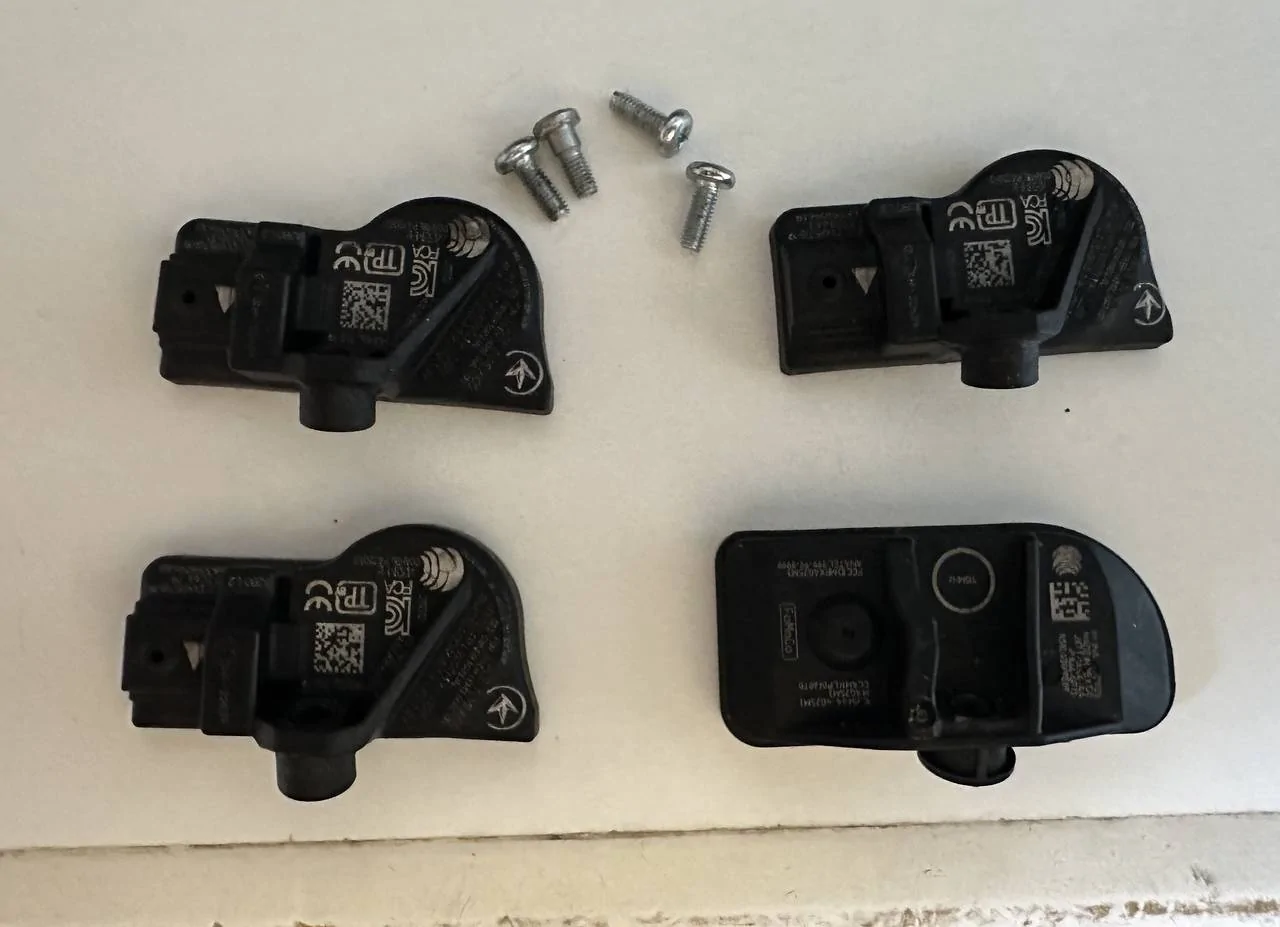

Schrader Sensors prior to mid-2021
Jeep Wrangler JL TPMS Situation... i-Vkbh63g-X2
Continental Sensors since mid-2021
Jeep Wrangler JL TPMS Situation... i-7QzTn5d-X2
The receivers are different too therefore they are not compatible. On my Jeep, when I changed to the correct sensors, the tire pressure system reset in 10 miles.
