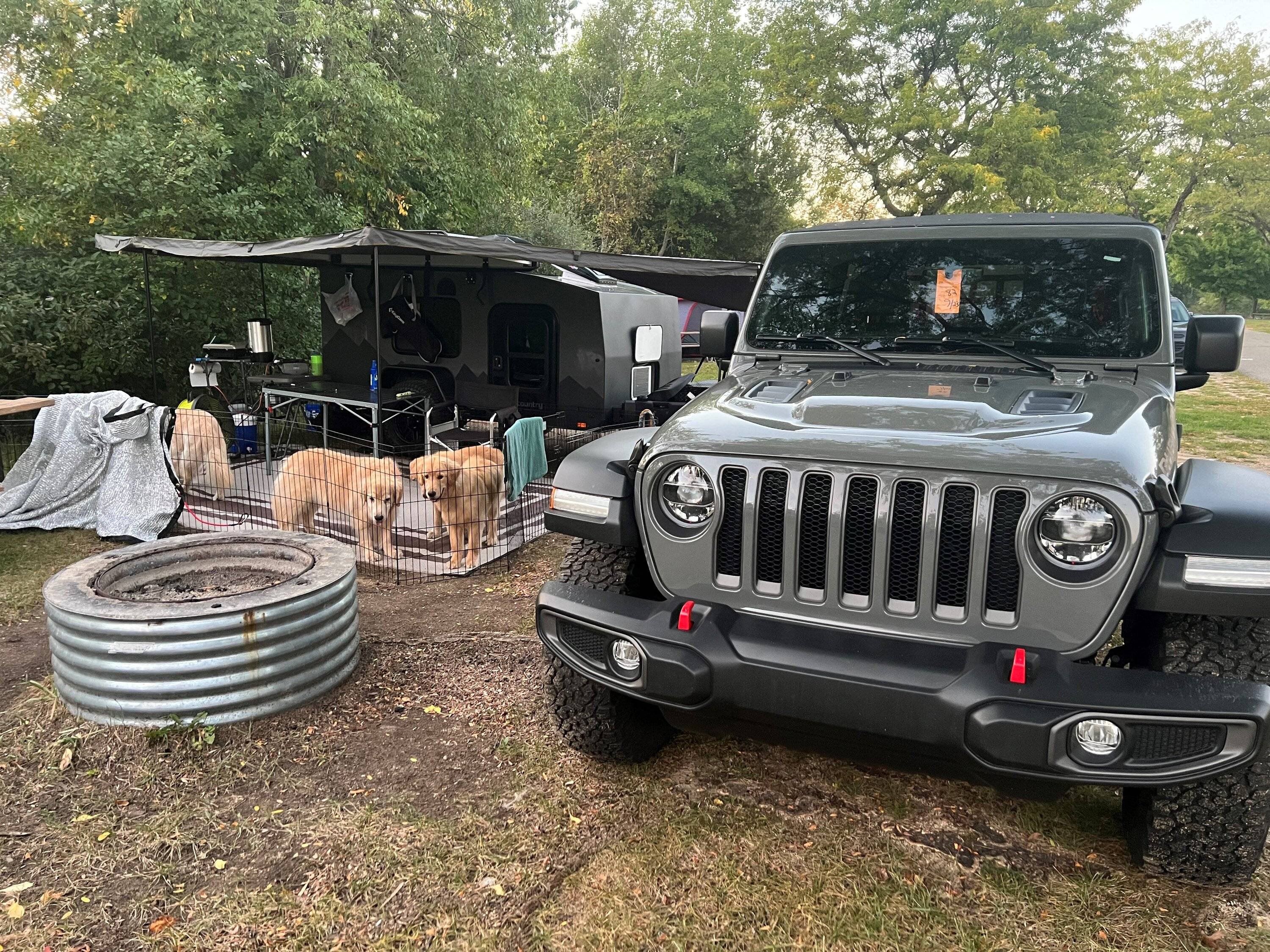

First, apologies as I wasn't seeing anything directly on point. Second, have a '21 JLUR, 3.6, 6-sp, currently stock but for a Rusty's full-length bumper & Rough Country Pro 9500 (Warn unavailable where I'm at). Third, like everyone else, looking to balance on-road daily driving (stock ride, a bit softer) with offroad needs, particularly pulling an 1800-lb off-road camper (Escapade Backcountry). Photo of my current setup (prior to bumper swap) and my Jeepin' buddies.
