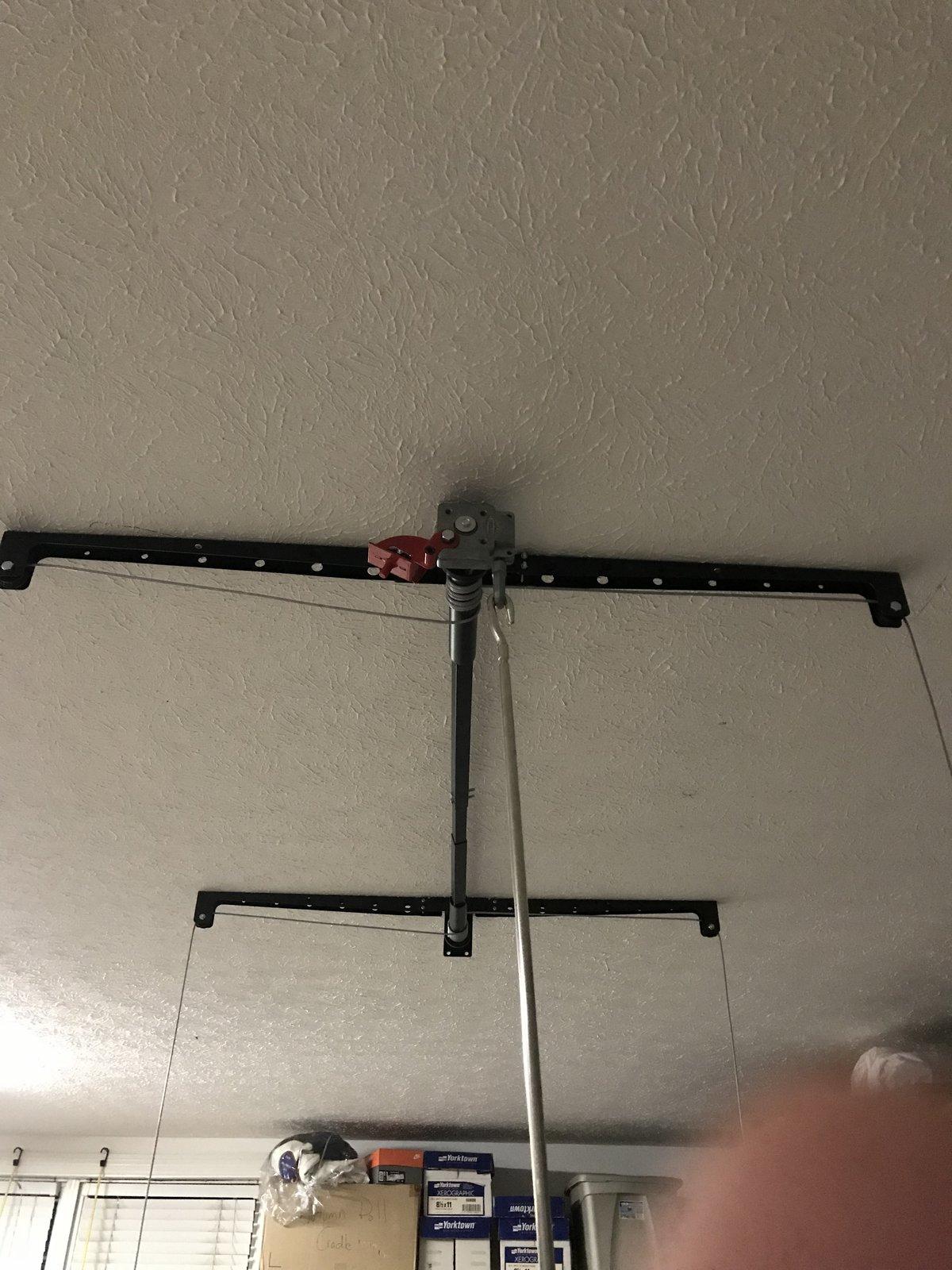

Does anyone have any ideas on how to install a racor with this beam right in the middle of my ceiling? I have my “old” hoist from my last Jeep mounted to the ceiling and it flat out doesn’t work. Main reason being that I have new wheels and 12.5x35" tires on and the spare sticks out so much further that it is hard to get far enough back in the garage for the old placement to work. Rather than move the 2x4s on the ceiling, I'd rather put my new Topsy brackets to work with a racor lift...just cant figure out how to make it work.
I see 3 options:
1: Go into the attic, and mount the hoist ABOVE the ceiling. You'd need to make holes for the cables to hang through, and then mount the rack at such a height that it's below the beam and above the Jeep.
2: Make a frame/bracket on both sides of the beam, with them being as low as the beam. Mount the hoist to the new lower brackets.
3: Put a hole through the beam that is large enough to allow the center bar of the hoist to go through it. Then mount the hoist as normal to the ceiling (with the bar penetrating the beam)..
I think option 1 would be the cleanest looking, though option 2 would likely require the least work. Option 3 wouldn't look too bad, but would likely be the most work and require more precision.

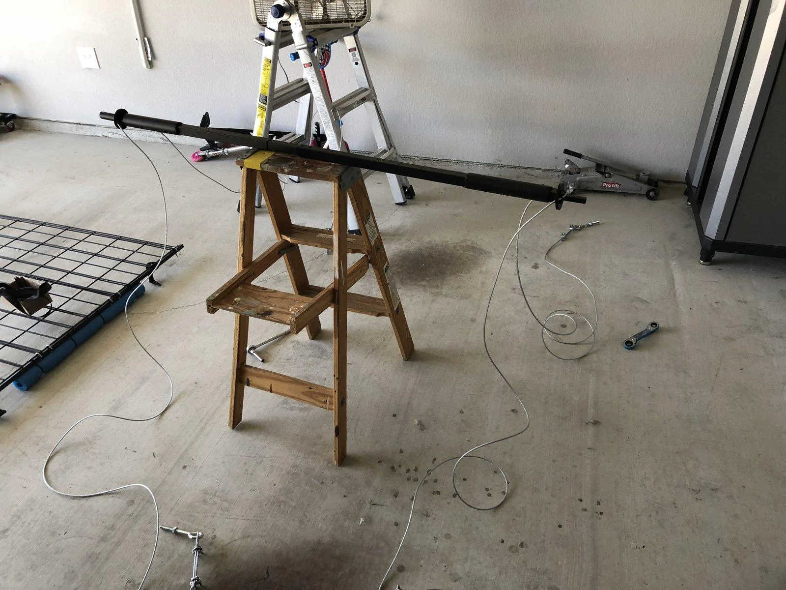

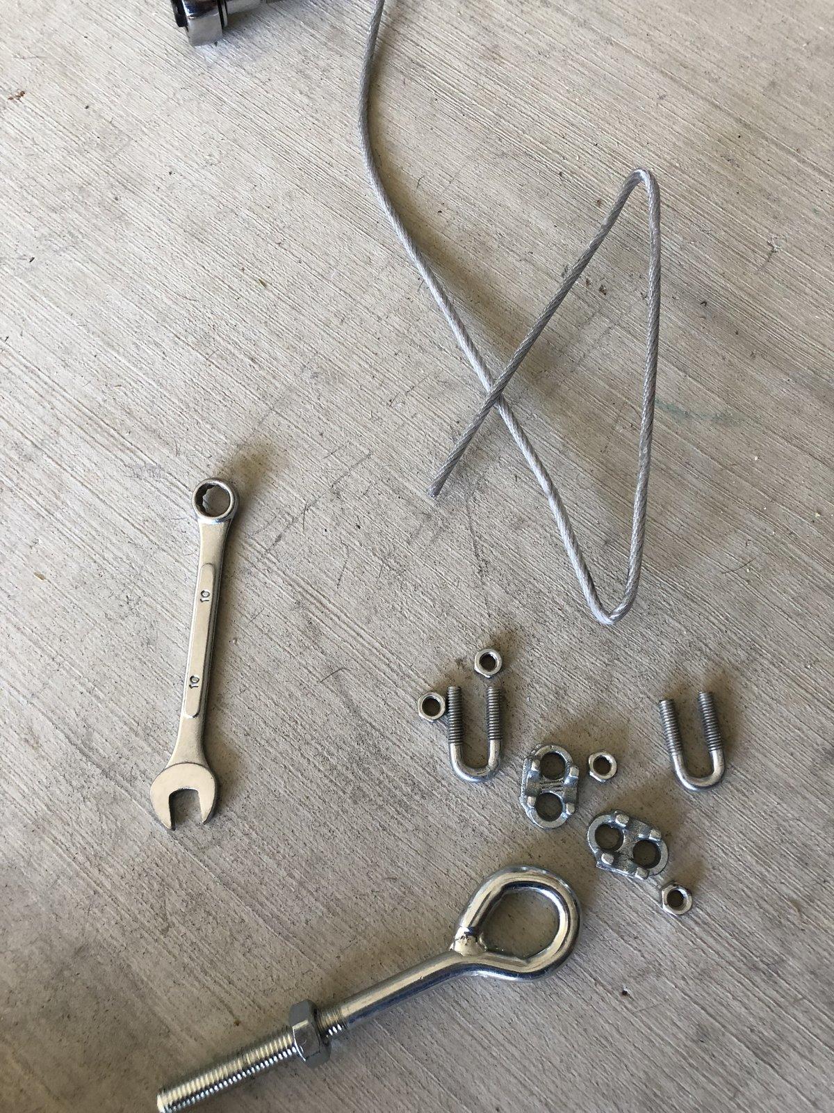

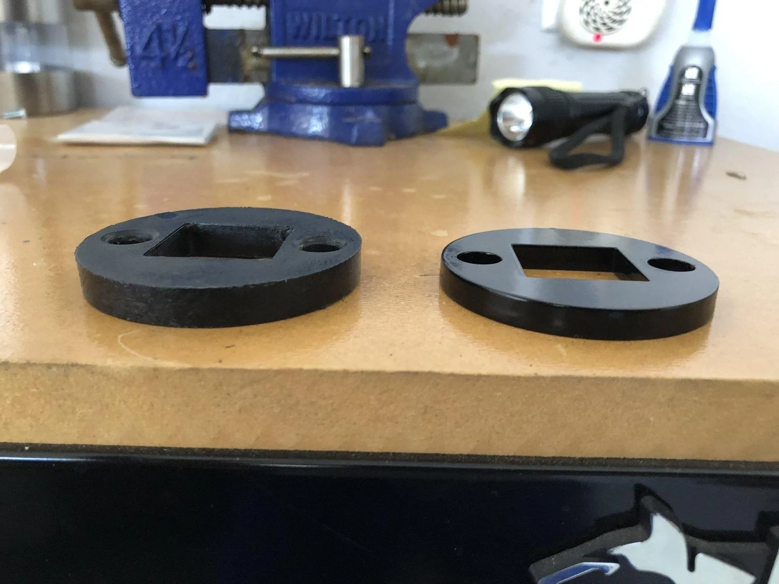

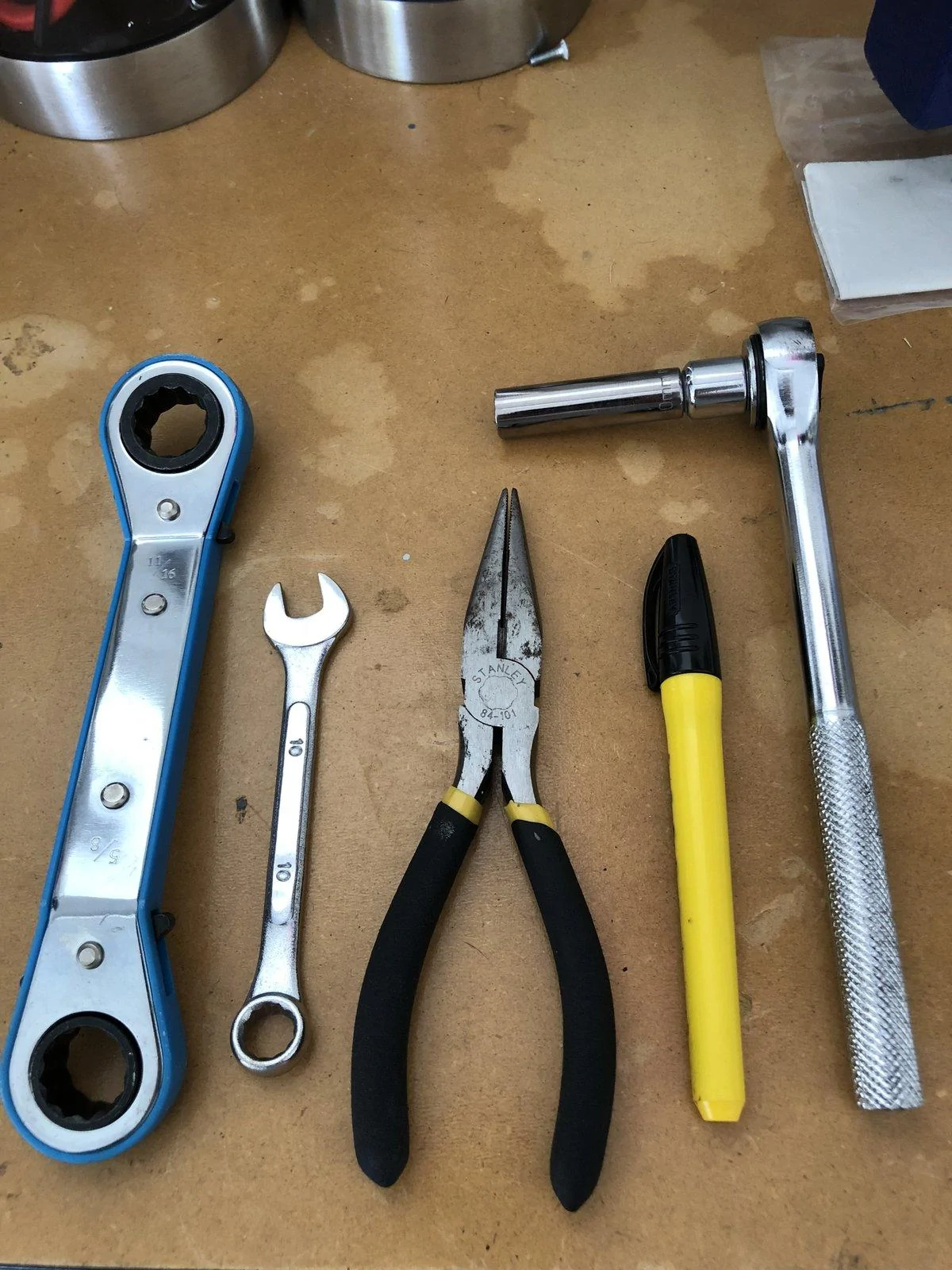

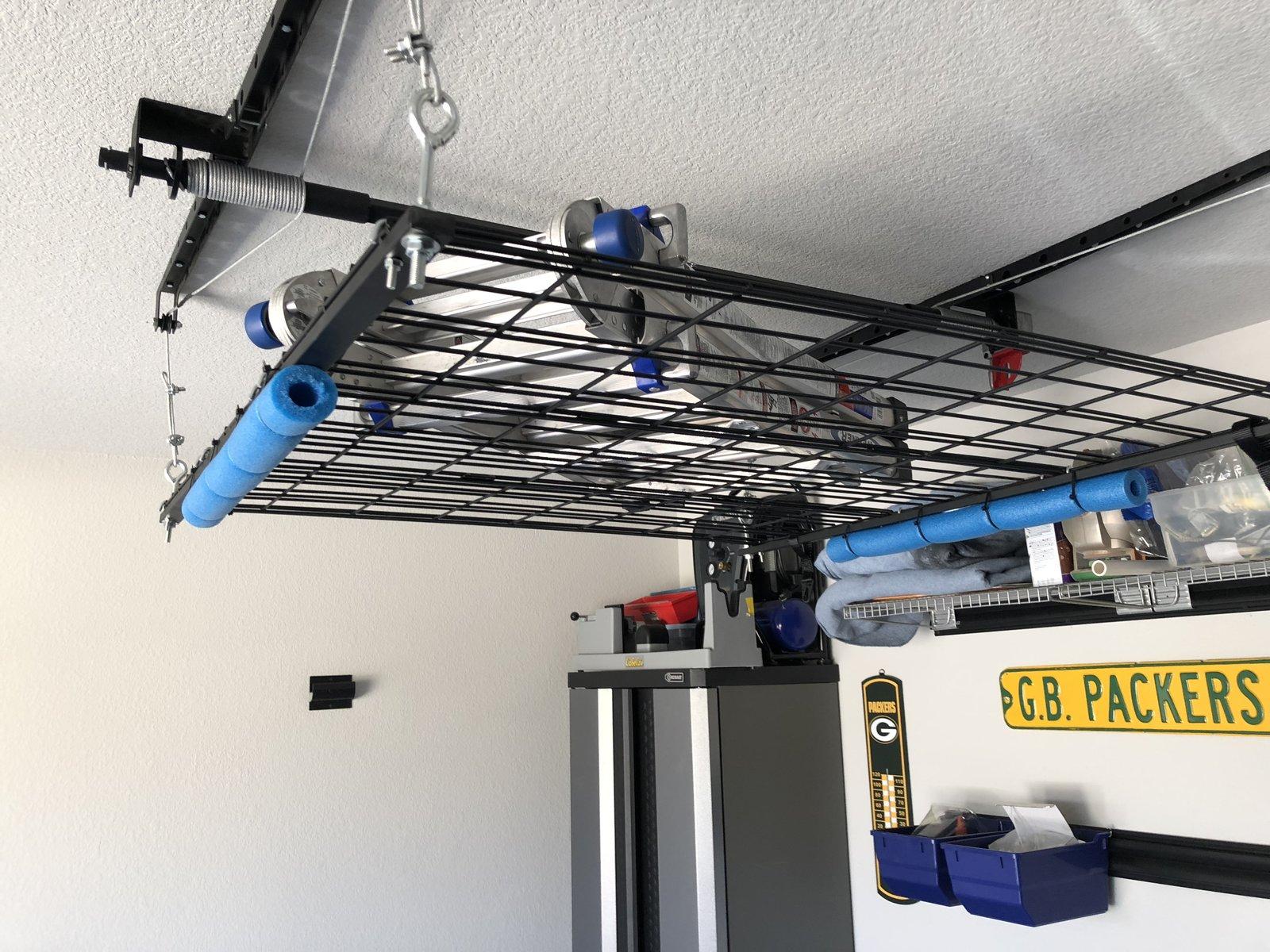

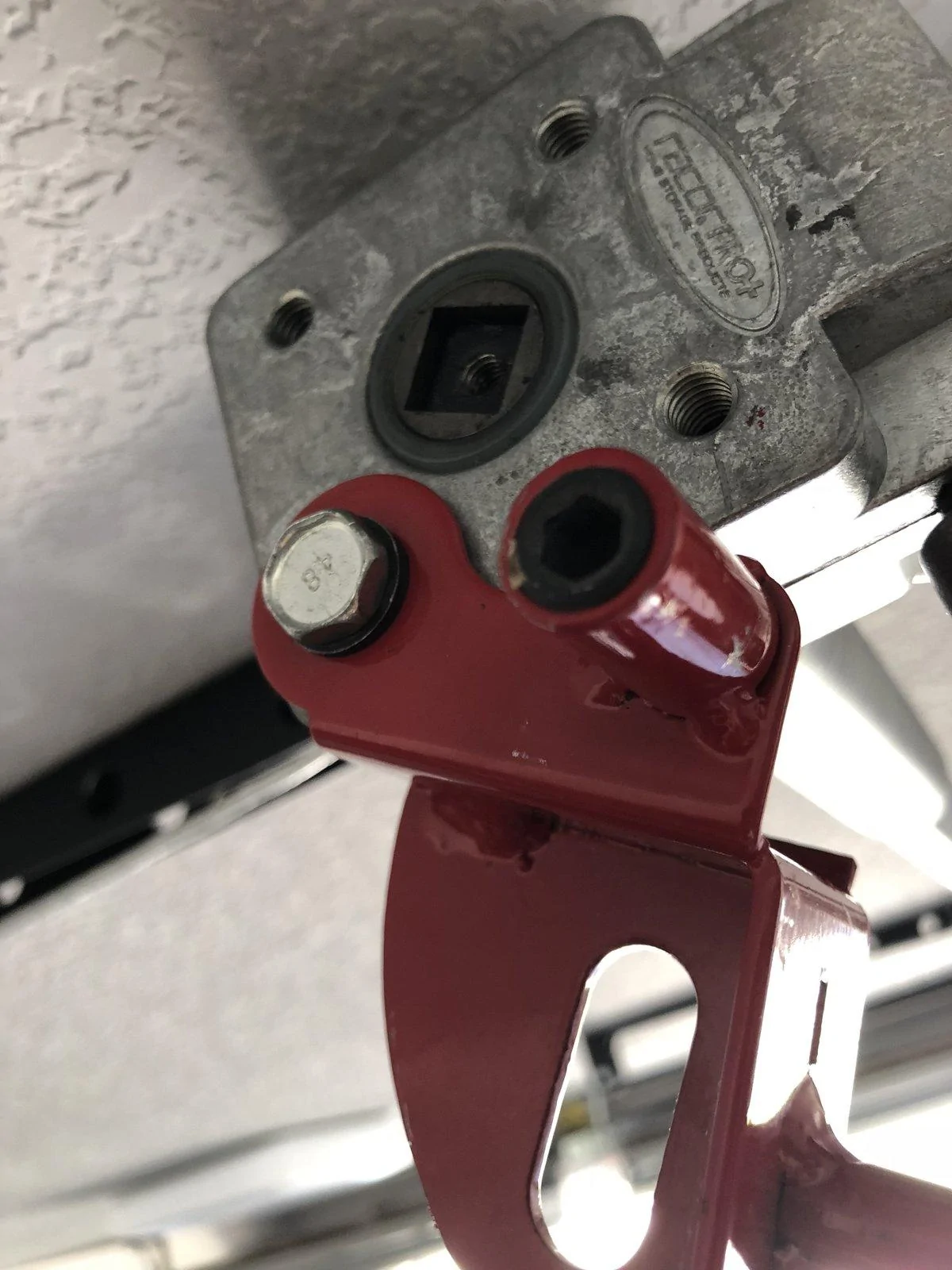

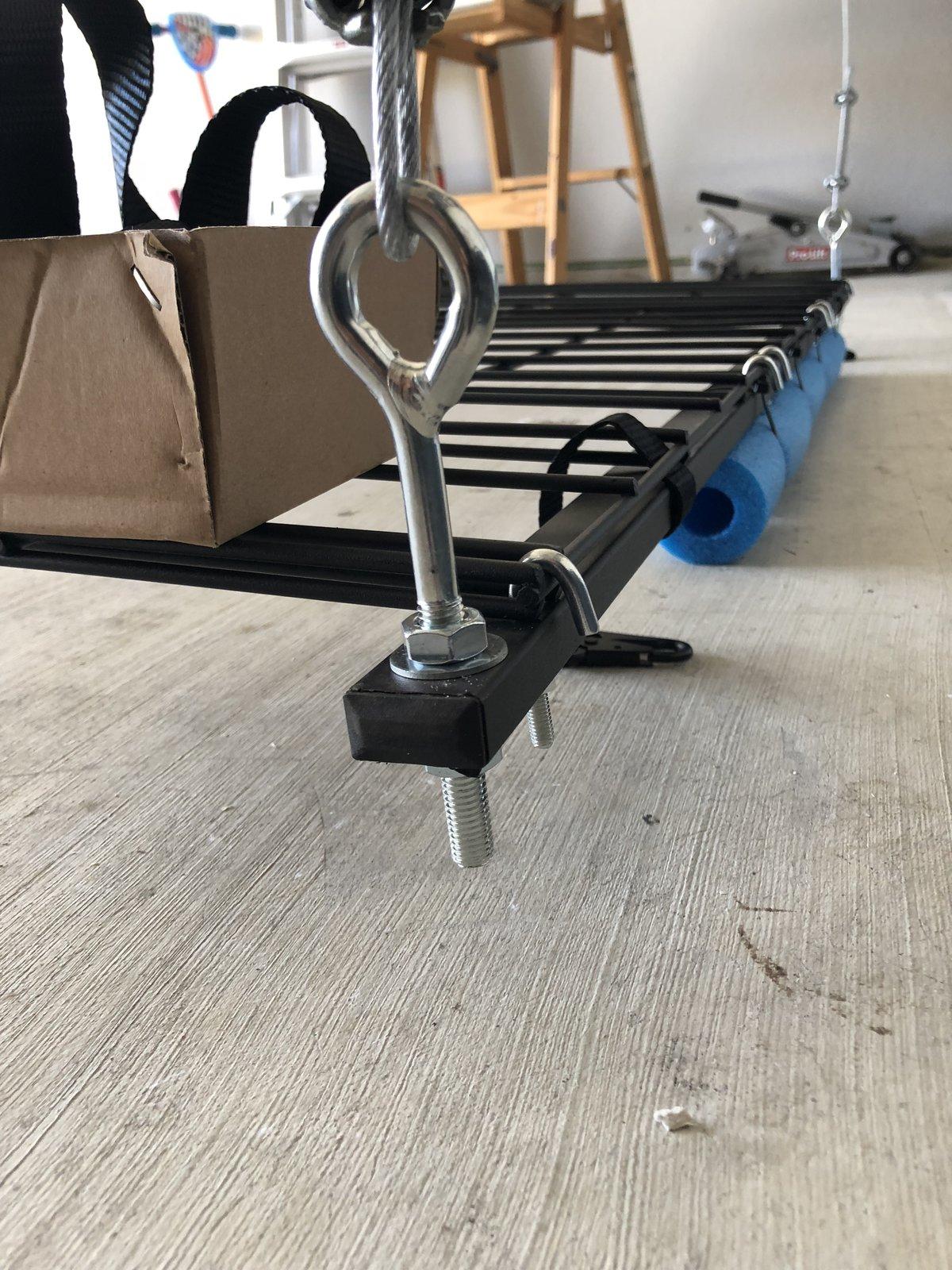

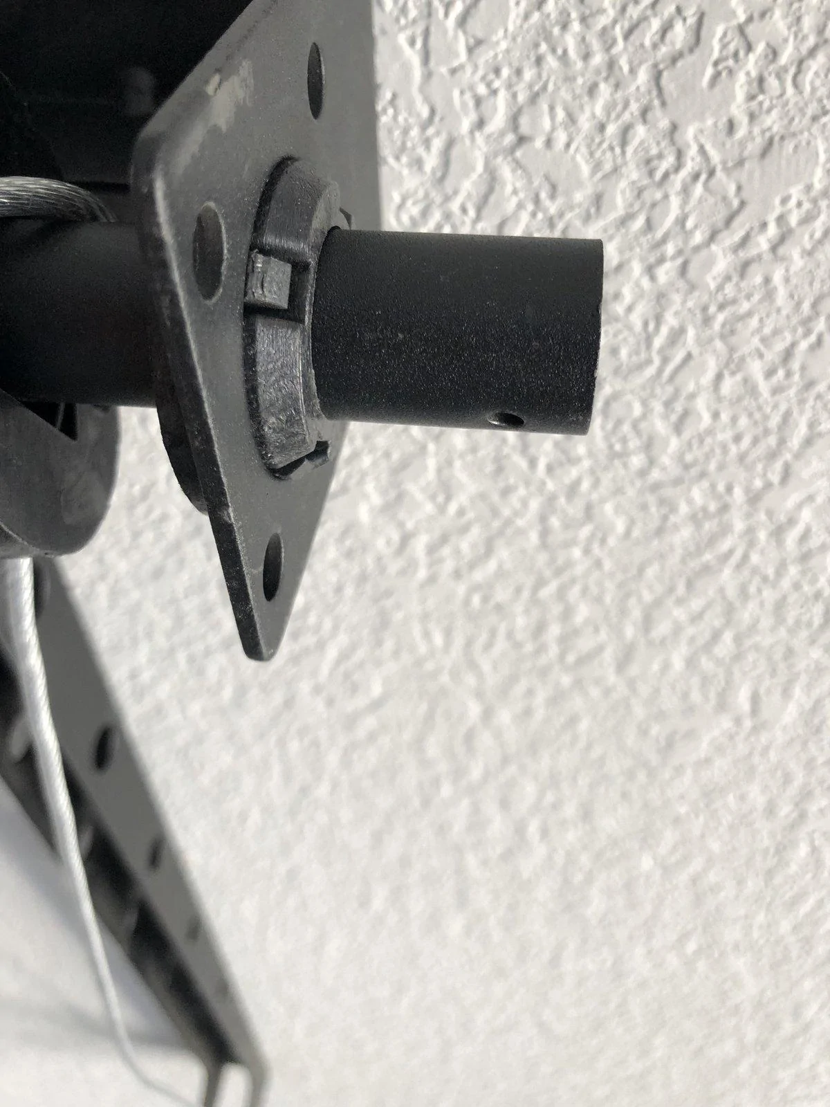

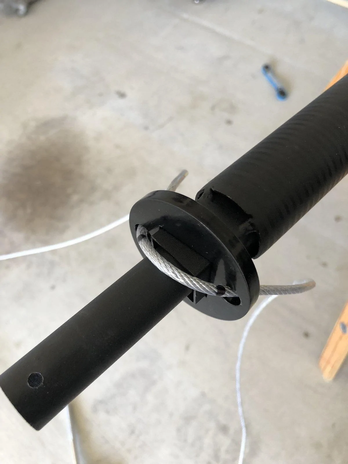

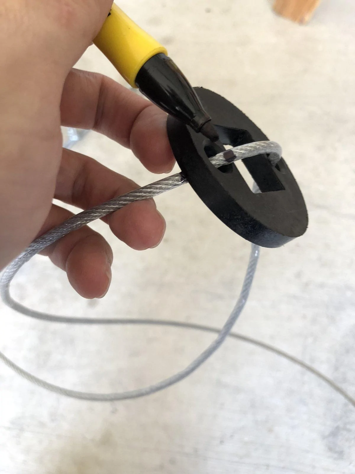

I’ll post a better description in a DIY section, but here’s a summation of the install for the Topsy metal ends that replace the Racor plastic ones:
First- a much needed update. They are far more sturdy and even a tad thinner. Makes me feel much better about the support.
Install is simple. A big time saver is to mark the placement of the current plastic pieces. This allows you to slide the new ones to the exact spot they were prior and save yourself a lot of time leveling it.
From there, reverse your steps from the last bit of install all the way to the part where you separate the middle bar.
Super easy, even taking the time to take pics and decide best course of action. I do know these are somewhat pre-production, but I believe they will have them ready soon. Once they do- I would definitely say it is a worthwhile update and one that might make you sleep better at night :)

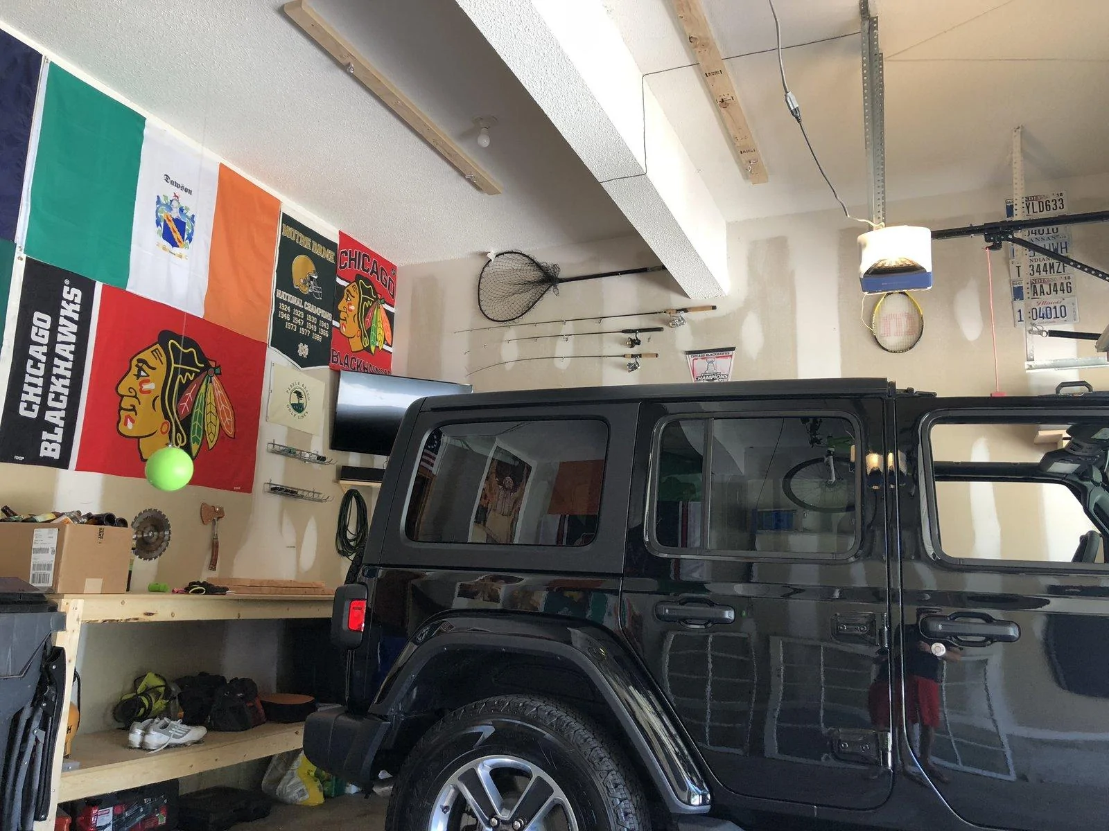

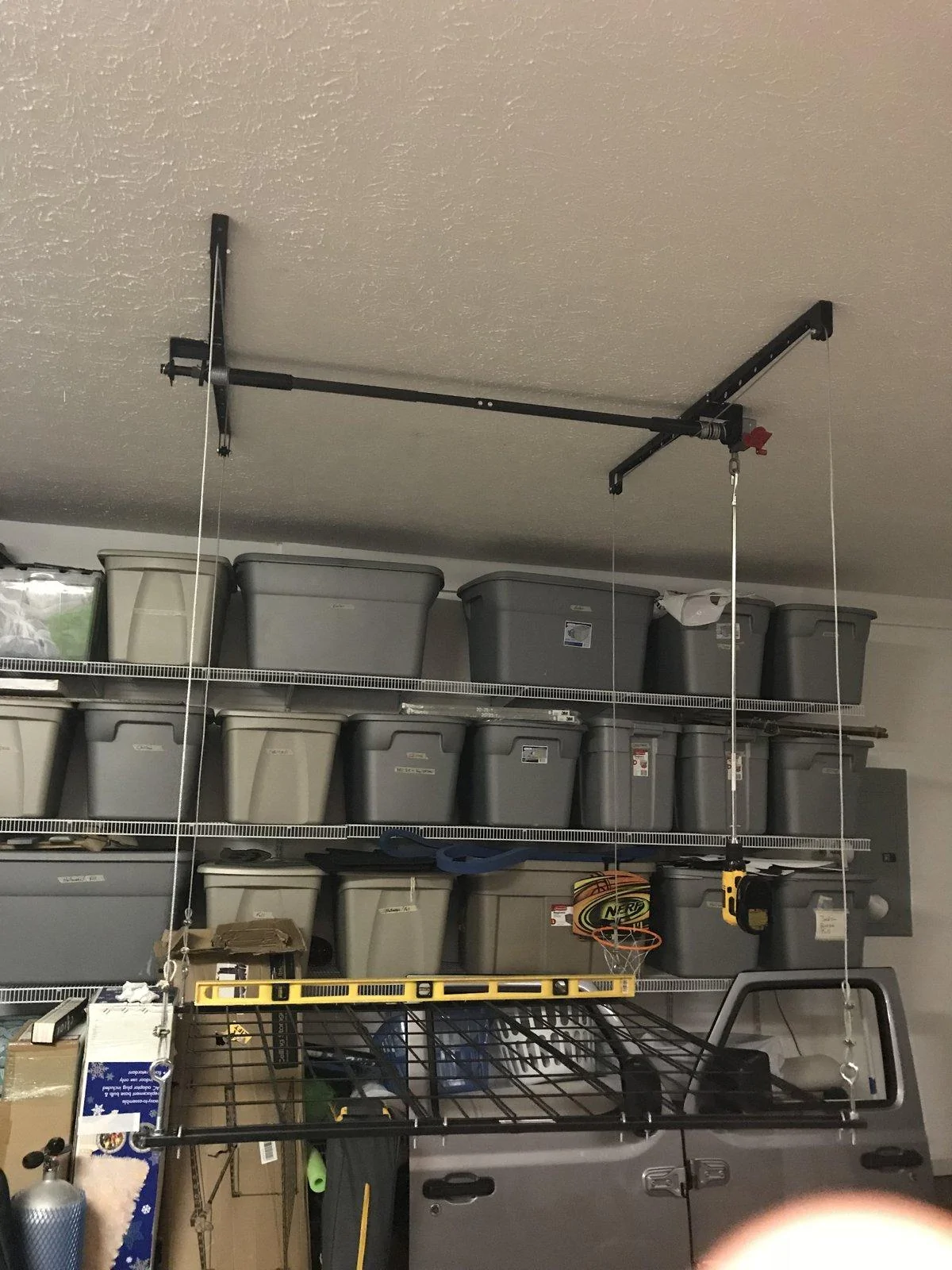

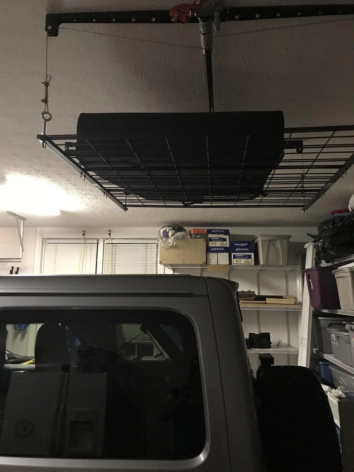

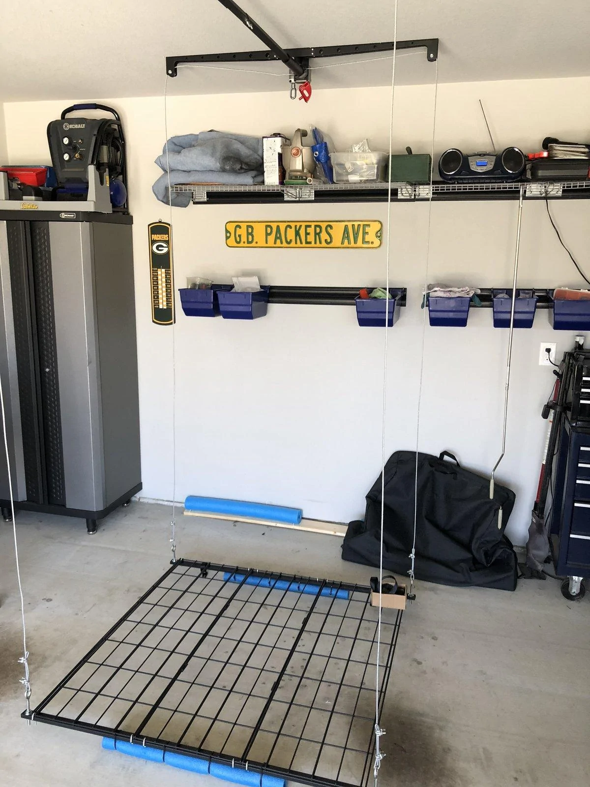

Racor lift installed! Now just need Topsy to get their act together
Maybe it's just the angle of the pics but it almost looks like your Racor needs to move forward about 1.5-2 feet so that you have room to back up to the point where the back edge of the Racor is right about the hinge area of the top. Or is it just an illusion and you have the room to back up that much further than is shown in the picture?
