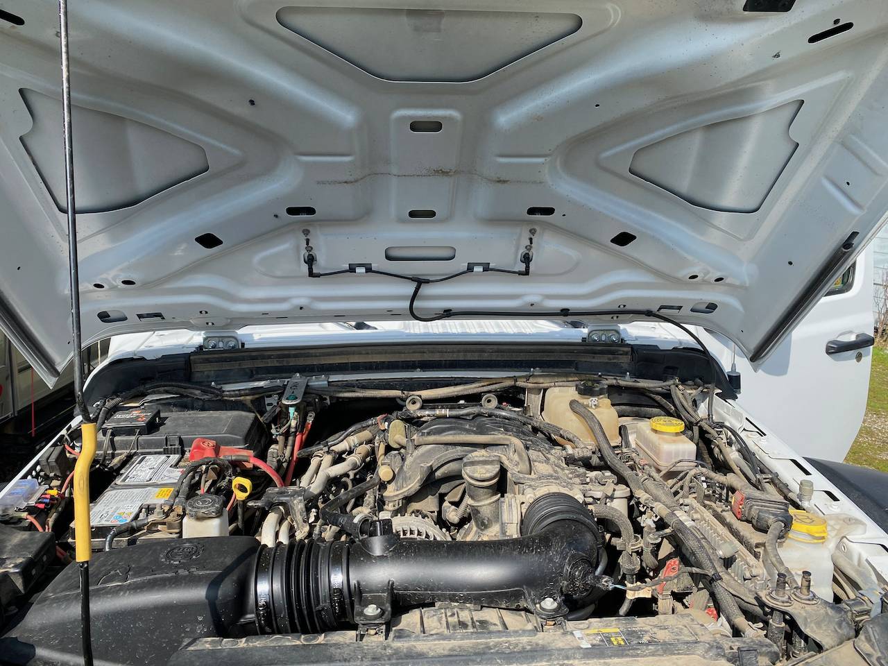

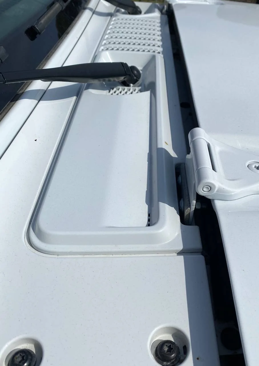

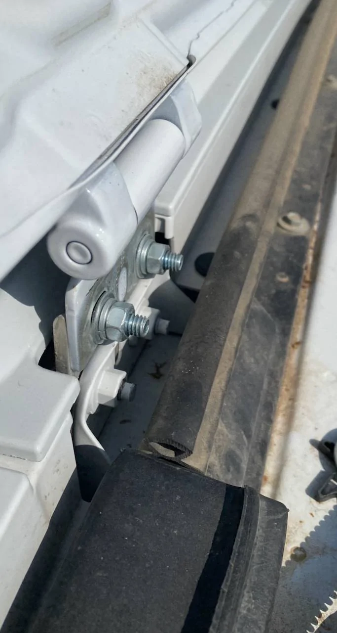

My 3.6,auto. was having temperature spikes during trail rides. I swapped in the JT grill mesh with it's greater free area for air movement. Removed the underhood sound liner and engine cover, which improved air flow to the rear raised hood gap created by raising the hood hinges.

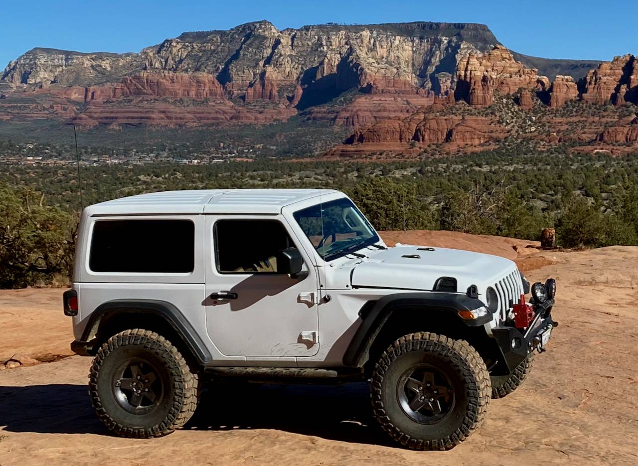

This lets the underhood heat rise out instead of forcing it down and out through the chassis. It works well. The radiator fan very seldom goes to high and only happens when extreme off-road crawling up a steep grade with A/C on.

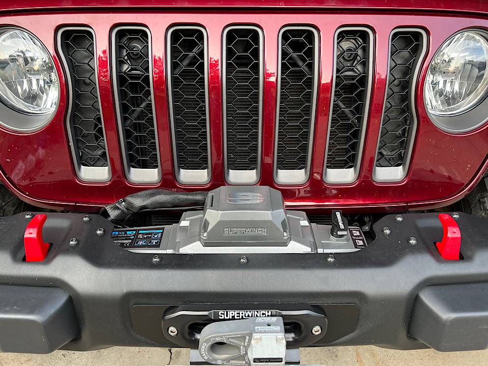

Winch, hi-lift jack and lights do not seem to be an blockage issue. Lack of air flow out from under the hood seems to have been the issue.

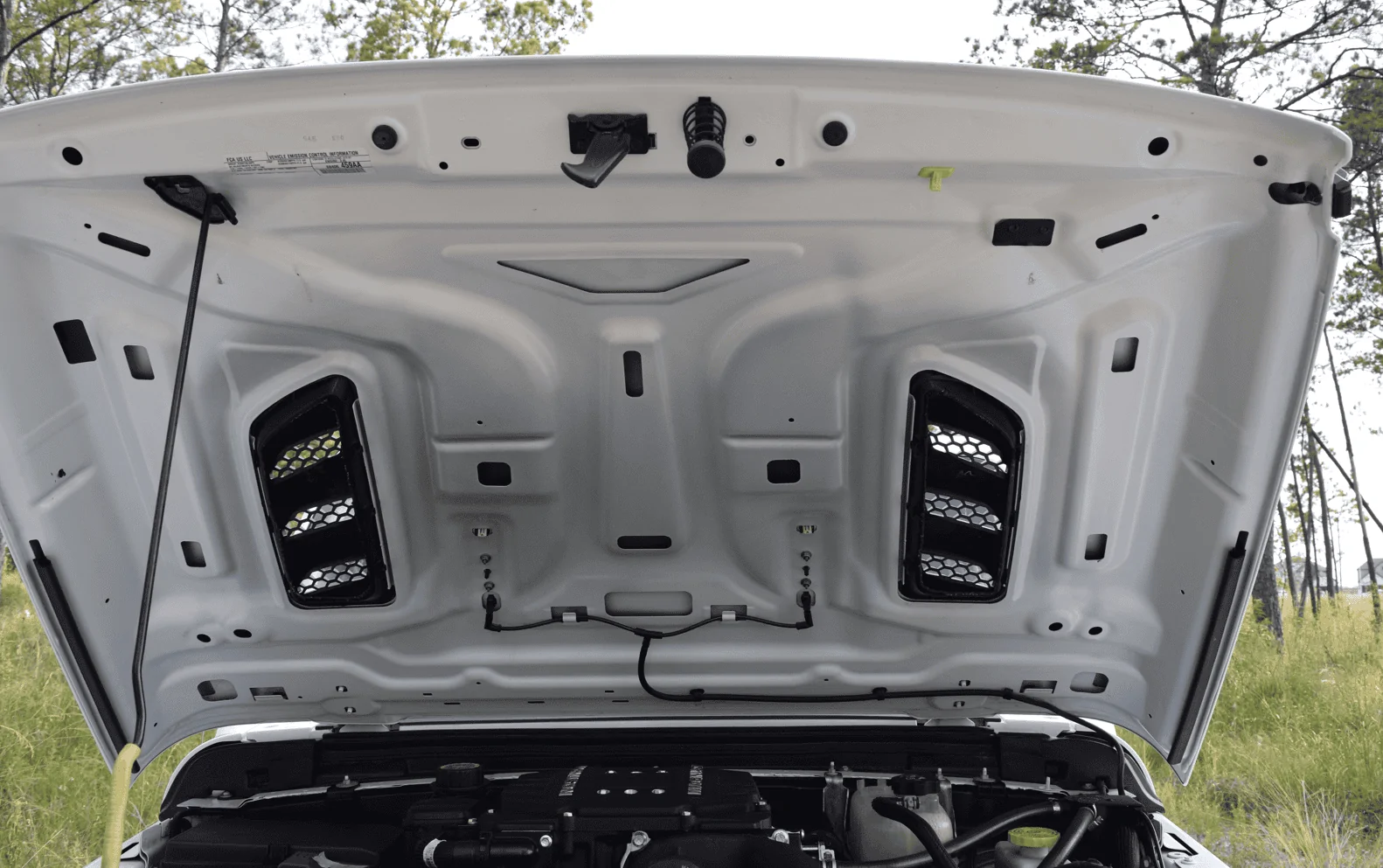

This is not answering your question, but related. But I'm in Houston and it's hot here too. I'm going to toss my hood liner in the trash and cut open my vents. That will help a lot too at slow speed traffic. I'm doing this not just for the radiator, but also the A/C cooler and trans cooler. I'm also going to swap to a Gladiator grill with larger openings. I've already ordered it.
This is a picture from my 2019 JLUR with the 3.6L Supercharged engine. I now own a 2023 JLUR with the 2.0L Turbo
