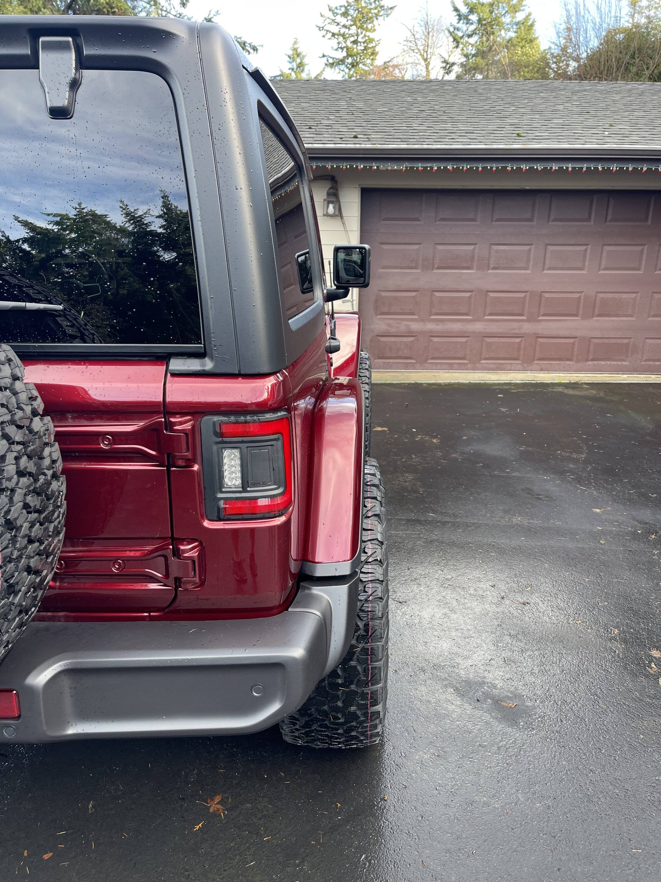

I just moved to 315s (12.4in wide) and new wheels with less offset. They poke a bit. I think it looks good. Feels more 'planted' as well. Does dirty the Jeep more and I will likely try adding the XR fender flare extensions.

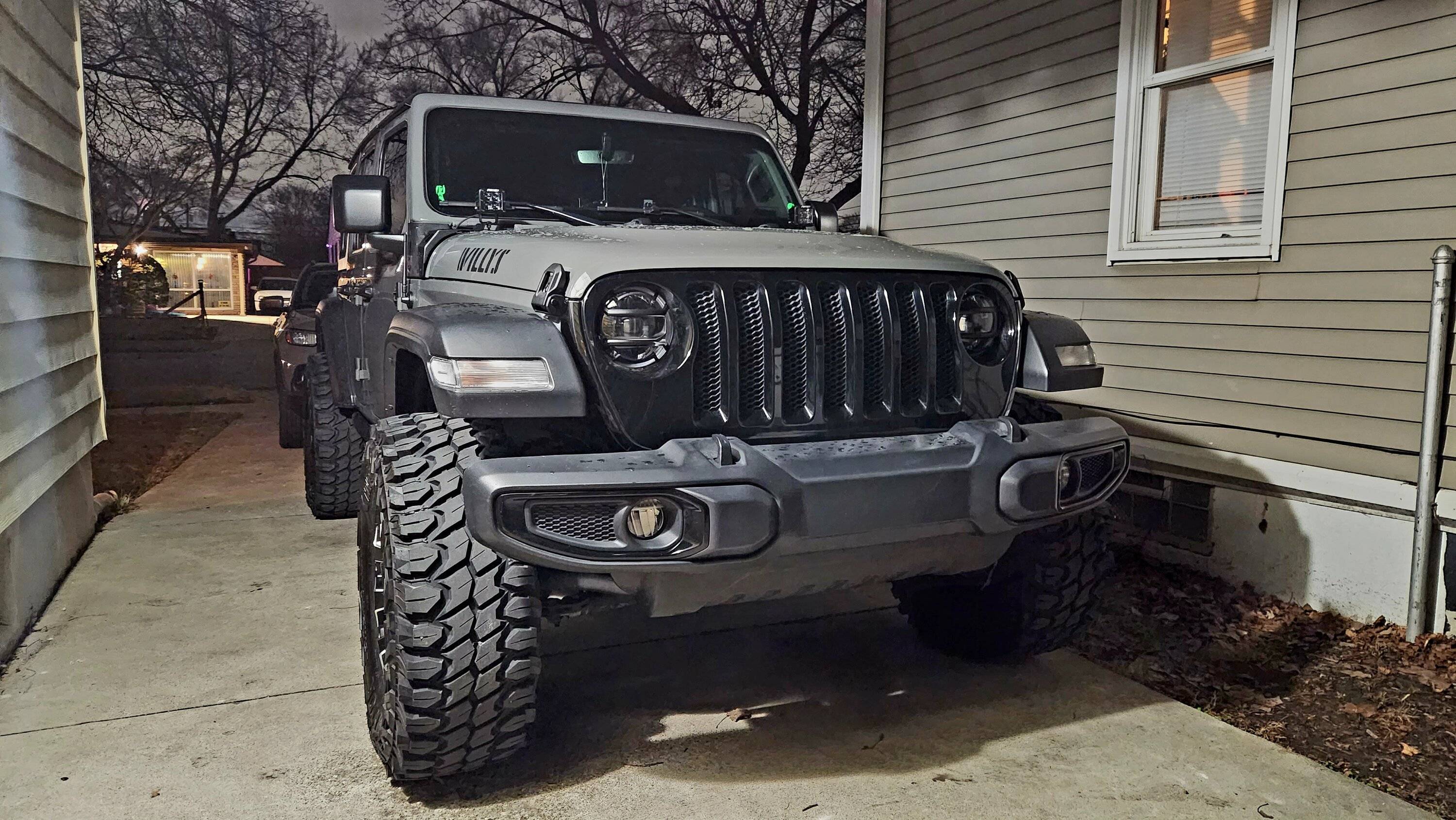

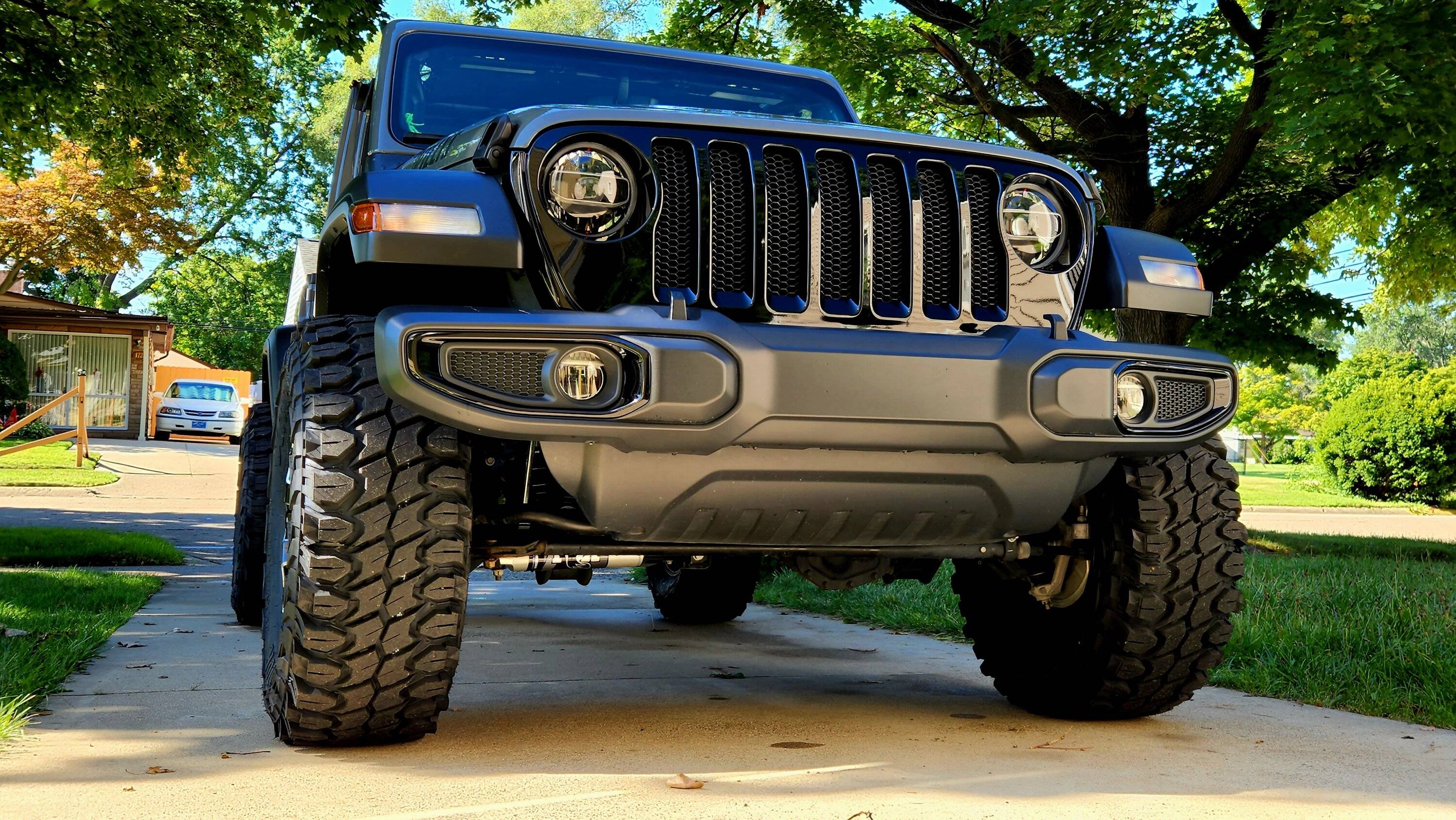

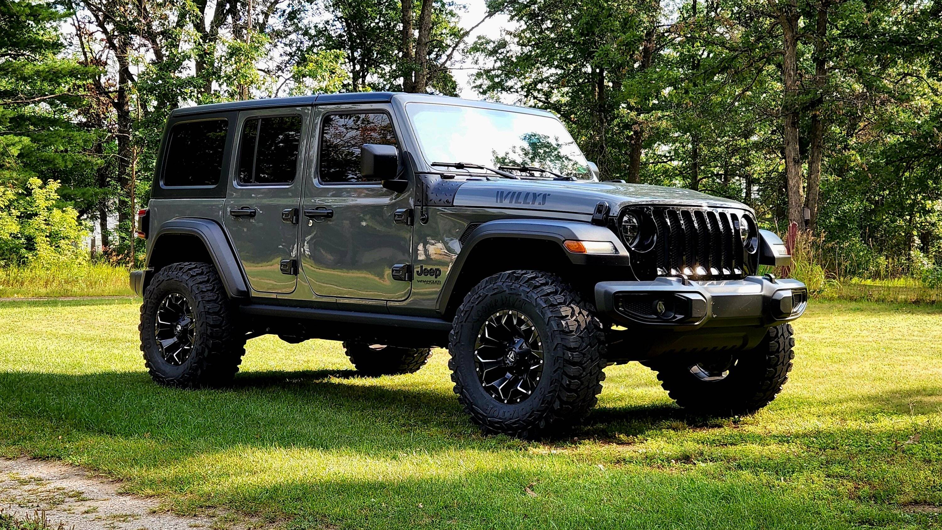

Mine poke a little.. I wanted a slightly wider stance but not overkill. Mine turned out pretty much exactly as I hoped.
Jeep Wrangler JL Tires sticking like Alfred E. Neuman's ears 20220811_101102
Jeep Wrangler JL Tires sticking like Alfred E. Neuman's ears 20220811_101000
Jeep Wrangler JL Tires sticking like Alfred E. Neuman's ears 20220815_093325
Jeep Wrangler JL Tires sticking like Alfred E. Neuman's ears 20230118_104100
Jeep Wrangler JL Tires sticking like Alfred E. Neuman's ears 20230120_211620
Jeep Wrangler JL Tires sticking like Alfred E. Neuman's ears 20221001_151119
