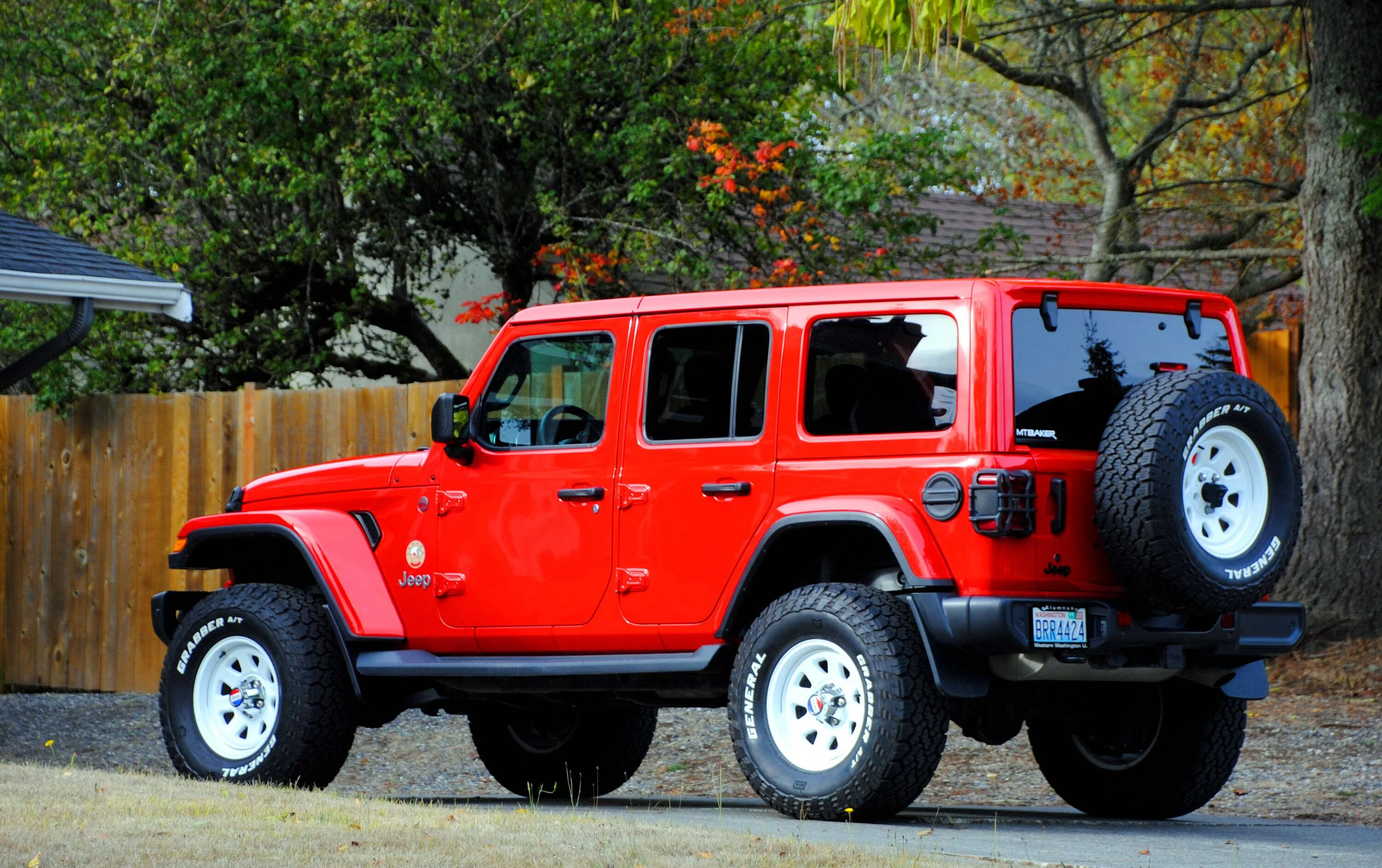

Have a set of 35x12.5 General ATs E-load on my Sahara; keep them at 30 PSI. The Jeep rides comfortably.
