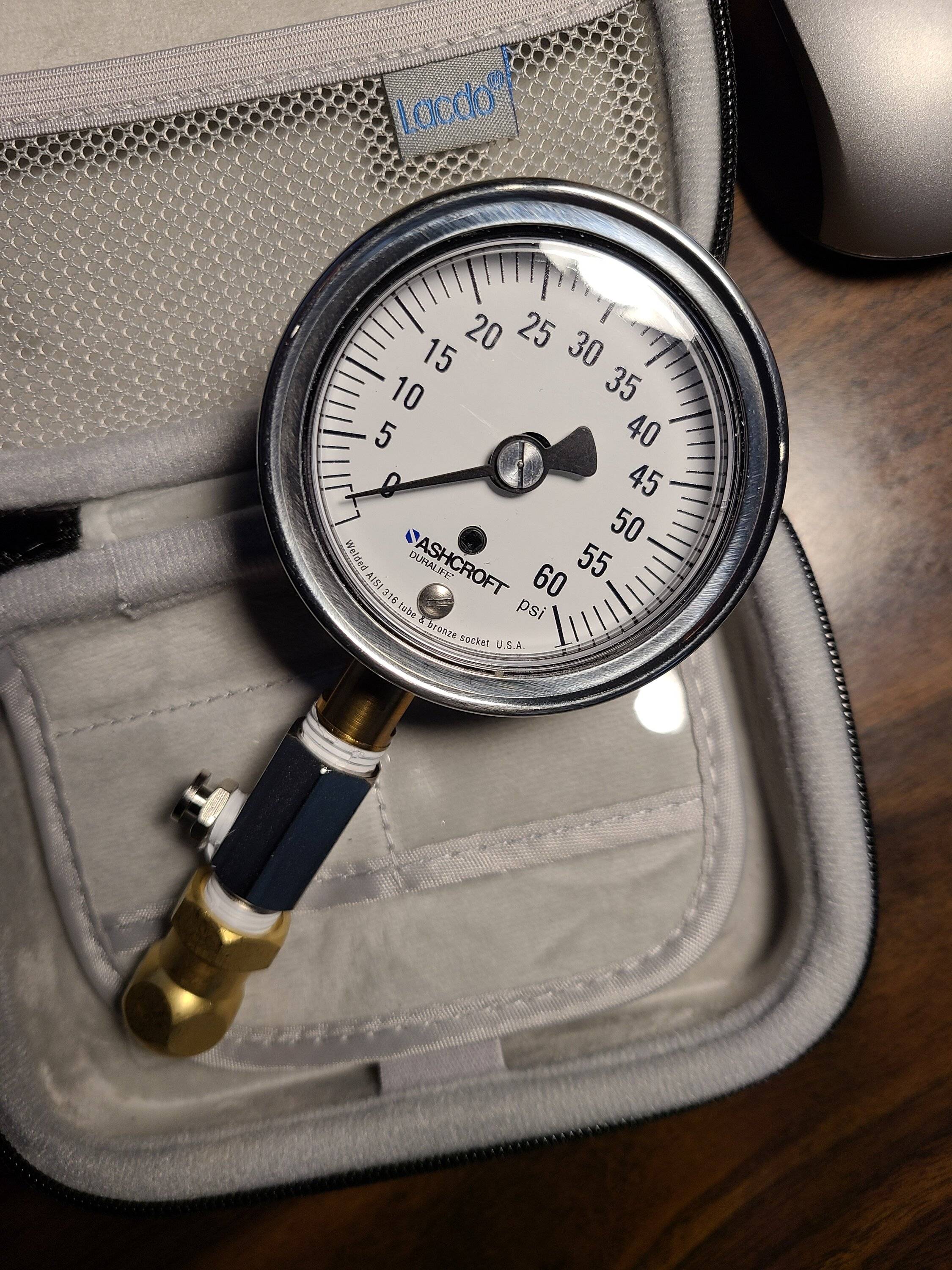

I wrung my hands over this topic of "an accurate tire pressure gauge" until I about pulled the skin off.
I read all I could find on available tire pressure gauge accuracy claims and was still frustrated.
So, I bought a lab quality industrial gauge that has an advertised accuracy that was acceptable (grade 1A +/- 1% of scale). Then I made my own tire gauge. You can buy the fittings on Amzon.
FWIW, I've found TPMS on my GMC and Jeep to be very accurate.
Ashcroft Process Pressure Gauges - Overview (ashcroft-gauges.com)
Jeep Wrangler JL Tire Pressure: Who's Right? 20220628_090944

I read all I could find ... then I made my own tire gauge.
You are my kinda guy. In the end - was it worth it? Do you get better (more accurate) readings with the Ashcroft?
"Was it worth it?" Of course not. LOL
"Do you get better (more accurate) readings with Ashcroft?" They're easier to believe. ;)
I guess what I learned from all of this was that: if the gauge is reasonably close to the actual pressure, but repeatable, it's a good gauge. This is because we're all approximating the tire pressure we need. If I start running crazy low pressures, I may make a 0-15 psi gauge.

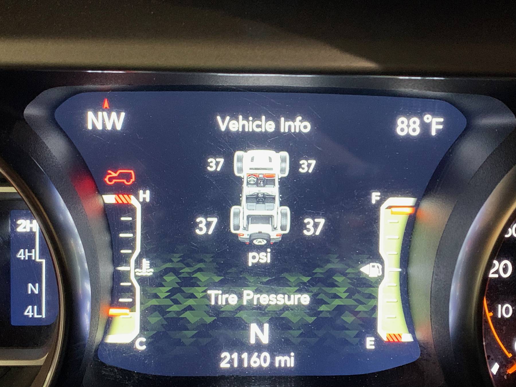

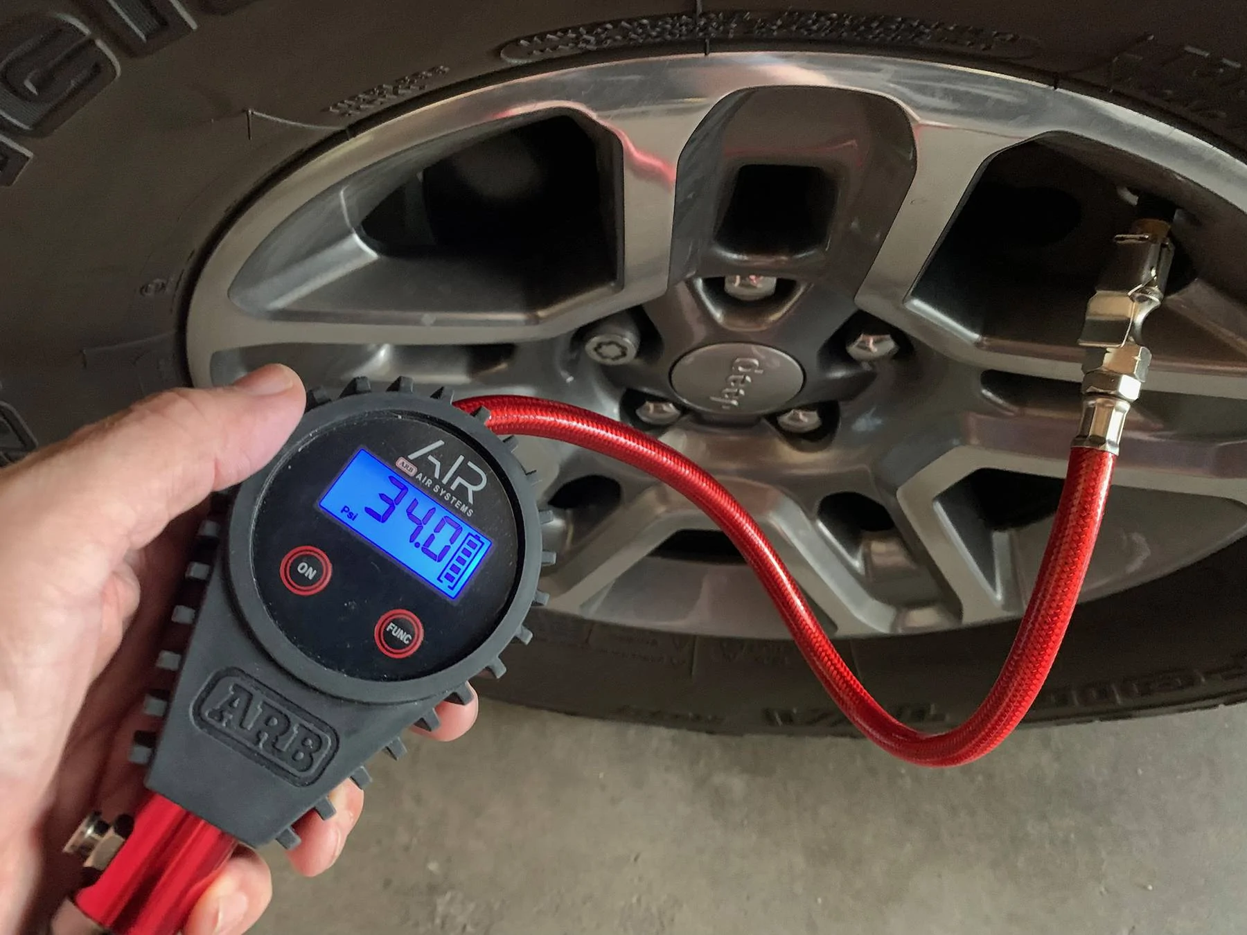

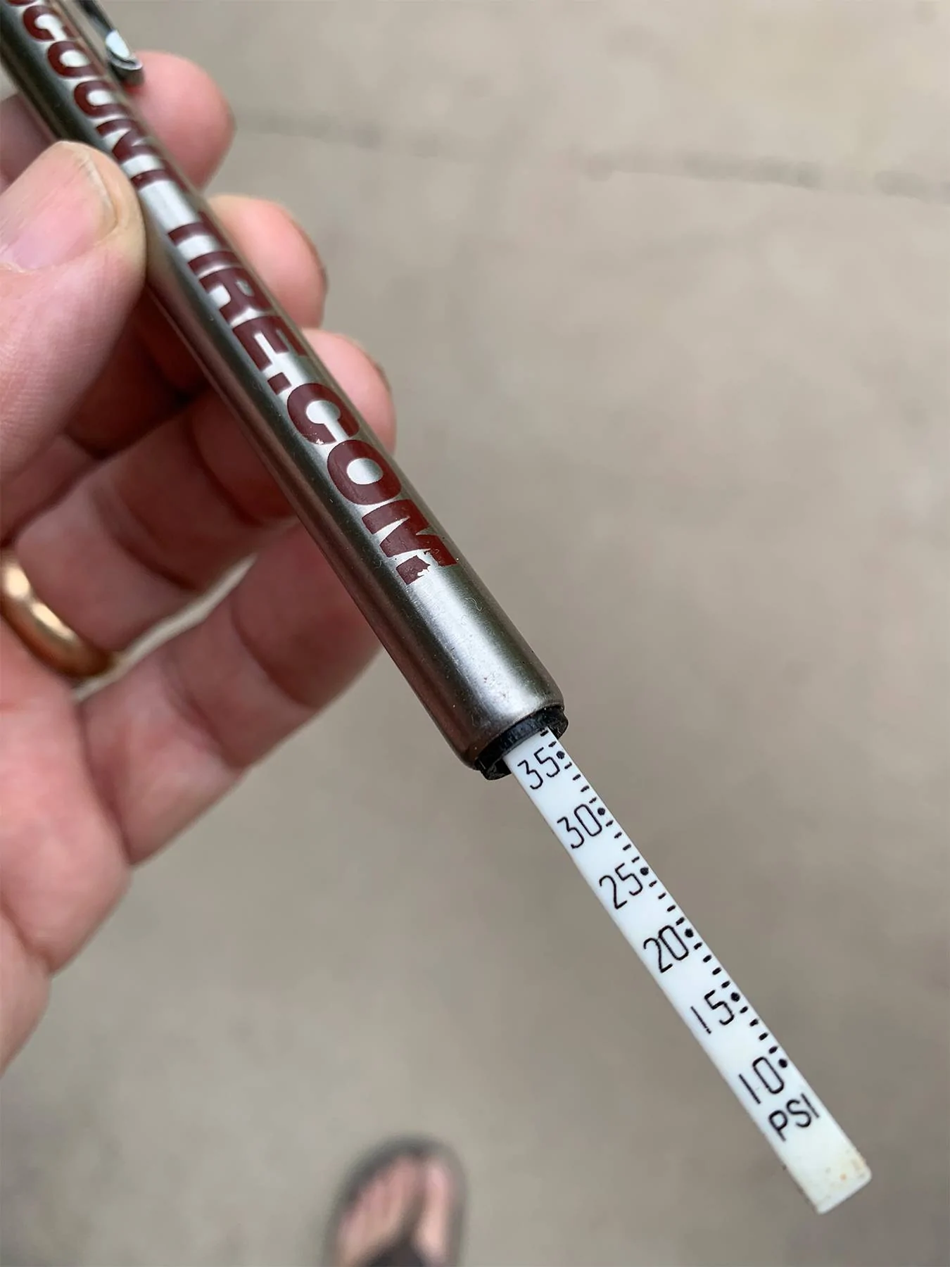

Well, here you go:
Jeep Wrangler JL Tire Pressure: Who's Right? The Boss Says
Jeep Wrangler JL Tire Pressure: Who's Right? ARB
Jeep Wrangler JL Tire Pressure: Who's Right? Discount Tir
And it's @DiscountTire for the win.
To be fair - the Discount Tire stick was inconsistent - sometimes shooting up to over 40psi, sometimes reading 37. But... it did't cost $67 and it agrees with the Boss.
I can live with knowing ARB is 3# light and work it from there.
