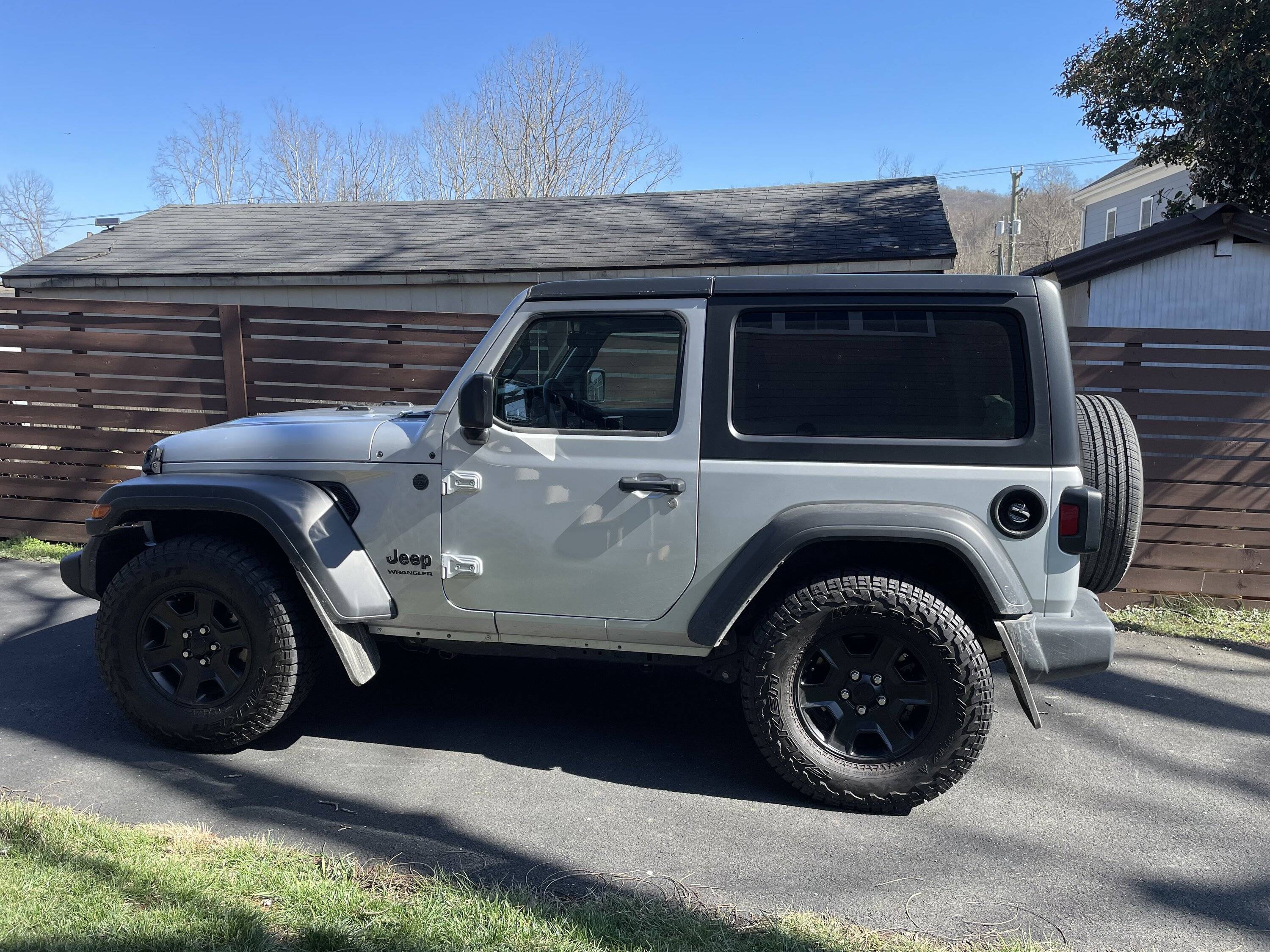

33s will fit. Here’s my gfs wrangler on my Gladiator Mojave take offs (no lift). They are a metric equivalent 33”
Worth noting that those Falken Wildpeaks on the gladiator wheels are HEAVY. Like 91 lbs a corner. Idk what the stock sport wher and tire weighs but it has to be sub 50 just based on changing them and slinging them around.
