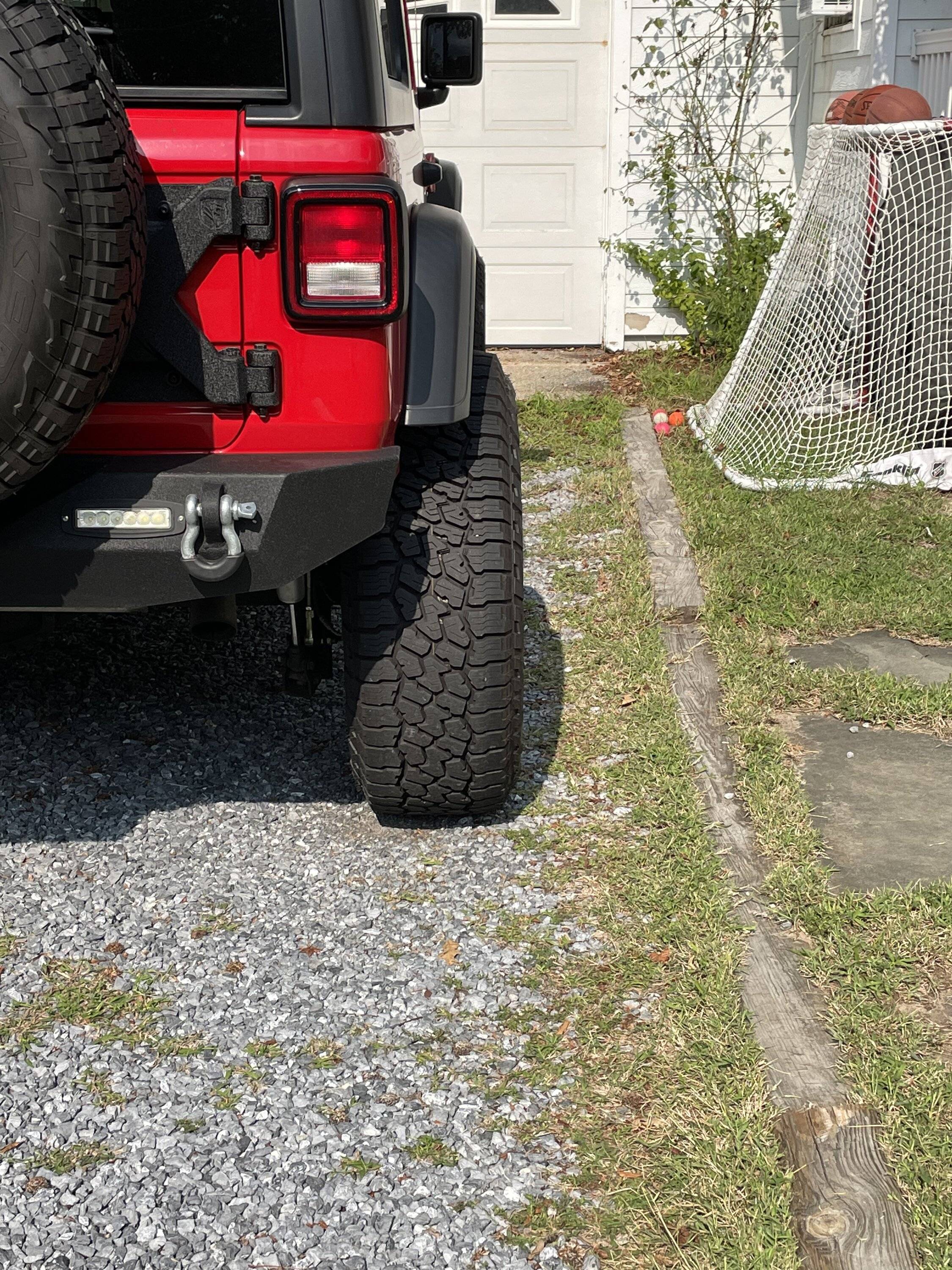

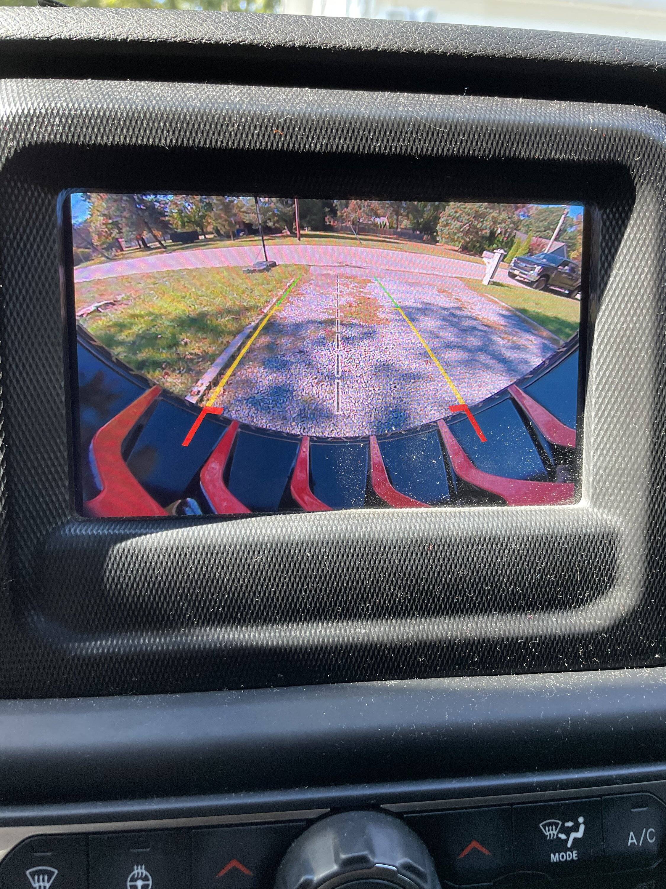

2018 JLU
I went -18/4.79 on different wheels. Lots of poke but no rub whatsoever with a 3&1/2”lift. Only issue is rear camera makes me think I’m looking through the gates of hell.
