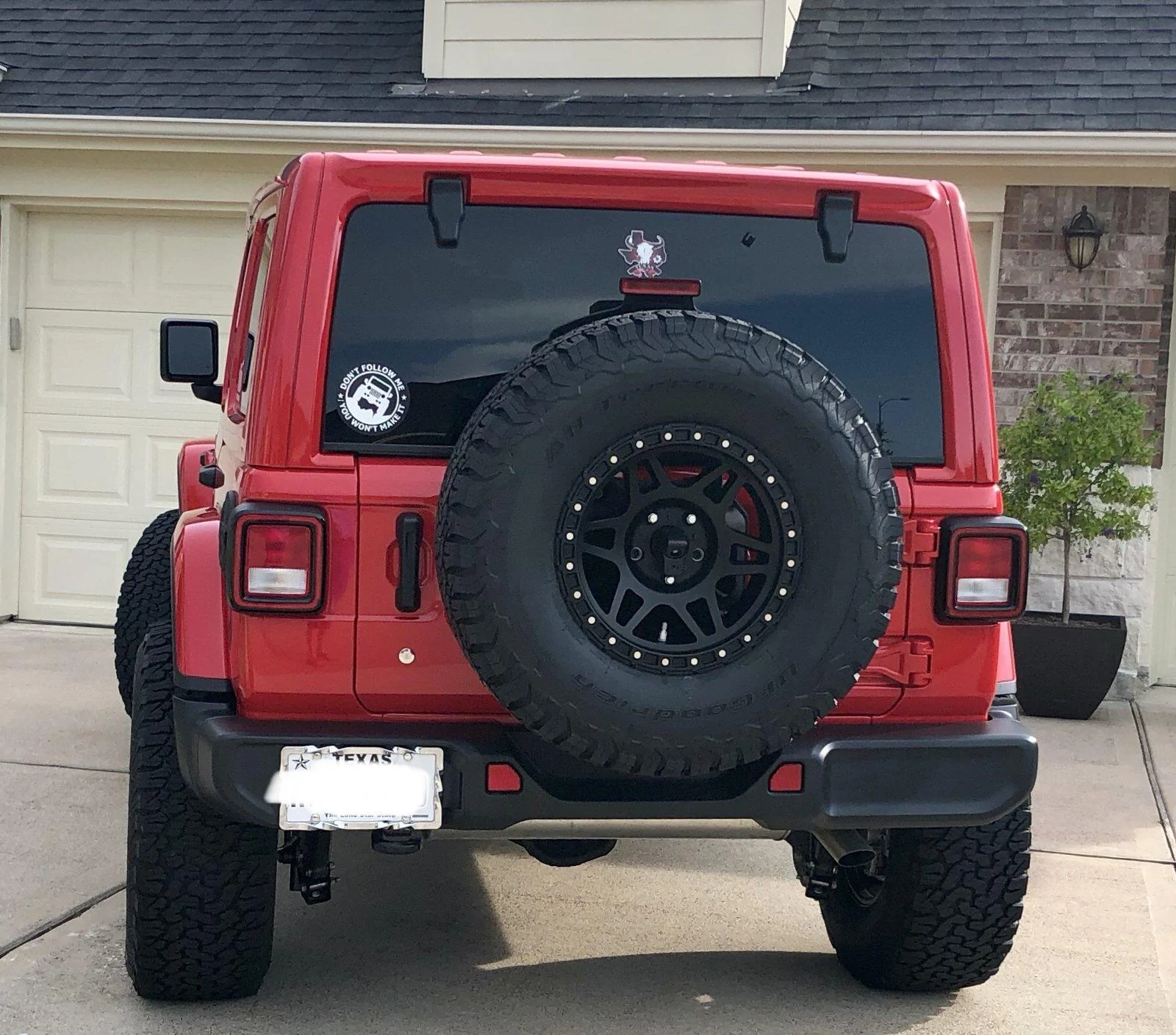

I have Method 312 wheels that have pretty much the same specs as yours and running 315 KO2’s on a JLU Sahara and a Sahara axels are shorter than Rubicon axels and my setup sticks out close to 3” or it appears to be close to 3”

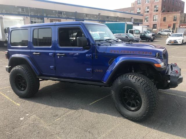

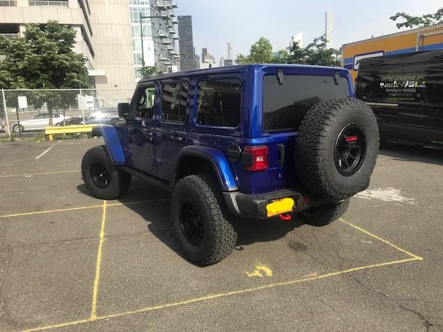

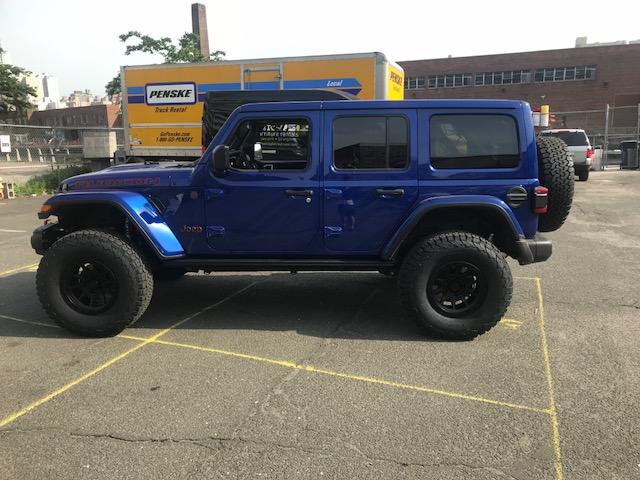

I’m running American Racing ATX 202 17x9 with -12 offset & Mopar lift. 37x12.50 KO2. Couple angles here. I think it gives the Jeep a really good stance. Only “downside” I’ve had is that the side of the Jeep gets a lot more dirty because road mud/water spits up outside the fender well.
