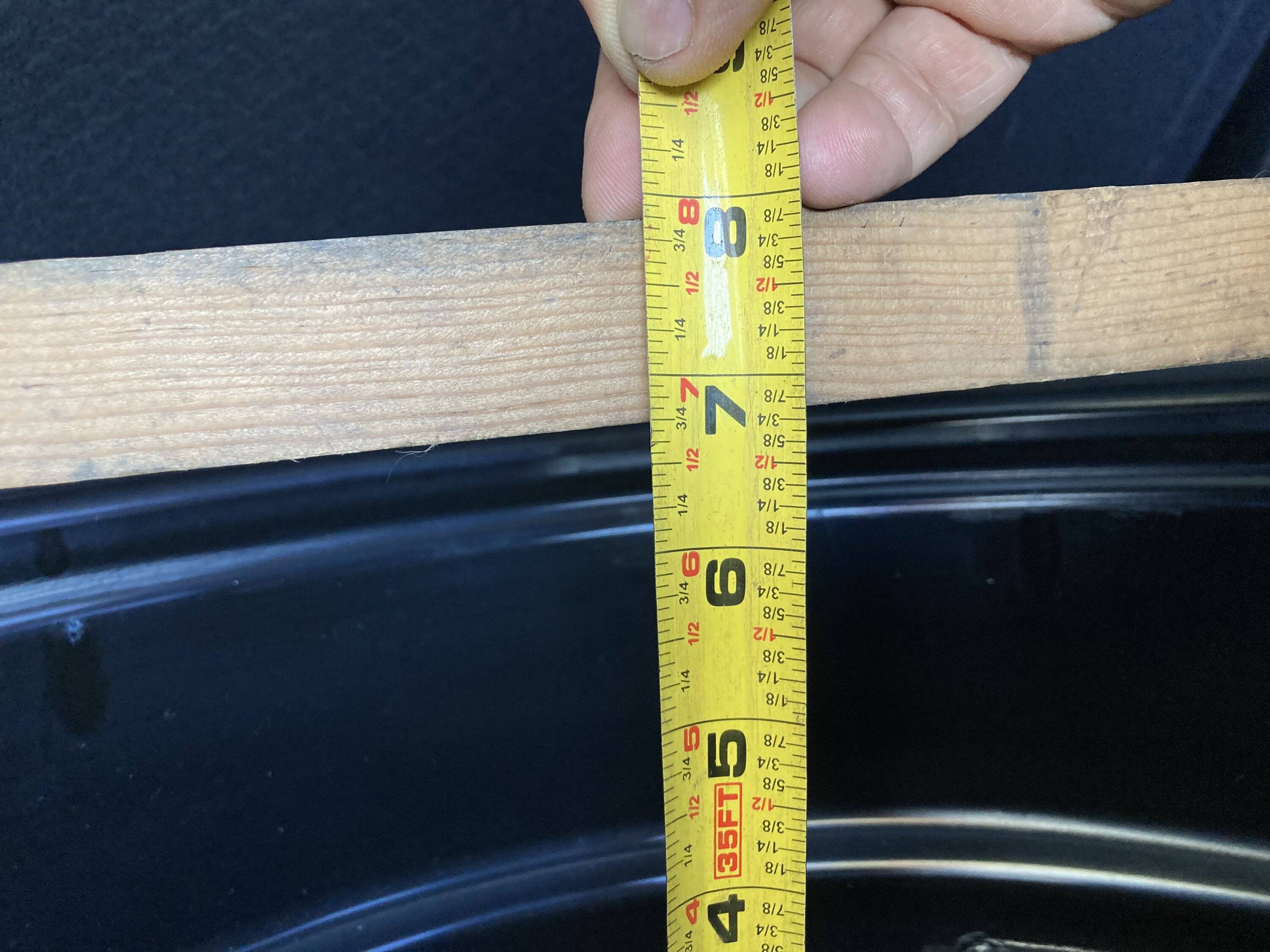

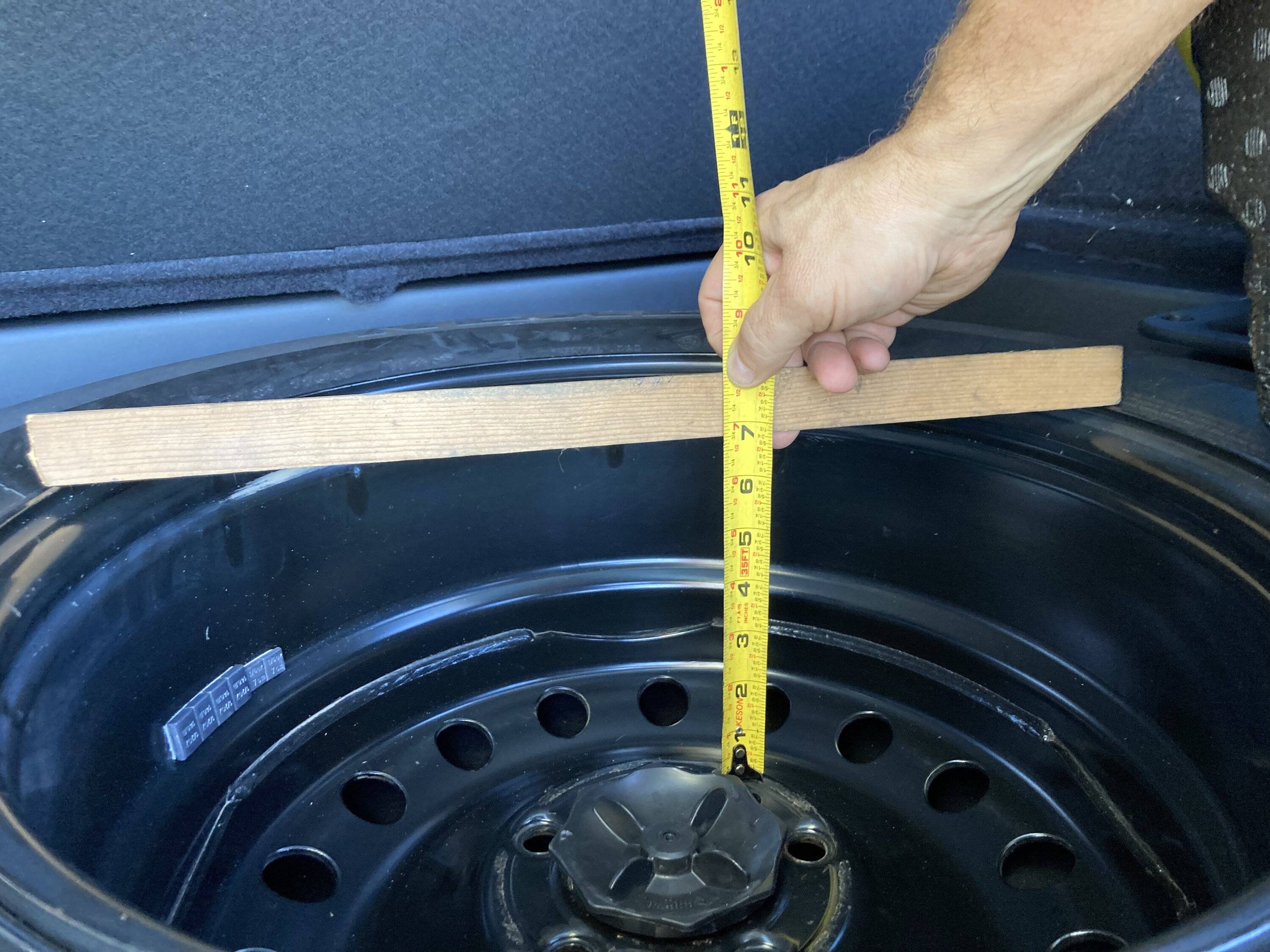

Good info. The wheel sizes listed here is advertised width, not measured width.
An important detail that can get you crazy when math doesn’t add up in a particular calculation.
(attached example of measuring back space).
[edit:spelling]
Jeep Wrangler JL Help with offset math B058BF24-0DE2-4C57-A518-E56A453CC8E7
Jeep Wrangler JL Help with offset math EA2DD9E8-18F9-42CC-8189-A3516CF24F65
