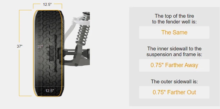

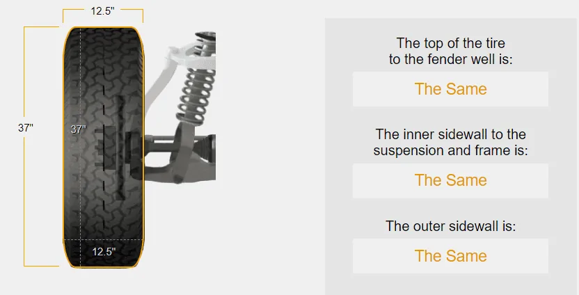

I'm not personally a fan of using backspace. In the majority of our builds tire sidewall is the controlling clearance point. While wheel width does impact section width to a degree (industry standard is 0.2" in overall tire section width change per 1/2" change in wheel width) that really needs to be added/subtracted regardless of whether you locate the tire with BS of Offset.
Since offset directly locates the centerline of the tire, it's a good static locating metric. Backspace is dependent on width, so you can't locate the tire without knowing the width.
Just for an example of why this can be frustrating, let's look at the difference between using backspace and offset. For ease of calculation, let's use a baseline of a 8.5" wheel with 0 offset /4.75" backspace.
Change to 10" width, but maintain 0 offset:
Change to 10" width, but maintain 4.75" backspace:
In both cases, the change of wheel width would impact the section width the same. Using a BFG KO2 37x12.50R17, their data shows a 13" section width on a 10" wheel, so you'd want to consider that in your use of the tiresize.com offset comparison if you are comparing changing tire sizes with the wheel change. Using the industry standard, the section width on the 8.5" wheel should be closer to 0.6" thinner, or just over a 1/4" more clearance either side with the 8.5. I don't put a ton of weight in the standard, but at least gives you an idea.
Great illustrations!
Changing the wheel size while maintaining the Offset (and tire size) will only affect tire bulge (within reason).
Changing wheel size while maintaining BS and tire size will affect tire poke and bulge.
Most who look for wheel upgrades also change their tire size.
It also appears as there are typically two main concerns owners have. The Off-Roader is mainly concerned about suspension and fender clearances during suspension articulation; while others may have be more concerned to comply with laws regarding wheel/tire poke (depending on region or country they live in).
