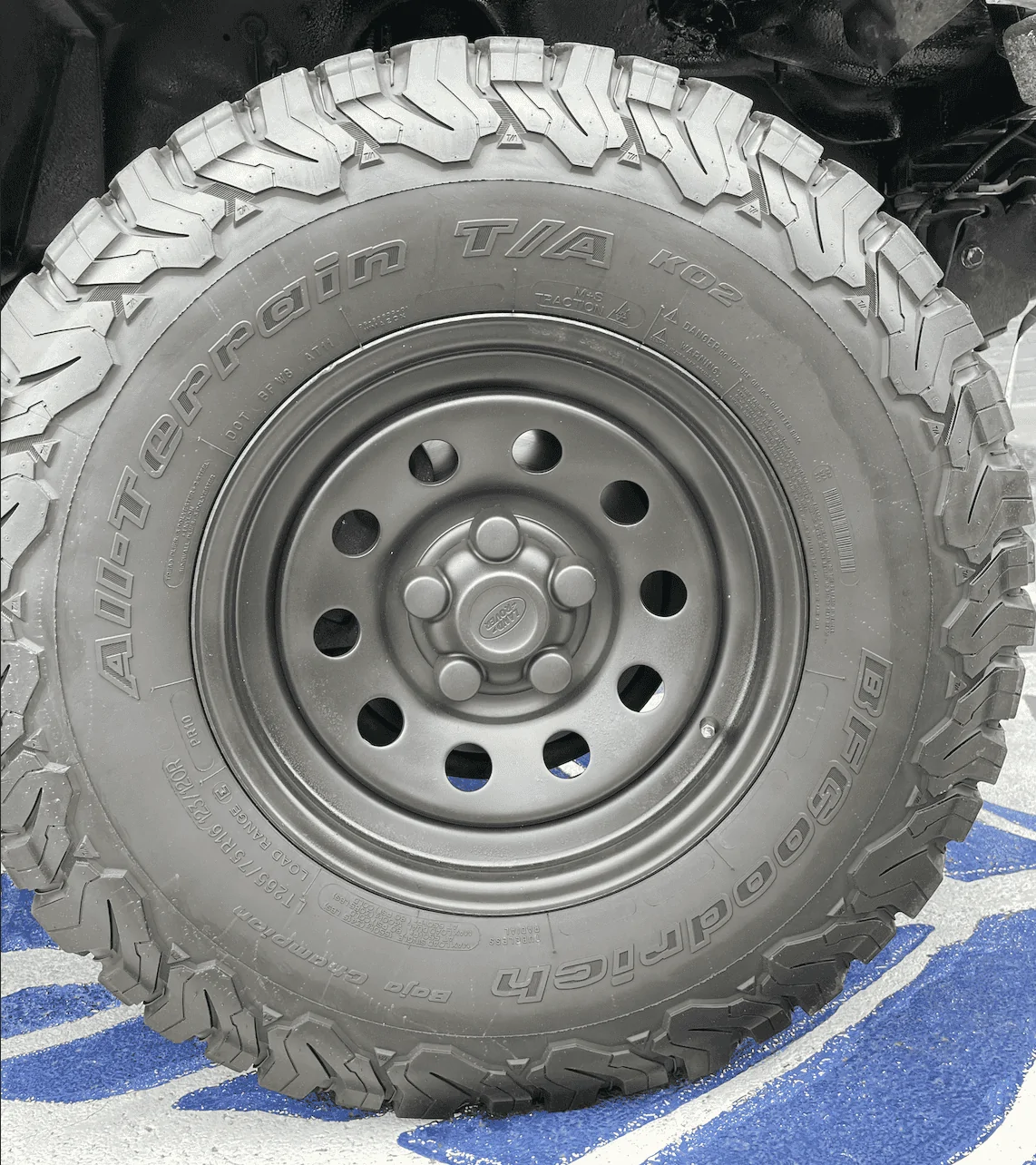

3. I've heard that the tires in the attached photo (BF Goodrich K02 / All-Terrain) are great all-around tires. Agree? Worth the money? Any other worthy suggestions for a 75% ON road / 25% OFF road tire with a slightly more aggressive look than stock?

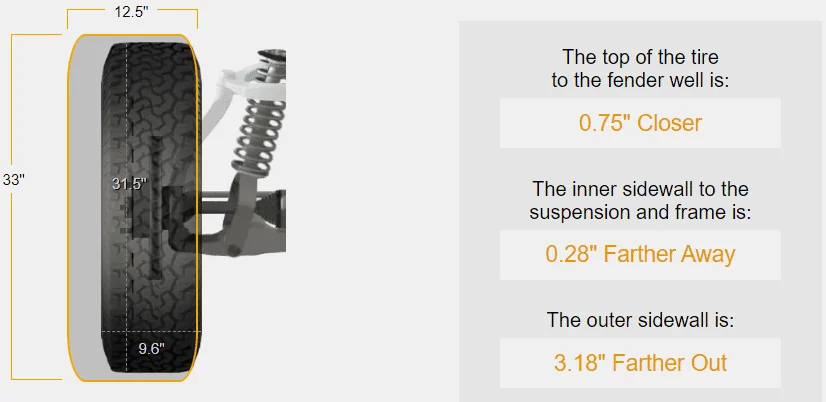

1. I DO want a slightly more aggressive stance - so if I get some ProComps with 0 offset - will these stick out a little bit more than my stock setup?
Assuming 33x12.50R17s:
Jeep Wrangler JL Help make my wheel choice easy? 1652817575577
https://tiresize.com/wheel-offset-calculator/
Yes, Yes, there are a handful of other decent options, Falken Wildpeak, Toyo AT3, etc.
