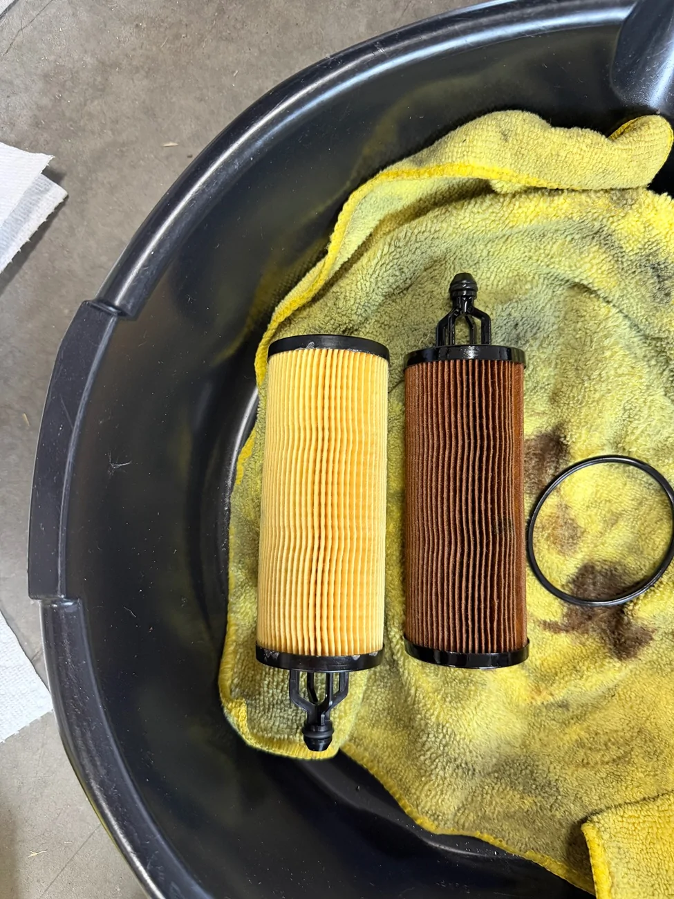

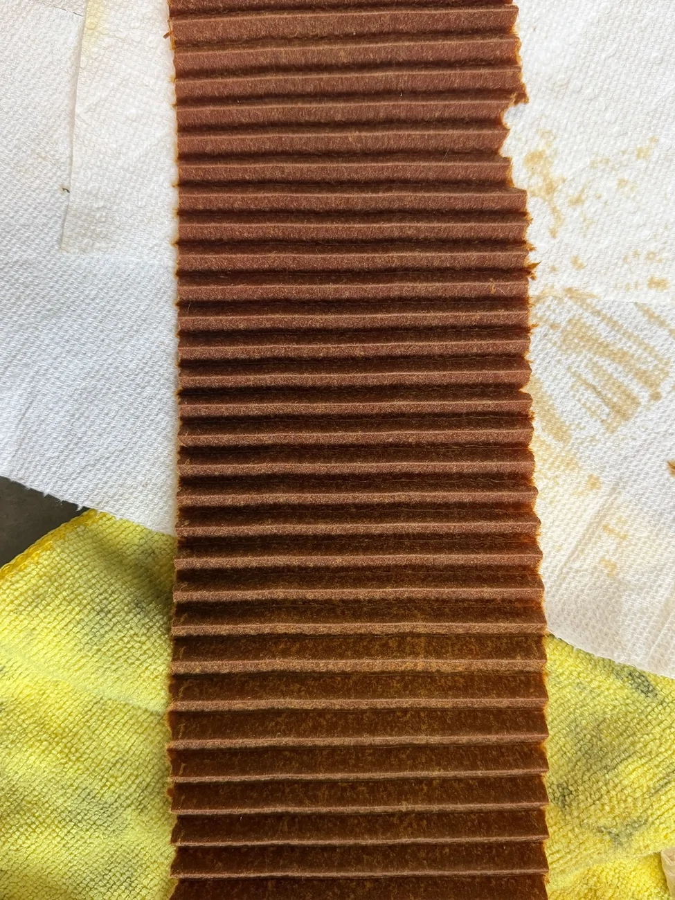

first thing I would do is change the oil and cut the filter and check the pleats for signs of metal...how many miles on your vehicle? find a trusted independent repair shop if you don't have the ability to do it yourself..check google for reviews..maybe take a recording and post it.
I have approx 83000 miles on it, I just had the oil/filter changed, i am not sure if they unfolded the pleats to check. It appears that I and anyone that i ask does not know a trusted/good mechanic. lol. But I will check out a mechanic near me that has many good ratings. I called a different mechanic and they said they could check it out, but when i was further inquiring about the problem, they said they will put a jasper engine in it. I didnt want that.
