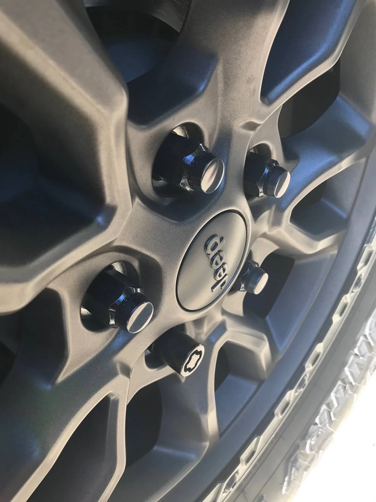

just curious and not looking to derail this… do all anti-theft lug nuts extend so much outwards as the one in the very last pic?
No- those look like the Mopar ones mine came with, designed for easy vice-grip removal. I threw them away and got a McGard full set with locks

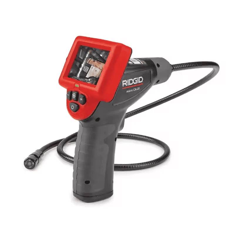

I would just take my time and really pay attention to how it drives and if it pulls left or right when you hit the brakes. I mean there are hundreds of things you could check and first look for the obvious, gaps on all the doors, hood, tailgate. Any sign of screws being removed and leaving whiteness marks from where they were originally at. Make sure that you can have them put it up on a lift for you and bring a good flashlight and a small extendable mirror so you can really see the hard to reach places. I had bought a RIDGID color flexible luminated scope a while back and it has saved my ass when dropping a nut,bolt or any part that automatically goes to never-never land.
