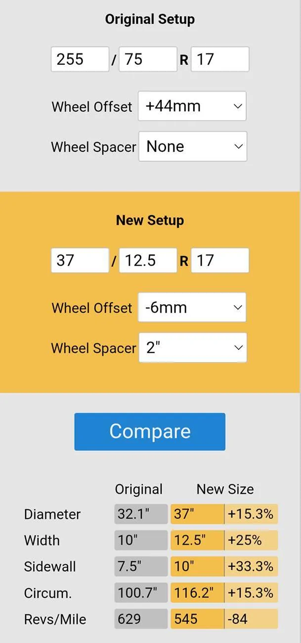

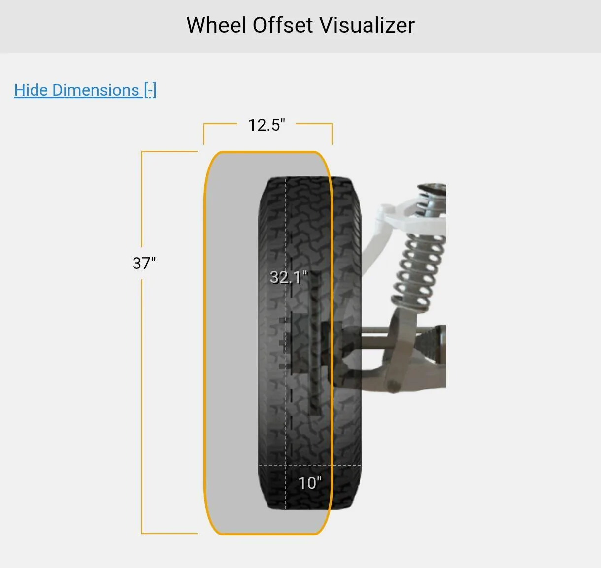

Really just depends on your setup. With my setup in particular these American Iron Ball Joint Deletes will last significantly longer for me than normal ball joints would.
Jeep Wrangler JL The Ultimate Ball Joint Comparison!!! 1000012012
Jeep Wrangler JL The Ultimate Ball Joint Comparison!!! 1000012011
As you can see, a kingpin style design is going to be much better for someone like me.
I'm not saying you're wrong, but the Dynatracs are pretty much a kingpin design from what they look like. I'm also pretty sure the American Iron use a "plastic" race(for lack of a better word in my brain right now). I think the rebuild kits were also quite a bit more if I remember right. These are just my opinions and I might be totally wrong, please fill me in if I am. If the America Iron are significantly stronger they'll go back on my list, but I'm leaning towards Dynatrac when mine go.

There's no plastic on the American Iron Deletes, nor is there on the Dynatracs
The real difference between the two lies in how the center shaft rotates. Dynatrac has a ball joint that rotates on a bearing sleeve. American Iron is simply a kingpin that rotates on a bearing sleeve.
Being that the Dynatrac is still a ball joint, it still has the normal failure points of all of the others. While it is designed much better and higher quality than a lot of the other brands out there that I have seen, it still needs to be greased and there is still a gap between the top of the ball and the cap in the housing. It's up and down movement is minor (a few thousands of an inch), but it's still allows movement up and down, which creates your common wear point amongst ball joints.
The AI Ball Joint Delete doesn't have that wear point.
When you look at how both of these can break or wear out over time, the issued with the American Iron Joint is the bearing sleeve seizing up and failing and the stem shearing in half (though I have never heard of a chromoly shaft shearing in half).
However Dynatrac is still a ball joint, thus it still has all the normal ball joint failure points. The biggest issue in my personal opinion is that because it's still a ball joint, the chromoly stem can still separate from the housing, leaving you stranded having to install a new ball joint on the trail. The AI joint won't separate because it's one solid shaft all the way through.
I think it honestly comes down to what kind of wheeling you do, what your wheel and axle setup is, and how long you plan on keeping your Jeep. Cuz if you're only going to have your Jeep for less than 10 years and you're not going to put 200,000 miles on it, and you're not doing hardcore rock crawling, what do you care replacing your ball joint 2 to 5 times over the 10 years (or less) you own the vehicle?
