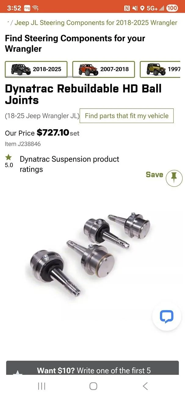

$730 in the 1st quick search I did. I see Northridge has them for $550 so that makes it closer. I've also seen people on 37s get 50k out of the stock ball joints so it's definitely a crap shoot there. The break even point would still be at the 3rd set of teraflex hd ball joints vs the dynatrac so I'm still confident most would be better served with that option over the life of the Jeep.
Jeep Wrangler JL The Ultimate Ball Joint Comparison!!! Screenshot_20250603_155239_Chrom
