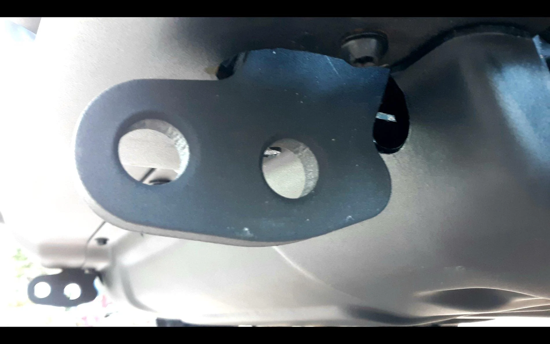

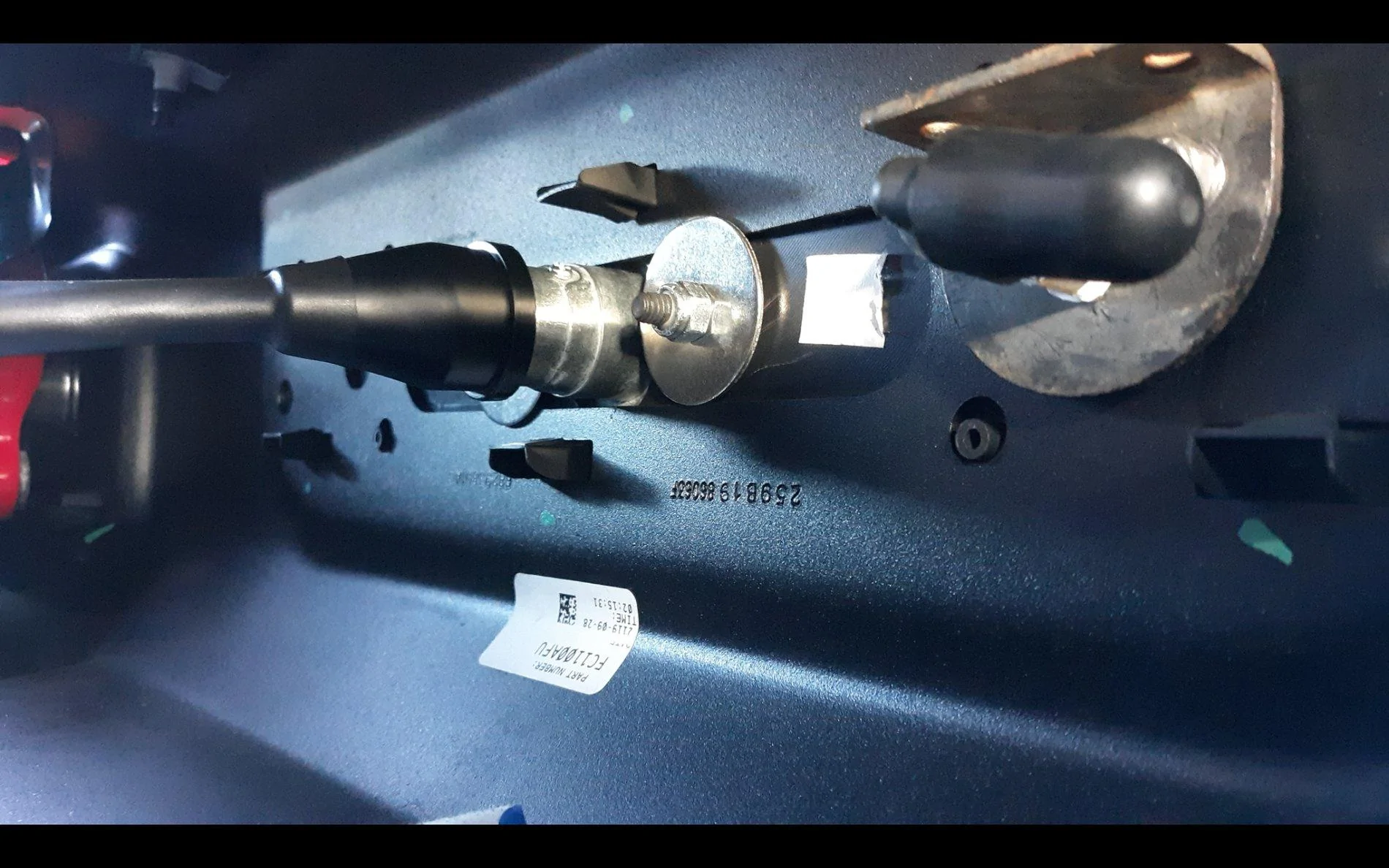

Did a bit more work toward getting set up as a toad. Last item on the list is installing the Air Force One brake system. Using the Maximus 3 tow loops and the Cooltech wire harness.

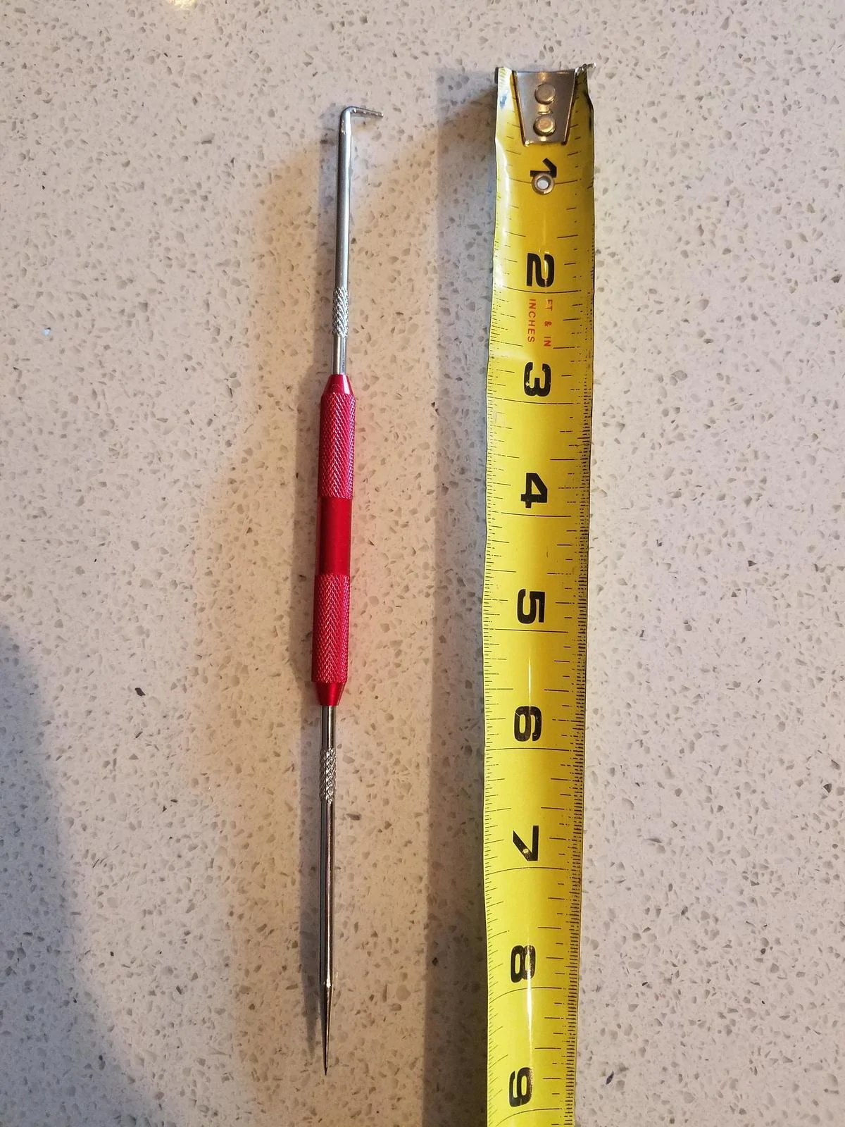

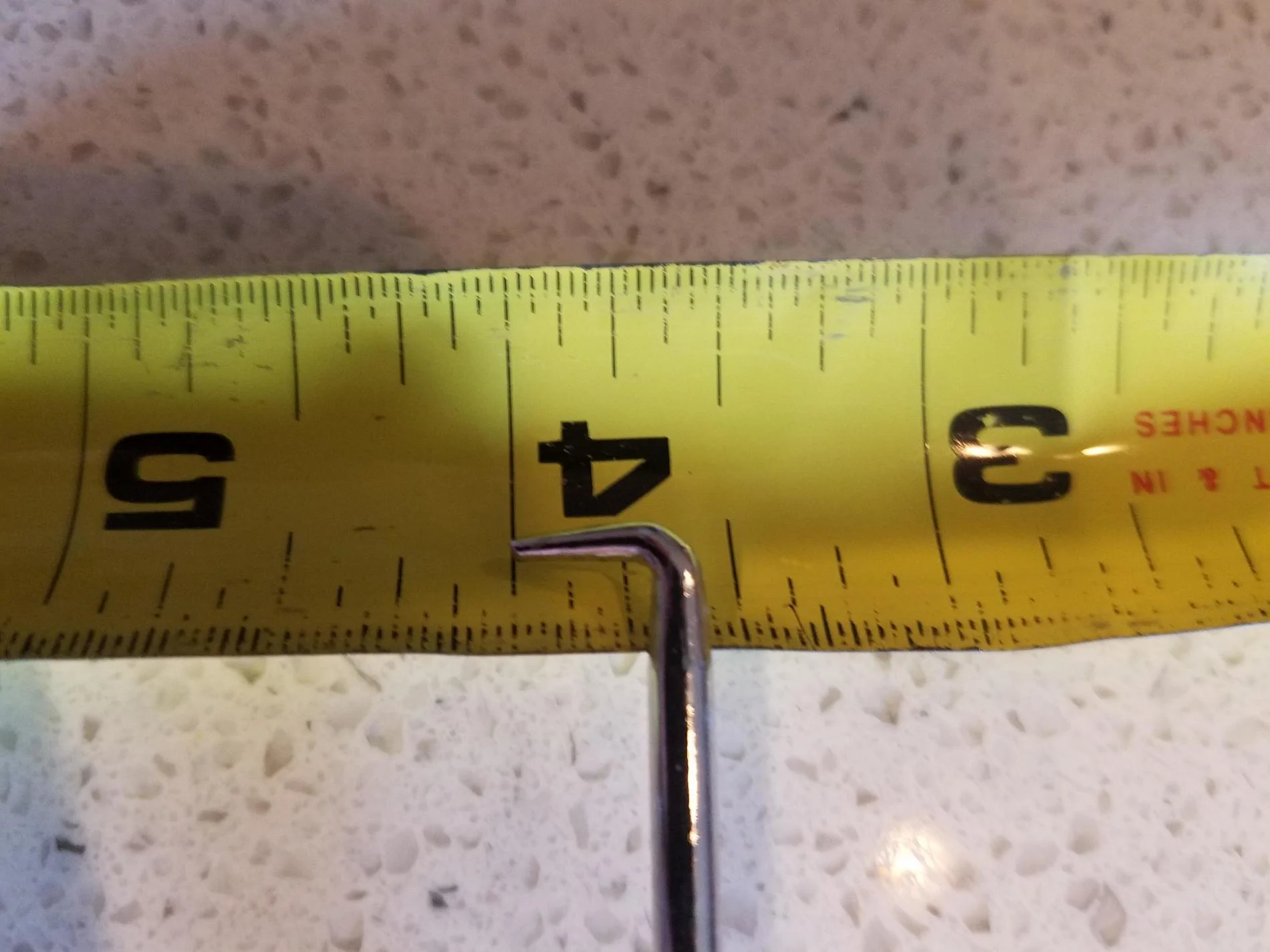

Here it is! I blunted the tip on this so that it wouldn't dig into the plastic clip, but instead would press it in. It is still hard, but this gets the job done. I bought it at Harbor Freight. I just used a hammer to tap the tip to blunt it.
