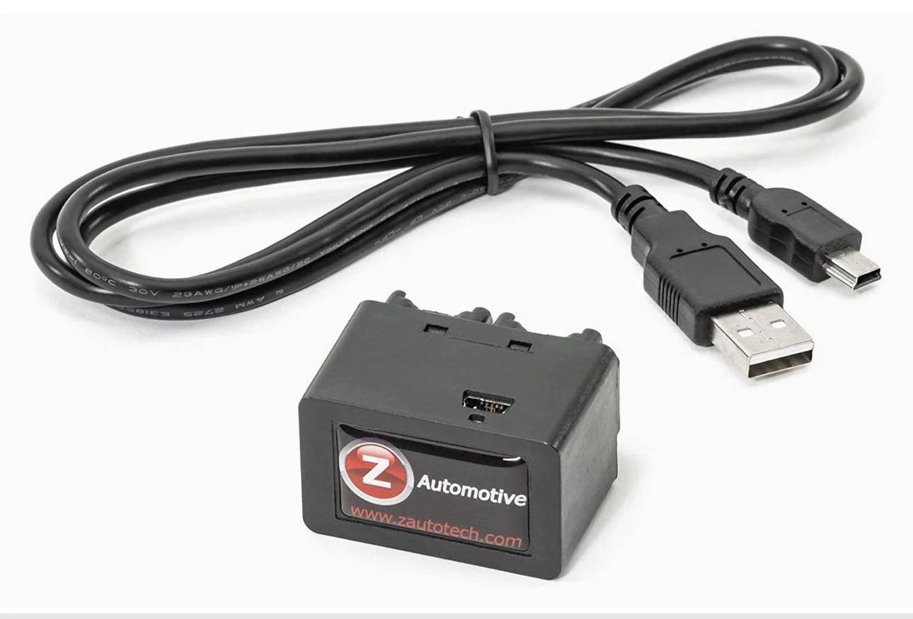

Does anyone know what kind of cable is sold with the Tazer mini? I misplaced mine but also want to buy a longer one. Thanks!

That cable is USB Type A (the flat rectangular end) to USB Type B Mini (the smaller narrower end).
Note that Mini and Micro are two different sizes.

make sure it is a data cable and not a charge only cable.

USB cable .... It is a generic “USB Mini-B” male that plugs into the female on the Tazer JL itself. The other end of the USB cable is a generic “USB A” male and that plugs into the female USB A on your computer.
