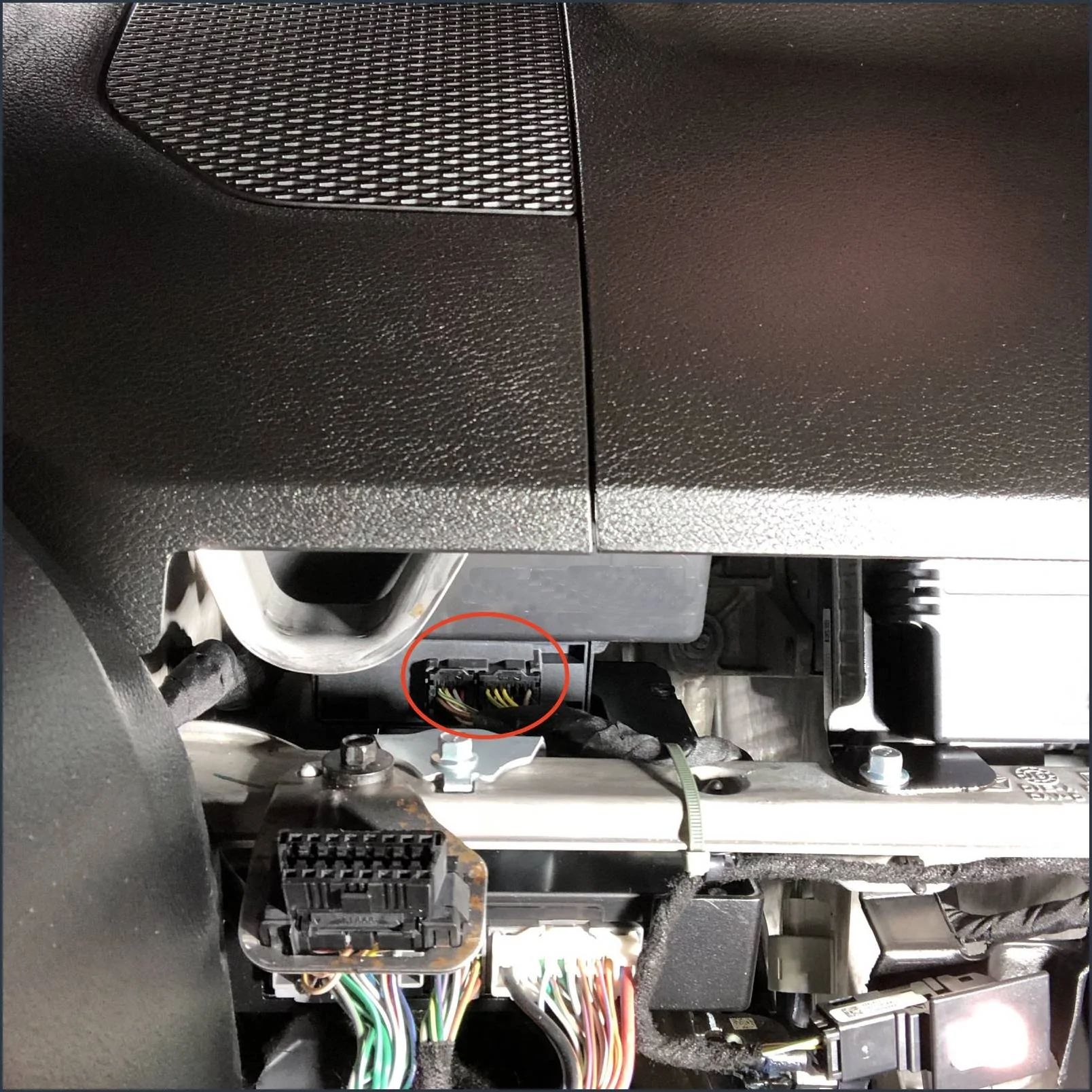

You are not accessing the connectors at the Security Gateway! You are incorrectly fooling with the Amp connectors that reside below the Security Gateway connectors that you use with the Tazer JL.
Don't feel bad as many other's have done this too...
You want the connectors circled in the red below!

I wish it were user error but this is my 4th Tazer on JL/JT's and so I'm somewhat familiar with them. The plugs you are referring to are correct and I have pulled them down and have the tazer plugged into them as I have done with all of our Jeeps. The good news is I figured it out. After further investigation with a Magnifying glass, it looks as though the Pin holes on the ends were a bit clogged with Plastic which leads me to think this could have been done during the manufacturing process. I used a fine needle to clean them out and the plug goes in like butter as expected. Everything is working as expected now and there are no bent pins. All is good in the jeep world again.

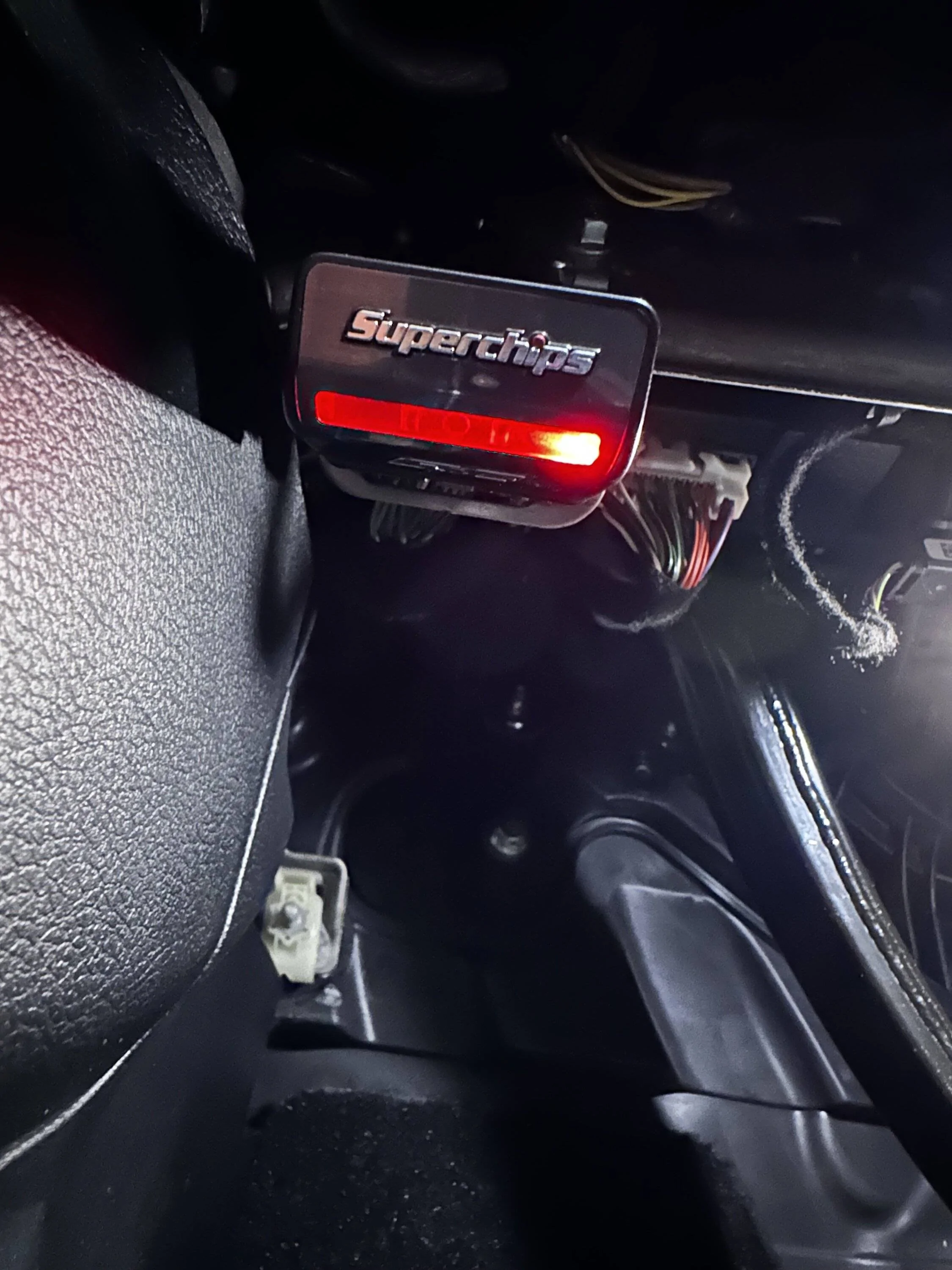

I just installed the extension cable for the Superchips module. Popping off the center panel below the steering wheel makes it much easier.
