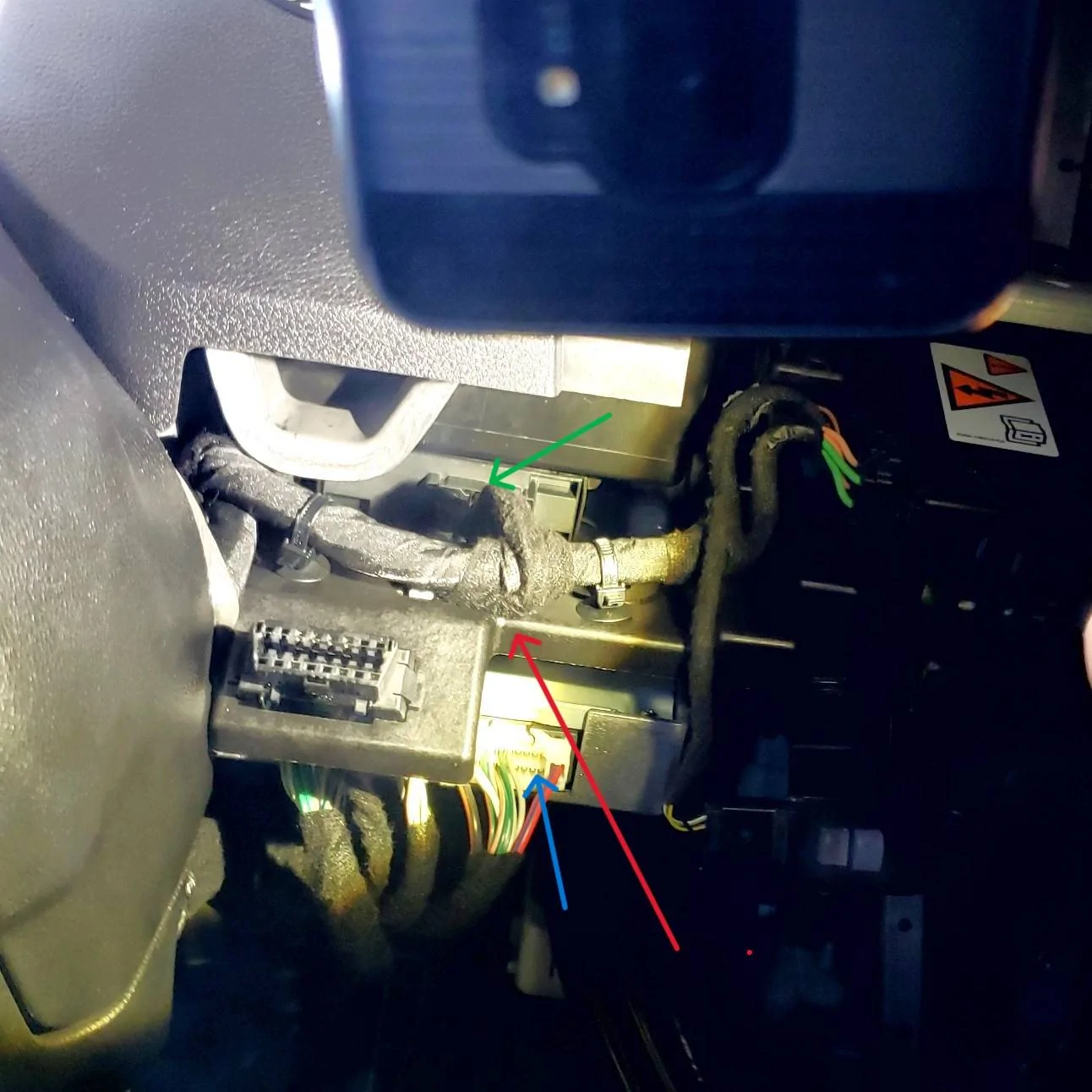

It's doable on a 2024 Rubicon-X, but not easy. There is enough room to get some fingers of one hand up in there, and a small opening behind that black bar to get a screwdriver up there to hold the tabs with one hand holding the screwdriver pushing the tabs as far as they go and use the fingers up in there to pull straight down on the wires - gently, you don't want to pull the wires out of the molex connector. Being a contortionist helps, so does a headlamp. Biggest issue I had was the screwdriver slipping off the tabs. I found that a thin blade screwdriver about 8-10 inches long worked best for me. Guarantee, after you do it once, you won't want to do it again, especially with that new for 2024 black bar in place which older model years don't have. Older model years without the alpine premium sound system amp are easy in comparison. Arrows in pic point to the new black bar, the location of the SGW connectors, and the alpine premium system amp. Get the extension cord so you easily unmarry and disconnect the tazer for dealer visits.

I struggled with mine for about 20 minutes and then asked a young kid to try. He had it installed in about 15 seconds ! lol
