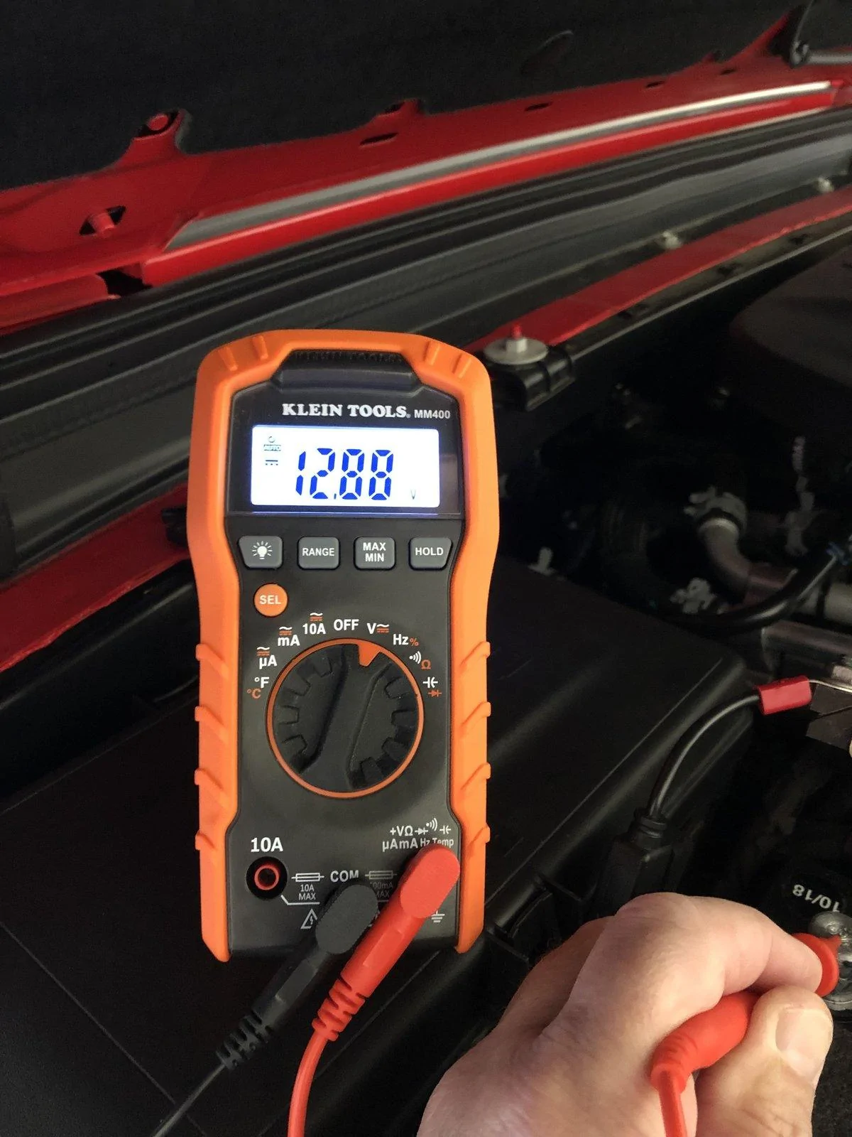

I just used the tender to bring it back to a full charge to start my testing like I first did to keep things equal, so the first test was Tazer married but not plugged in but this time around it’s going to be plugged in, I’m sure if it starts to pull the voltage down and force it to charge at a higher rate I will see it as I have been watching my voltage daily

Just pulled my resting voltages and running EVIC voltage and like before they have dropped after being off the tender, these are slightly higher than my first readings at the beginning of this test and I’m sure my readings tomorrow morning will be slightly lower
12.83 Main
12.83 N1
12.84 N2
12.7 EVIC
12.81 ESS

Day 2
12.66 Main
12.67 N1
12.67 N2
13.0 EVIC on startup
12.67 ESS
Also tested remote start a few times and worked as designed, don’t have proximity entry so can’t test want I don’t have.
Today was as I’m hopeing it continues to be with the Tazer plugged in and using live features, well actually just one live feature and that is ESS disabled.
Rolling voltage approx 12.6-12.8 and ramps to over 14 when slowing down, ESS disengaged automatically on startup as designed, did test ESS for a few stops by pushing button to let it do its thing and engine shut off after stopping and powered what was on and upon restart ESS disengaged again as designed
So as I said today was as it should be but I am just staring to test with Tazer plugged in so we can only hope that voltages remain close to what they are with no Tazer plugged in.

You can get a cheapie meter at like Harbor Freight but I chose to get one that cost alittle more, I purchased a Klein MM400 digital meter from Amazon and it’s perfect and will read two digits past the decimal so you will get an exact voltage
