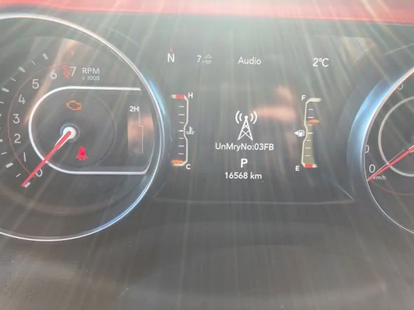

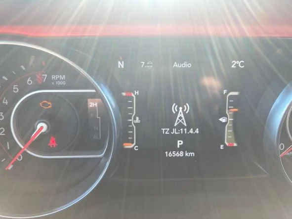

Thanks. I could get to the SGW easy enough, and I'm aware the USB on the Taser is for updating....
The issue can be seen in the attached image.

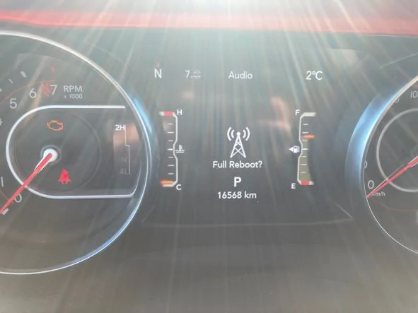

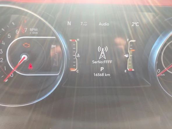

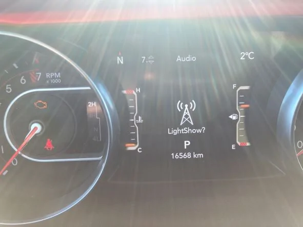

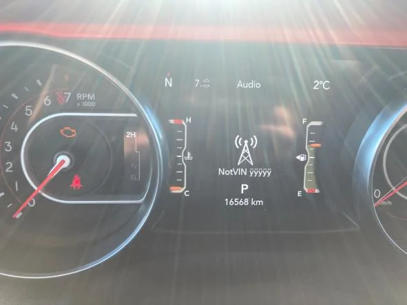

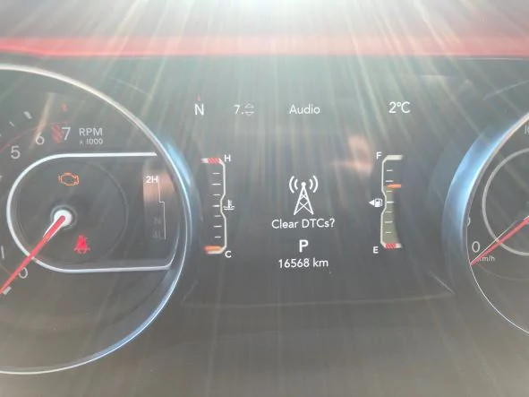

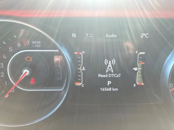

That is the issue "Marry" doesn't show up in the settings menu either, only the attached images of each screen. Sorry about the image quality, I had turned the Jeep to the South so I could see the screen of my phone...
Where did you get your Tazer from? Looks like it was previously married to another vehicle, and never unmarried. ZAuto can give you a code to unmarry it, for a fee.

The one potential boo-boo you might be making that I can think of is that the ignition needs to be on the "ON" position, but the jeep NOT actually started and running?
Although in your photos, the "check engine" light is on and tachometer is reading zero, so I suspect this is not the case.
Ah! This is the problem. Your Tazer is incorrectly married, and needs an UnMarry key. Check page 14 of the manual:
If you receive a Tazer second-hand, or lose access to your vehicle without unmarrying your Tazer and receive the “Not VIN XXXX” error:
....(further instructions follow)...

Just a follow-up to my issue. Scott from Z Automotive was prompt in responding to my correspondence via e-mail. He sent a un-marry code and detailed instructions early this morning (big time-zone difference between where he is and where I am). While he didn't explain why my Taser arrived NIB previously married his goof-proof instructions got me up and running correctly.
