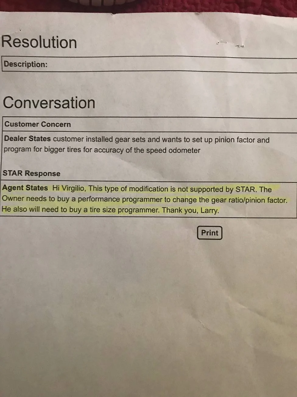

I change nothing, but not live. After getting “Service 4WD, Output Shaft Speed- Wheel Speed” after gears and tires. I took it to the dealer to recalibrate. ….. Their Resolution 👇
Jeep Wrangler JL Need Help with Taser B09C99B0-B306-449C-A039-0F22E50E7A34
Aftermarket Tazer programmer purchased
as instructed.
