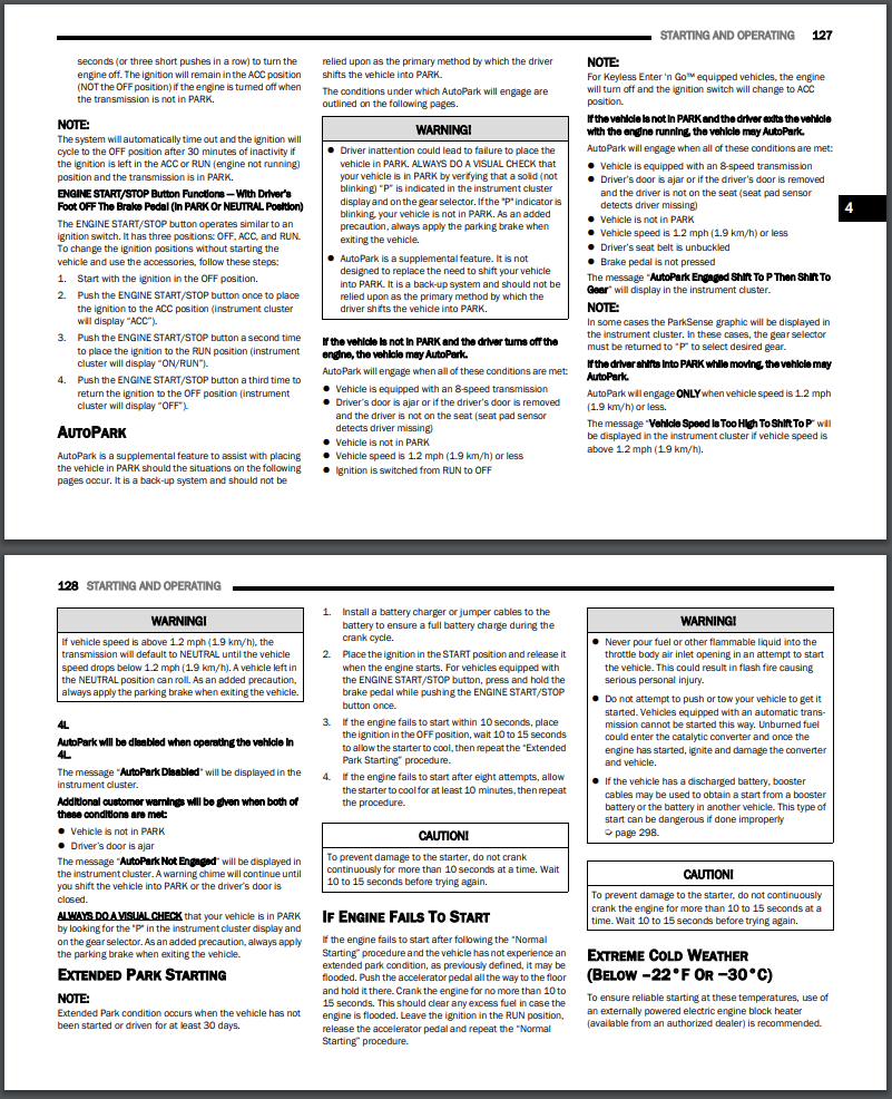

The primary reason I am thinking about it is the PIN code feature but there’s a few others that would be nice to have. Disabling the three honks when getting out of the Jeep while leaving the key in is one of them.
Disabling auto-stop is another one that I wouldn’t mind having as well….I don’t have a lot of stop and go traveling but I can’t see how it actually makes a difference in fuel savings.
What is auto park? Never mind….I figured it out. Yeah that’s an annoying feature that I would have no use for. I can’t remember the last time I opened the driver’s door to get out without putting it in park first.
