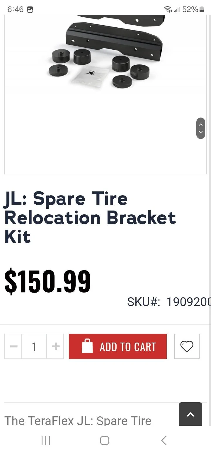

I bought the Teraflex adjustable mounting kit last night. Gives me the flexibility if I go bigger.
