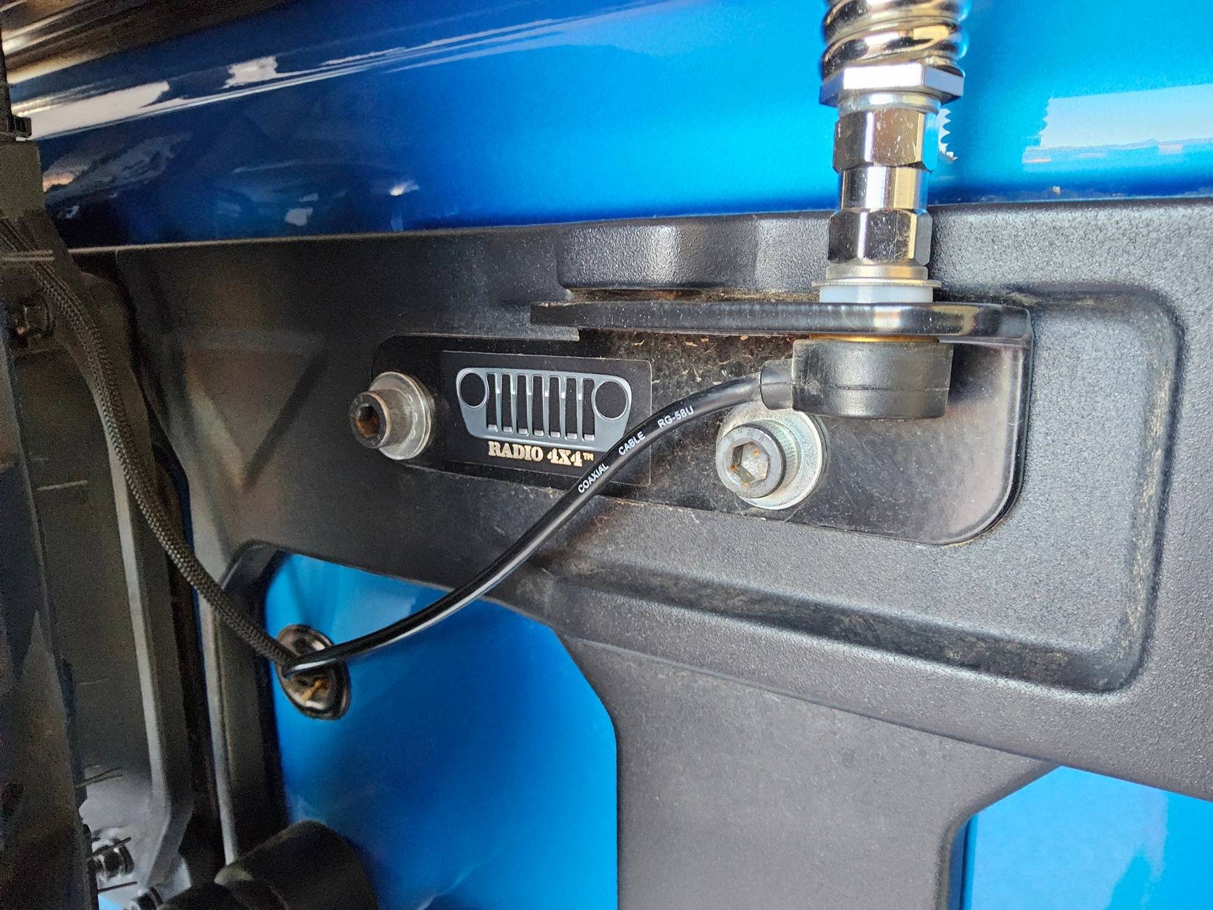

I want to install the TeraFlex antenna mount on the tailgate hinge. This requires removal of the T55 bolts and replacement with a bolt for the mount. I have been reading where there have be problems removing the T55 bolts. It looks like most of the issues stem from using the incorrect size or not fully seating the Torx bit. I have the correct bit (T55) and am going to remove all the extra paint on the bolt. Once I start to remove the bolt will I encounter a large amount of resistance? Anyone else have experience in removing the hinge bolts? I just want to make sure I don't break or strip the bolt.

Initially it will be a good amount of resistance, however keep even pressure and it will ā€˜pop’. Then it’s pretty much finger easy to remove them. Also you don’t need to remove any paint.

I just installed a mopar hd hinge and on my 2024 they came out easy but I have been doing this kind of thing for a long time. push hard on the ratchet to keep the torx bit fully engaged and start with a slow turn..

You just need to ensure the Torx bit is fully seated. A few taps of a hammer will help. After that, even pressure should get it to pop loose although it may take some effort. I used a breaker bar on mine and had no problems.

OK - Thanks! I will grab another cup of coffee and give it a try this afternoon...

OK - I was able to remove the bolts without any problem. I did have to use an extension on the ratchet to get one of the loose. TeraFlex mount and antenna installed...
Thanks all.
