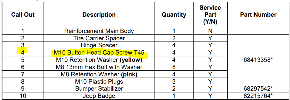

I'm looking for replacement bolts for the hinges on my JL. It has the Extreme Recon package with the tailgate reinforcement. I have searched far and wide with no results for just the replacement bolts. If it doesn't exist from MOPAR, does anyone know the size? I believe it's a M10, but not sure of the length or pitch.

Looks like you are right on M10:
Jeep Wrangler JL Extreme Recon Tailgate Bolt Replacement 1708615975091

Looks like the stock (non XR) one is P/N 06512276AA
I'm not seeing any thread/length specs anywhere though.

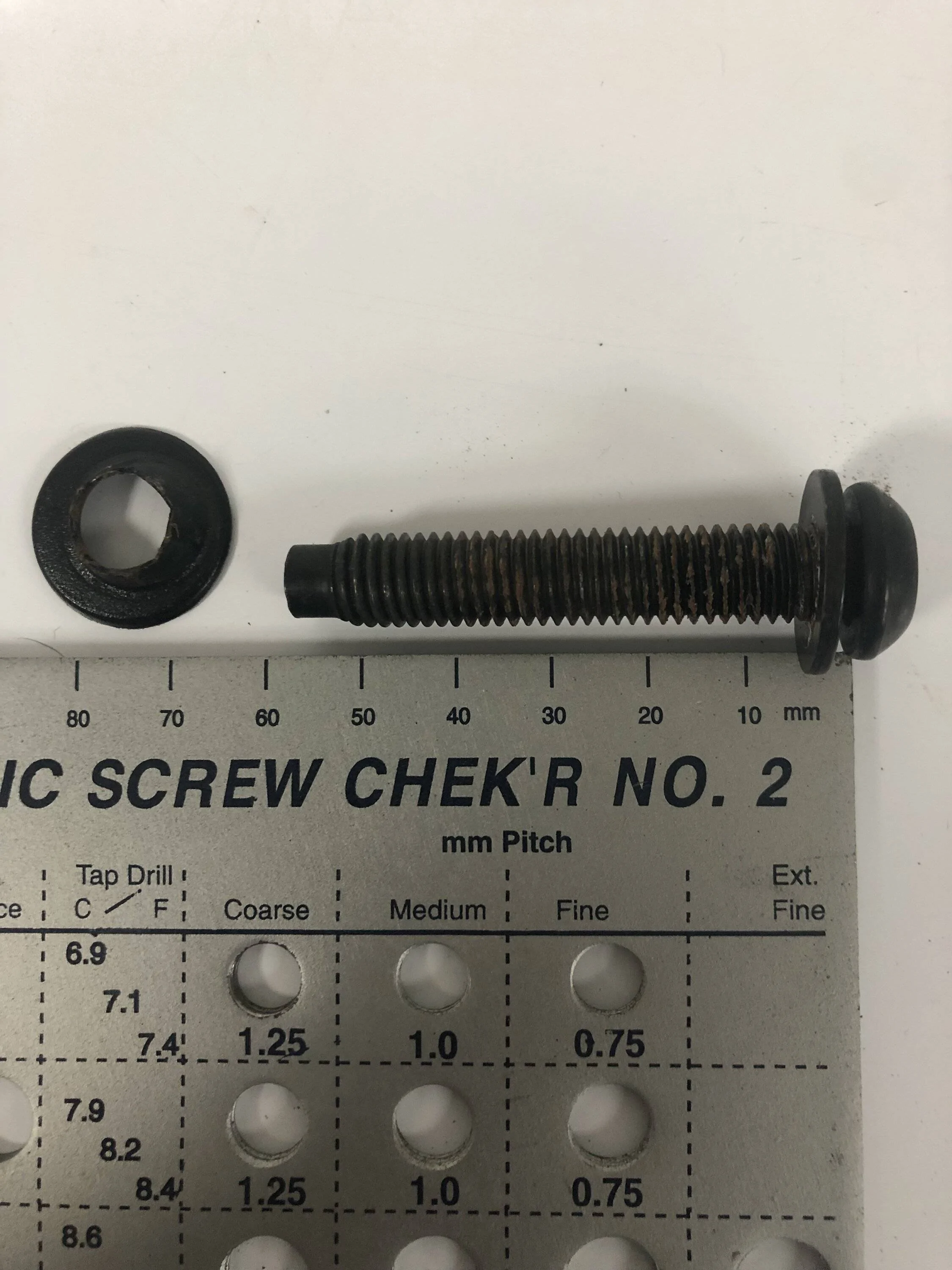

M10x1.5x55mm overall with the threaded portion being about 50mm in length. Use a T45 Torx bit. Maybe ask Benny in the @AllMoparParts.com forum section for the OEM part number.
Jeep Wrangler JL Extreme Recon Tailgate Bolt Replacement IMG_1881

Awesome! This is exactly what I’m looking for. Thank you. If I can’t find the OEM replacement at least I know the size now.
