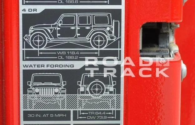

30" line is well above the exhaust, not an issue.

My issue is with Arterius2 saying you take 30 inches plus your lift size to get your fording depth. There is more to it than that. In general you're right... back into the water with your exhaust pipe the water doesn't add enough back pressure to cause an issue for the engine. Now if you shut your engine off or if you're in a current that is directing water into your exhaust pipe or if you're backing with substantial speed, you may have issues.
Not to mention you need to divide the increased tire size by 2 (only half of the tire is below the center of the axle). So a 30 to 32 inch tire will only life the vehicle 1 inch.
