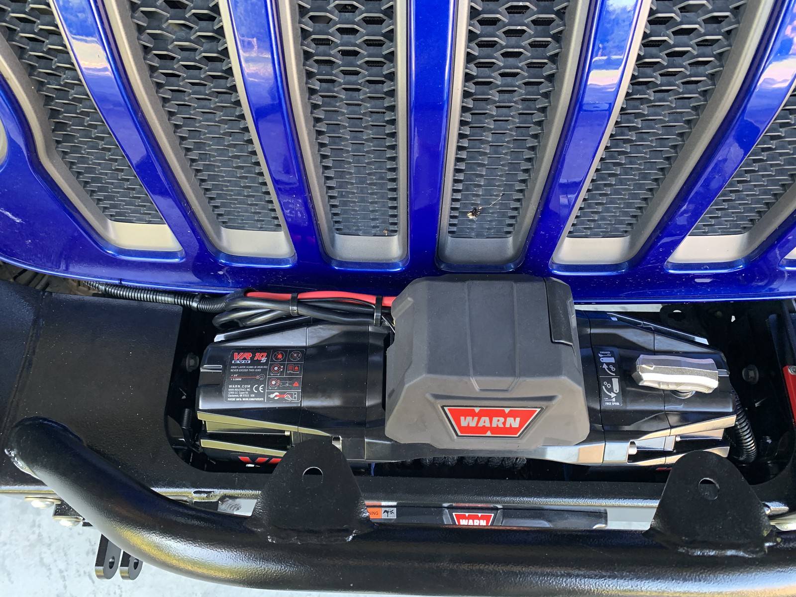

I bought a Warn VR EVO 10-S last July. I went with the Warn because of it's reputation and because they were offering 2 rebates.` The first rebate was a $100 pre-paid Visa card. That came in last month and I have already spent it. The second rebate was for $100 to spend in the Warn store. I specified that this money would be for the wireless conversion for my winch. That rebate has not yet been processed.
My other Jeep has a Badlands Apex 12,000 (Harbor Freight). I haven't used either winch enough to pass judgement of how strong or how durable they are. I have identified some pluses and minuses.
The Warn 10,000 pound winch has a significantly smaller footprint than the Badlands 12,000 pound winch.
Virtually every nut and bolt on the Warn winch was loose when it was unboxed.
The Badlands winch came with a wireless controller.
I changed the outlet of the cables to the control box from the back to the side on both winches. The Badlands was easier to do because the cover screws were located for easy access. The Warn screws are accessed from underneath and you may need to unspool some rope before you can loosen the screws.
The "engage/disengage" sticker on the Badlands winch peeled off after 8 months.

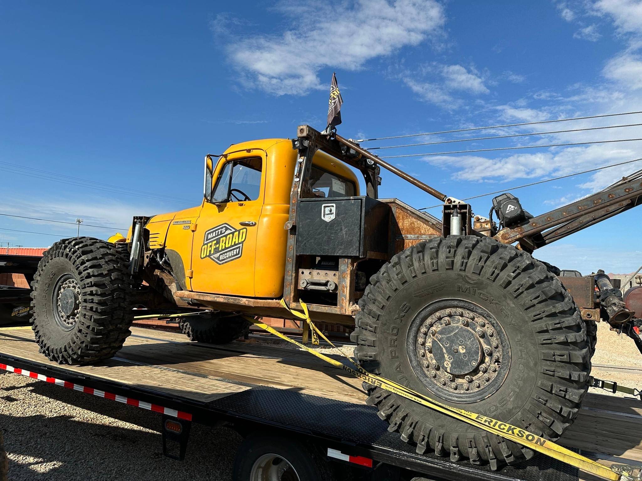

FWIW, Matt's Off-Road uses a Badlands winch on their big wrecker. Matt likes it a lot. I wouldn't change for the brand name.

Matt uses the HF winch because he's sponsored by HF. But for the money, the Badlands winch is a great value. Several folks in my club have them and use them frequently.
Matt's got a great show but it's all show and drama. He uses kinetic recovery 95% of the time when a winch is safer/better, but there's no drama in most winching. Matt is an expert at recovery but he's also an expert at getting clicks and followers.

I disagree with how you characterize Matt’s show. They’ve recovered some vehicles from some very gnarly spots. I watched one today where they recovered a SxS that had run off the side of a mountain. It was an all day winch job.
I visited Matt’s shop in September. It was different than I expected. I thought I’d find a wrecker service making a little money doing YouTube. Instead I found a movie business making money doing wrecker work. Still, the wrecker work is real. There are no penalties for easy recoveries.
