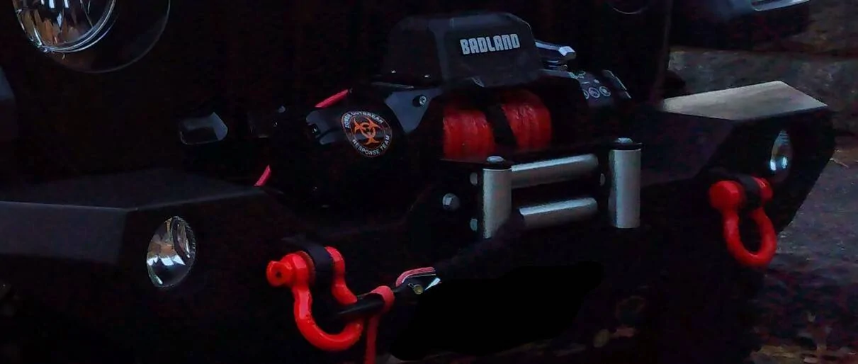

I can't speak for Warn but mine accepted more rope, it came with 65' of steel cable, I put on 100' of synthetic rope no problem.
This is my winch: 9500 lb. Truck/SUV Winch with Wire Rope (harborfreight.com)
This is the synthetic rope I used: Amazon.com: XPV 3/8" x 100ft Synthetic Winch Rope 23,809lbs Dyneema Winch Line Cable Rope with Hook and Sleeve Protection Red : Automotive
