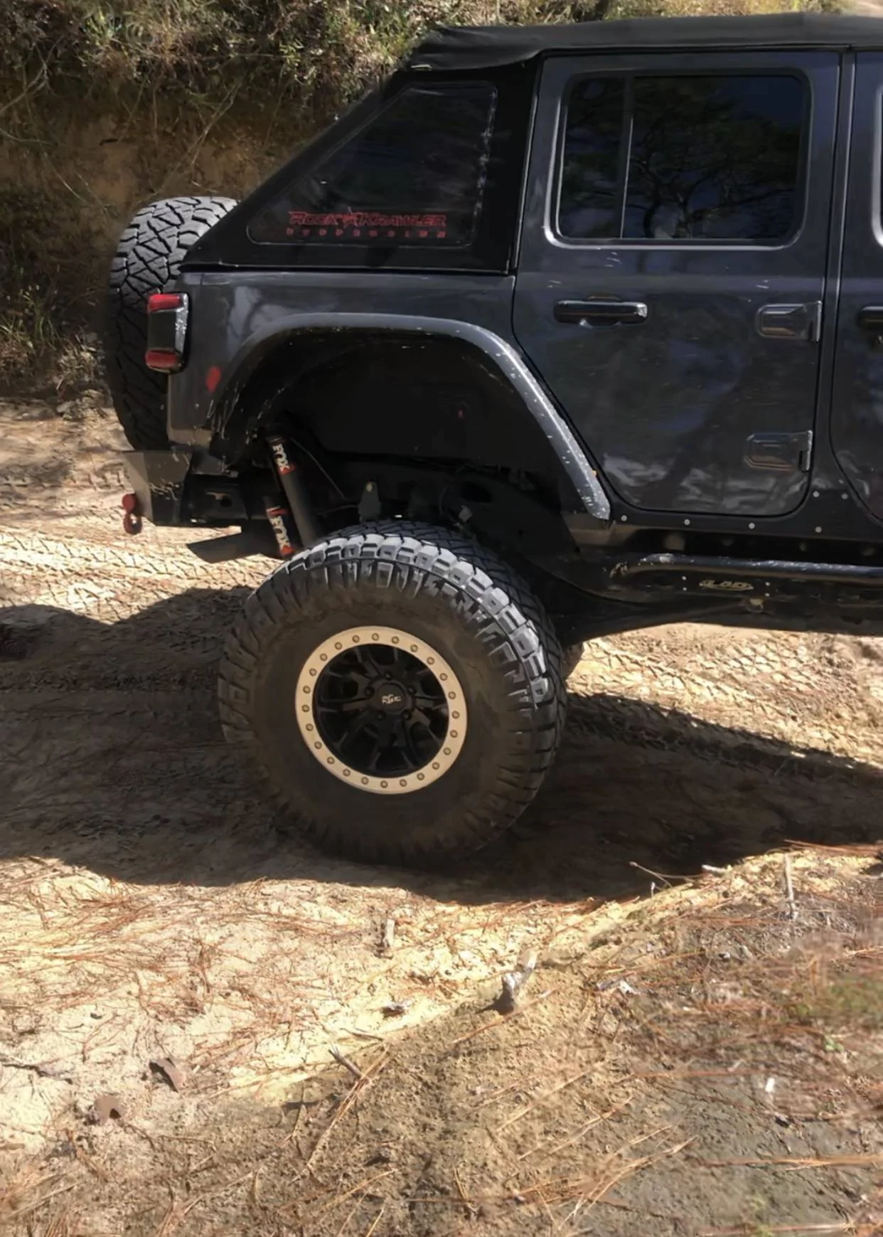

That's some serious lift! What size tires are you thinking about going with bro 40's ?
It is quite large of a lift , but im pretty happy with it so far! I bought raceline beedlocks 17x9 and am going to start with bias super swampers 35s .

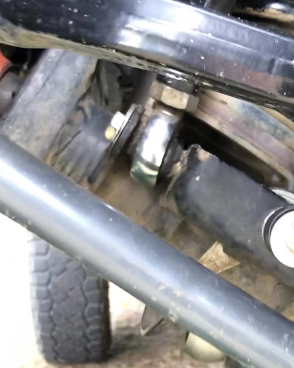

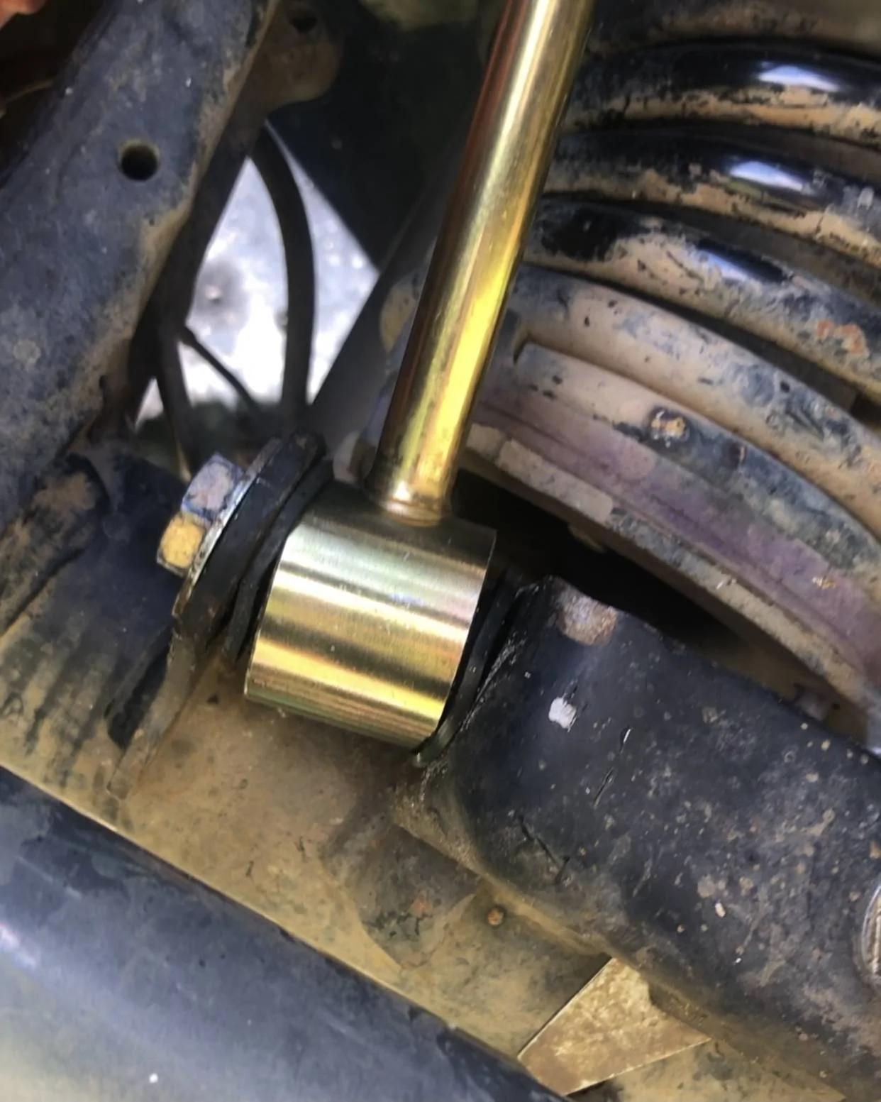

This is actually a great option… if you get some dbl heim sway bar links like RK or Icon, then there’s no difference in articulation from connected to disconnected, despite the myth…… I did a study myself and there was virtually no difference……even if you use the MC links, (oem style) because of their length, there’s still no restriction in articulation. I just don’t like the way the bushing gets in a bind in extreme articulation…obligatory pics….
Jeep Wrangler JL Sway bars - keep or remove? 8F1E6480-E3CF-4F3D-ACAE-C757F96F6F55
Jeep Wrangler JL Sway bars - keep or remove? 10FA9C76-9916-4E3C-AC76-8FDF254CC54C
hooked
Jeep Wrangler JL Sway bars - keep or remove? 99B394F5-6951-4CE1-9550-CF24DC288994
Unhooked
Jeep Wrangler JL Sway bars - keep or remove? AB4C1F83-698B-4F29-AE95-A3224C31AD2F
After I did this I did lengthen my links as I didn’t like how straight they were getting, don’t need inversion, makes for a bad day, lol…..
