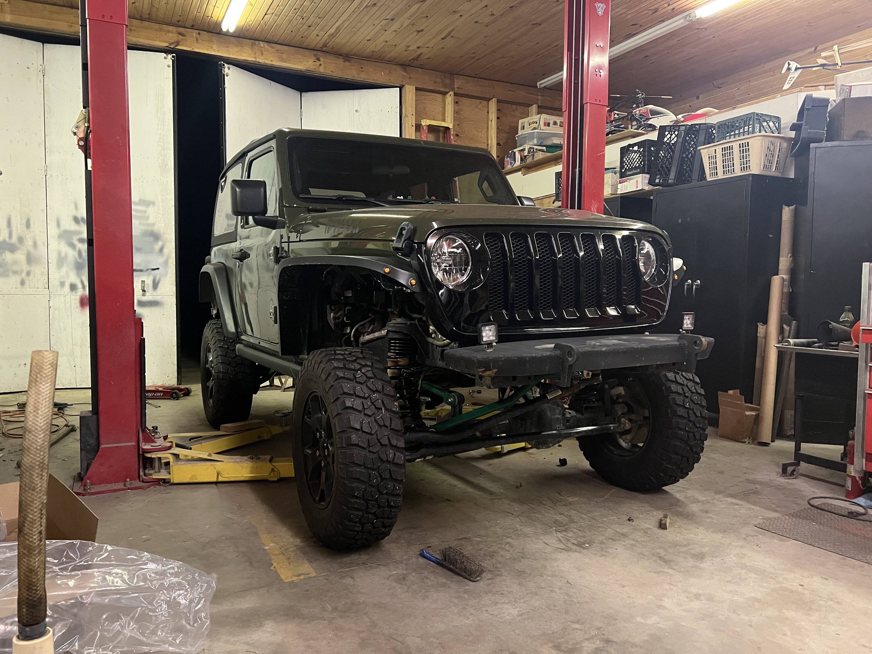

So i just installed a 4 inch lift , and wanted to hear everyones opinion of who has removed there sway bars or kept them? The rear one is gone don’t need it ( My opinion) but the front one im going back and forth on.

It depends on the type of wheeling you are doing .Now if your after articulation, no sway bars will not help. They are specifically made to show and hinder movement.

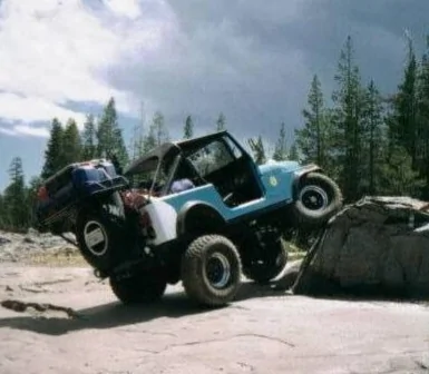

The FJ suspension is different so it's not necessarily a direct comparison, but here's an example of how a rear sway bar can actually (and counterintuitively) increase articulation:

Well I should have added the last part , my jeep is not a daily driver. And wont see alot of road driving, except to the trails. It will usually be towed or trailered.
If it's typically trailered to the trails and you're set on removing it, I'd just keep it disconnected and zip tied up and out of the way. That way if I ever needed to drive it on the roads(e.g. your main car breaks down), it's right there and can be connected in a few minutes.

There's this video for a Jeep that shows it pretty well, too.
Wow, 17" further with the rear sways connected. The sound of his bumpers getting chewed up when they were disconnected was a bit disturbing.
