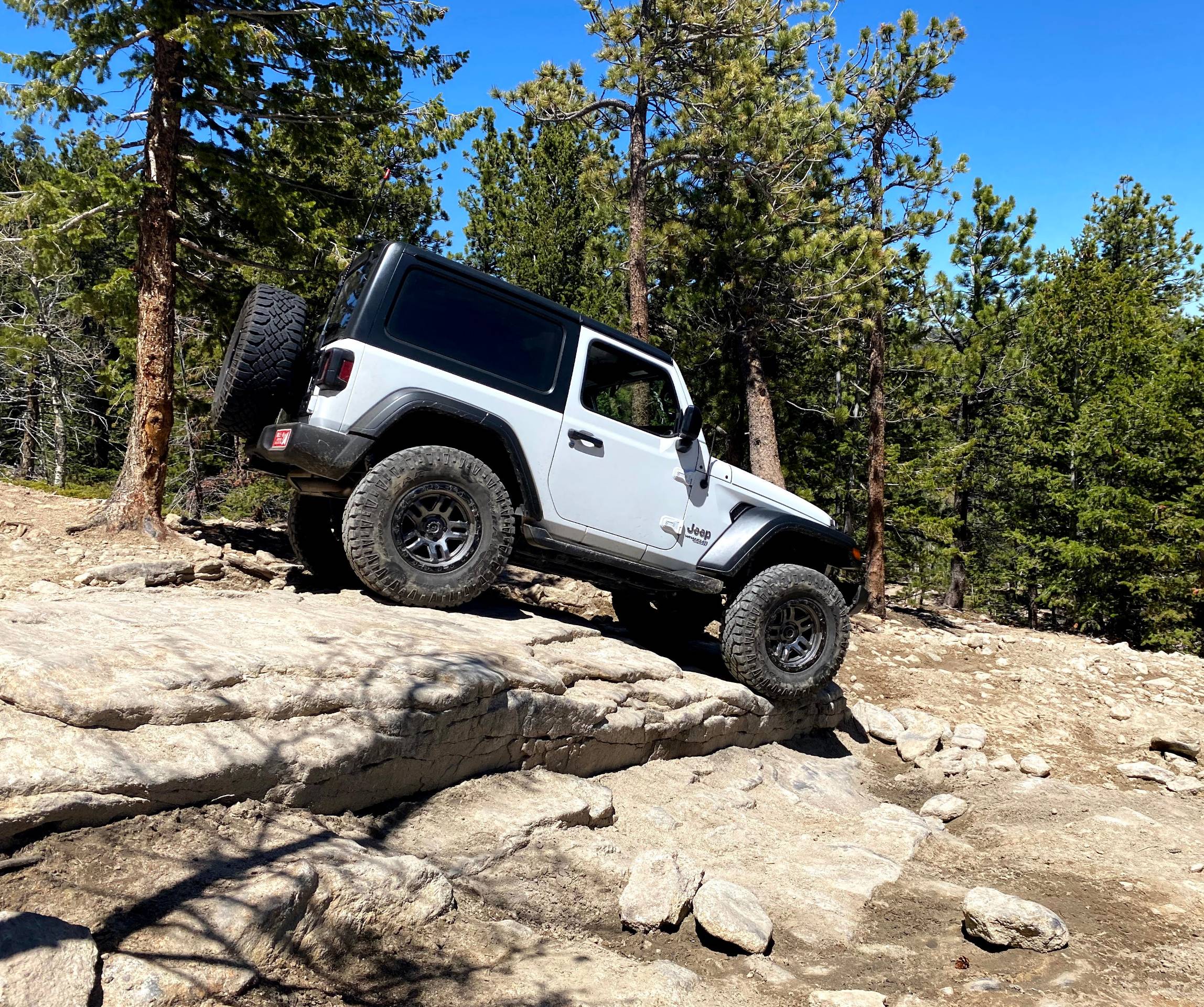

I've personally installed the Teraflex Sway Bar Quick Disconnect Kit on my 2019 2-door Sport S. I couldn't be any happier. I find that the 5 minutes to either disconnect or reconnect the sway bar links is really no big deal.
This kit has been just as important as the 2.5" lift and 35" tires I've installed. There's just about nowhere I wouldn't now take this JL. The additional articulation off-road certainly helps keep the front wheels firmly on the ground. Since my Sport does not have locking axles, the extra articulation greatly helps maintain traction even in the most challenging of trails. Other Jeepers are truly impressed that they see a Sport where typically only Rubicon's venture, here within my home state of Colorado.
So no matter which disconnection method you choose, you won't regret it. However, having a fully disconnected sway bar that won't automatically reconnect is something I really do appreciate. I like having the ultimate control of how exactly my Jeep behaves. I'd never intentionally travel anywhere off-road again with the sway bars connected. They are that amazingly good. I always now disconnect them as I'm airing down and typically will only reconnect them when airing back up.
Comparatively, the Teraflex kit uses a Cotter Pin approach which makes it extremely easy to disconnect or reconnect. Certainly not as easy as the Rubi's pushbutton, but nowhere near as difficult as wrenching the stock links on and off. Furthermore, the Teraflex kit has a bracket that keeps them firmly out of the way when disconnected. No tie wraps or any other kludgy mechanism to keep them secure when disconnected.
Furthermore, I also can't overstate how important it is to reconnect the sway bar links whenever you're back 'on-road' travelling faster than around 25mph. Rollover potential is a real possibility with disconnected sway bar links, especially at highway speeds. So some amount of discipline at using a manual disconnect mechanism is certainly a responsibility.
Regardless, tackling even the most severe terrain with so much more control is what I now experience. I would never again go off-road anywhere without it.
I'm pretty sure that you too will realize the same benefit.
Jay

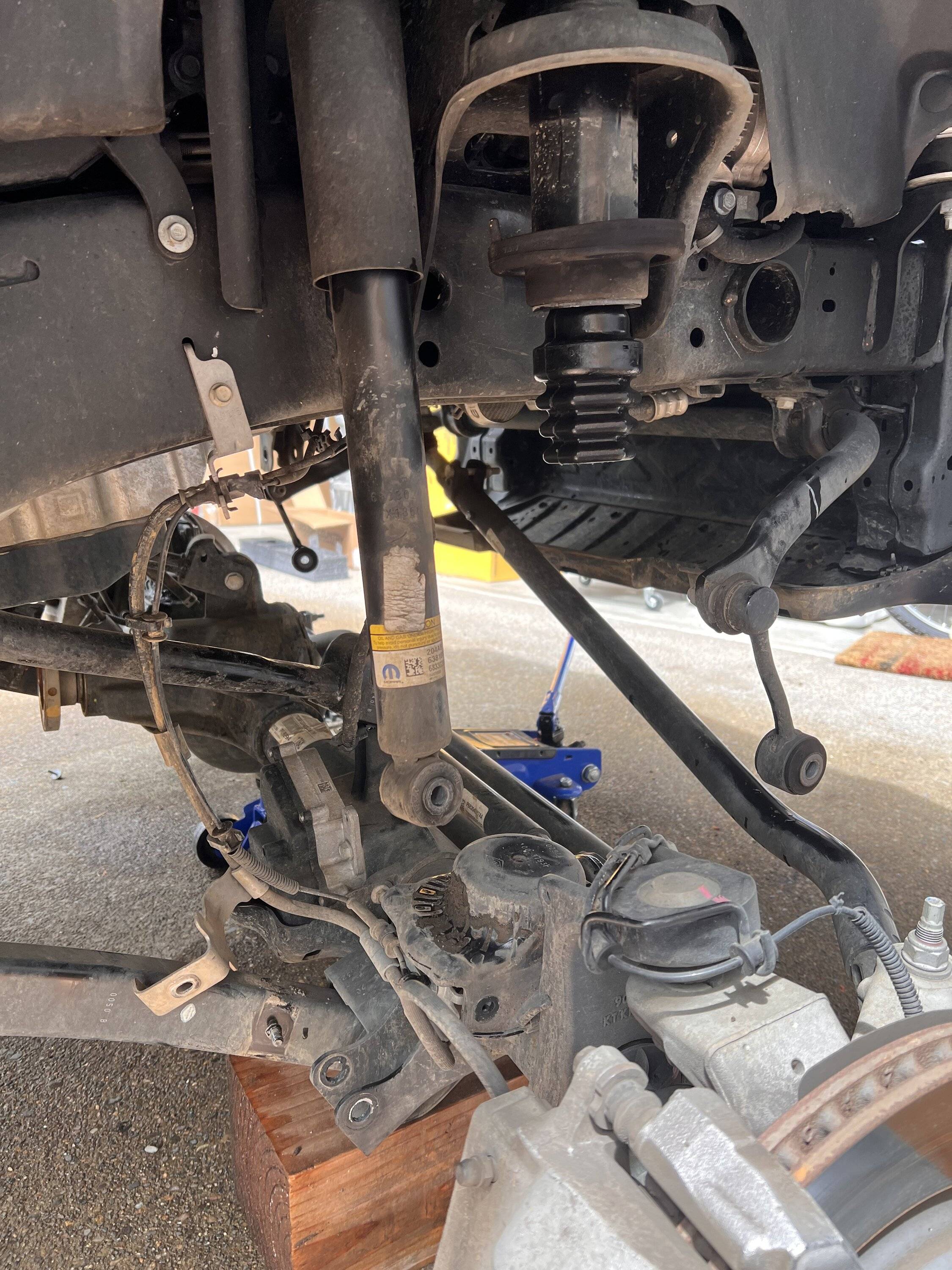

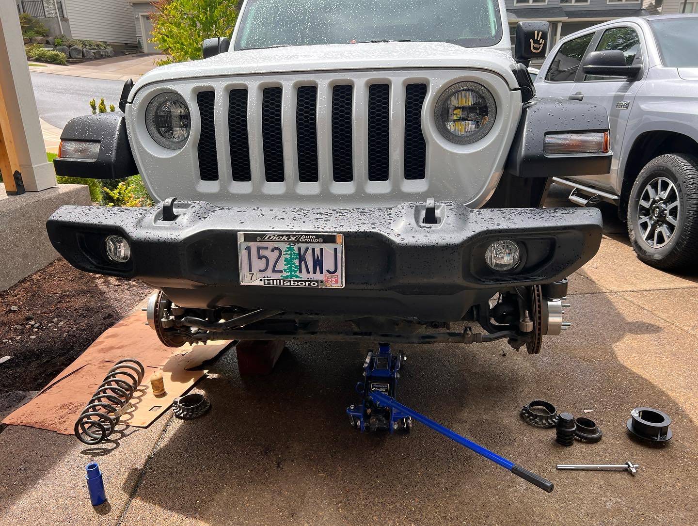

That blue loctite really does hold all the bolts on?
Jeep Wrangler JL Sway Bar disconnects B04ADA06-18FC-4B65-99F8-B790BBB509BD
Yes that is a block of wood the axle is sitting on so we could jack another spot up..
