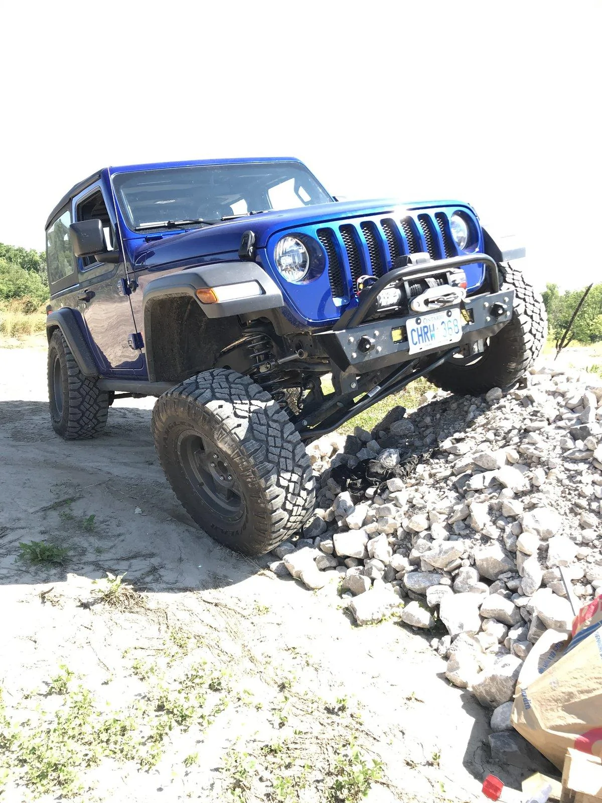

You’ll be fine. This is a 2dr sport with 2.5 aev lift.
Only thing you can do to help, is bend up the bracket on the lower control arm that holds the brake line down and it gives it more slack when it droops
Jeep Wrangler JL Sway bar disconnects 83D26619-B3C7-4D4E-AAD1-E42EE7BCCA0E
